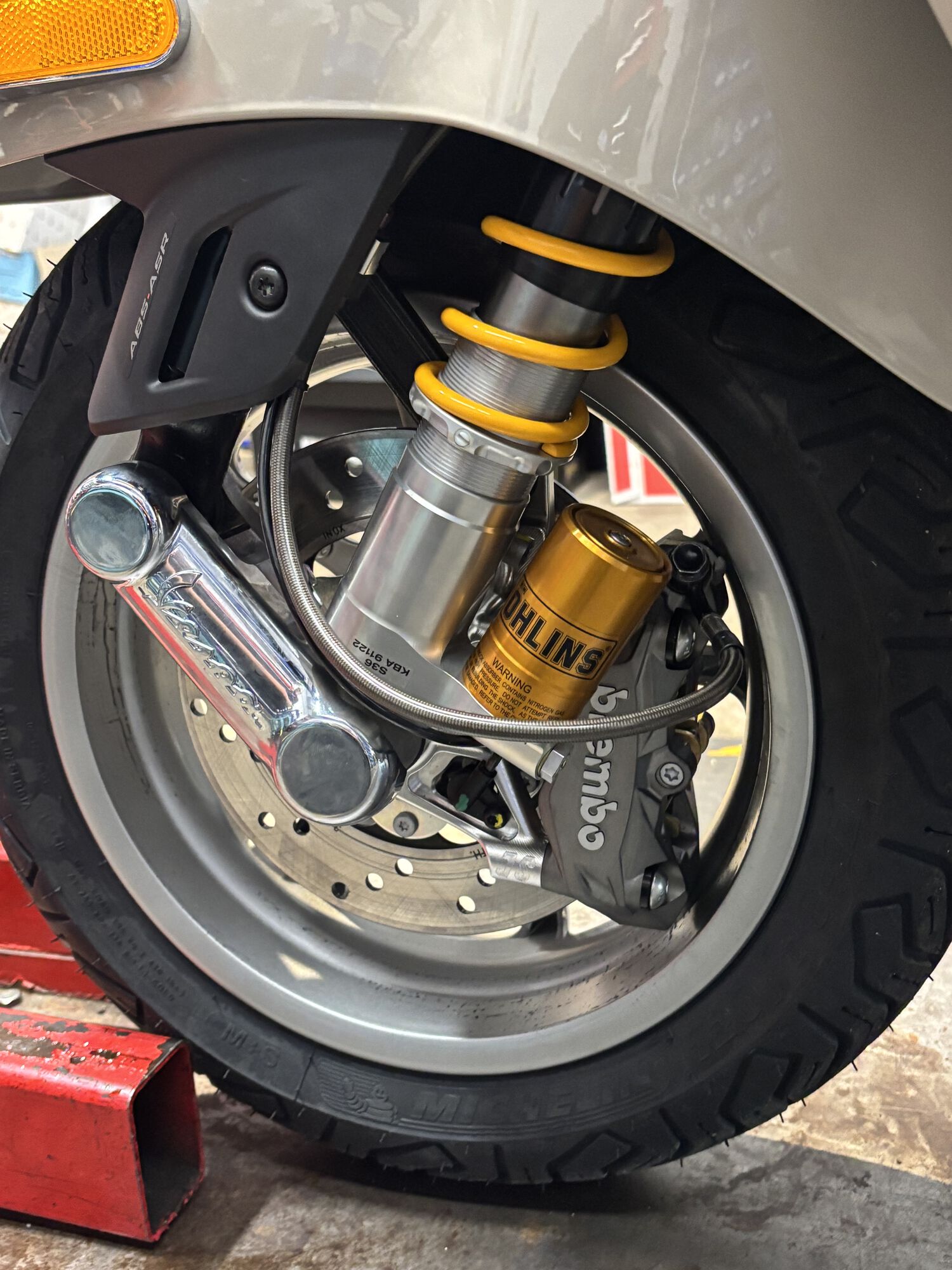

Took the plunge. About $1650 shipped. Cheapest vendor I could find. https://www.brooksuspension.co.uk/
Went with stealth black, gold version would have been about $100 cheaper.

What's in the box?
Included are preload adjusting tools and stainless hardware, both front and rear, front brake line relocation bracket, rear left side lower brackets for 150 and 300, spacer washers, and 2nd set of stiffer rear springs.
Front install:
Already had urethane bushings, these were straight swap, obviously factory bushings would work as well, but good time to upgrade.
Brake line needs to be rotated at caliper to clear the reservoir. Was able to loosen the bolt slightly, lost a couple drops of fluid, no bleeding required. Relocation bracket required with longer 6x20 bolt. Ohlins includes a new stainless bolt and washer but it doesn't look right, Vespa part number CM179302 restores the OE look.
ABS sensor wire clips can be rotated around the hydraulic line to clean up the routing, a little heat and leverage with an adjustable wrench does the trick.
Rear install:
Upper bushings again straight swap, need to reuse the nuts from stock shocks, so if you are already aftermarket will need to source source nuts or spacers if you don't have your stock shocks.
Shocks are marked left and right, but appear to be identical. Instructions detail lower spacer stack up, need to reuse factory spacers. Again if already aftermarket may need to source these. New CNC logo brackets are included for left side, but could reuse factory bracket if desired.
Tip: Do the right side first. I've done this twice now, trust me it's easier that way.

Rarely seen this much balance weights even in car.
First time seen those Öhlins on someones Vespa. Cheap tune up!

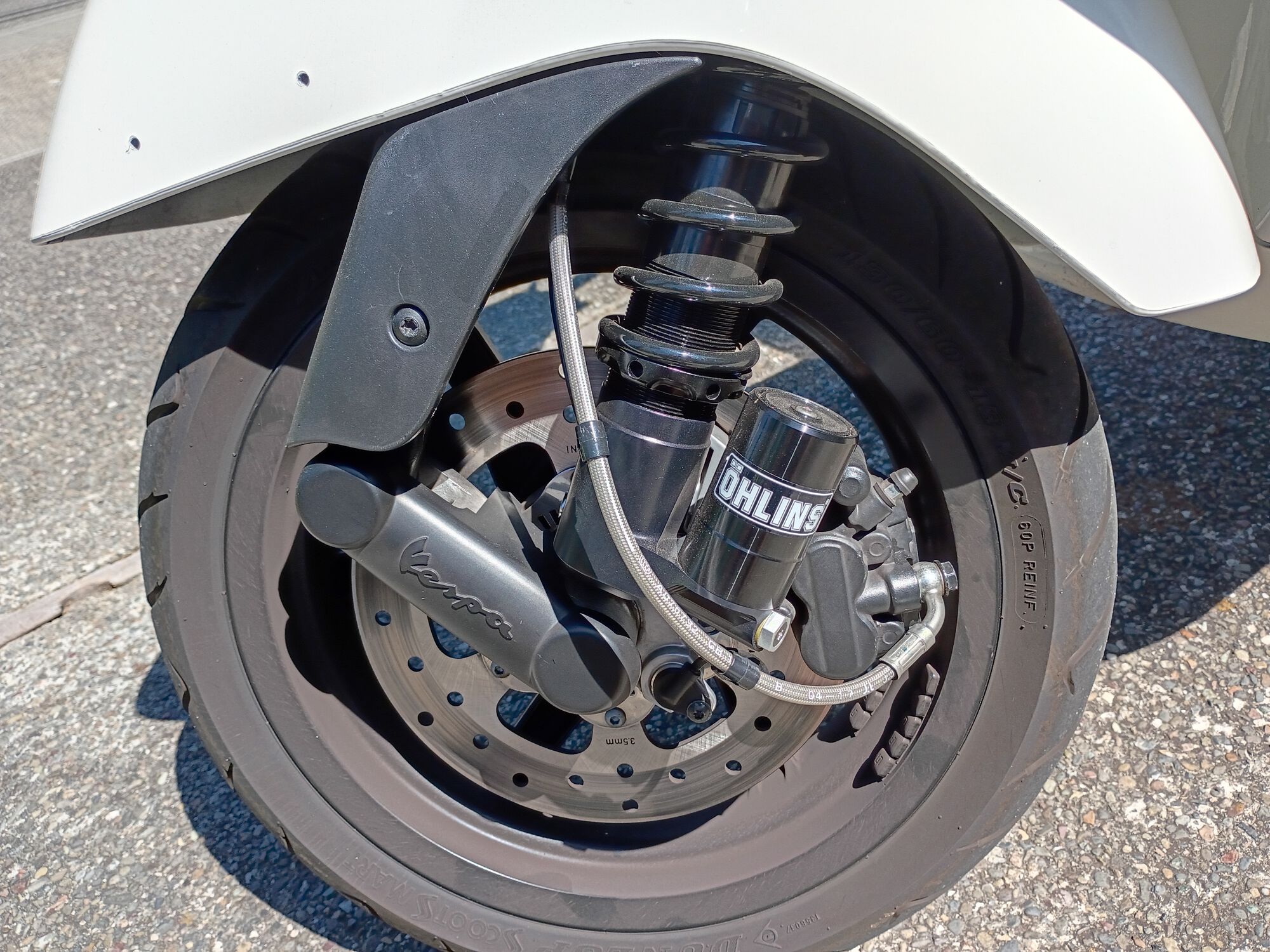

Installed this kit, along with Brembo caliper, on a customer's 2024 HPE. Straightforward, except that the customer wanted a Speigler brake line, for no reason except to make more work. And the Brembo hub was a pain to install correctly with stock washers etc.
The big disappointment is that there is no rebound or compression adjustment. For the money it should have at least the compression adjusting knob since the internals are pretty basic Ohlins plug and play.
Bluecloud, what are your impressions?
Can you still get lead wheel weights in Finland? They are illegal in the US. This is not uncommon with steel weights.
That said, think I will have the shop re check the balance.
