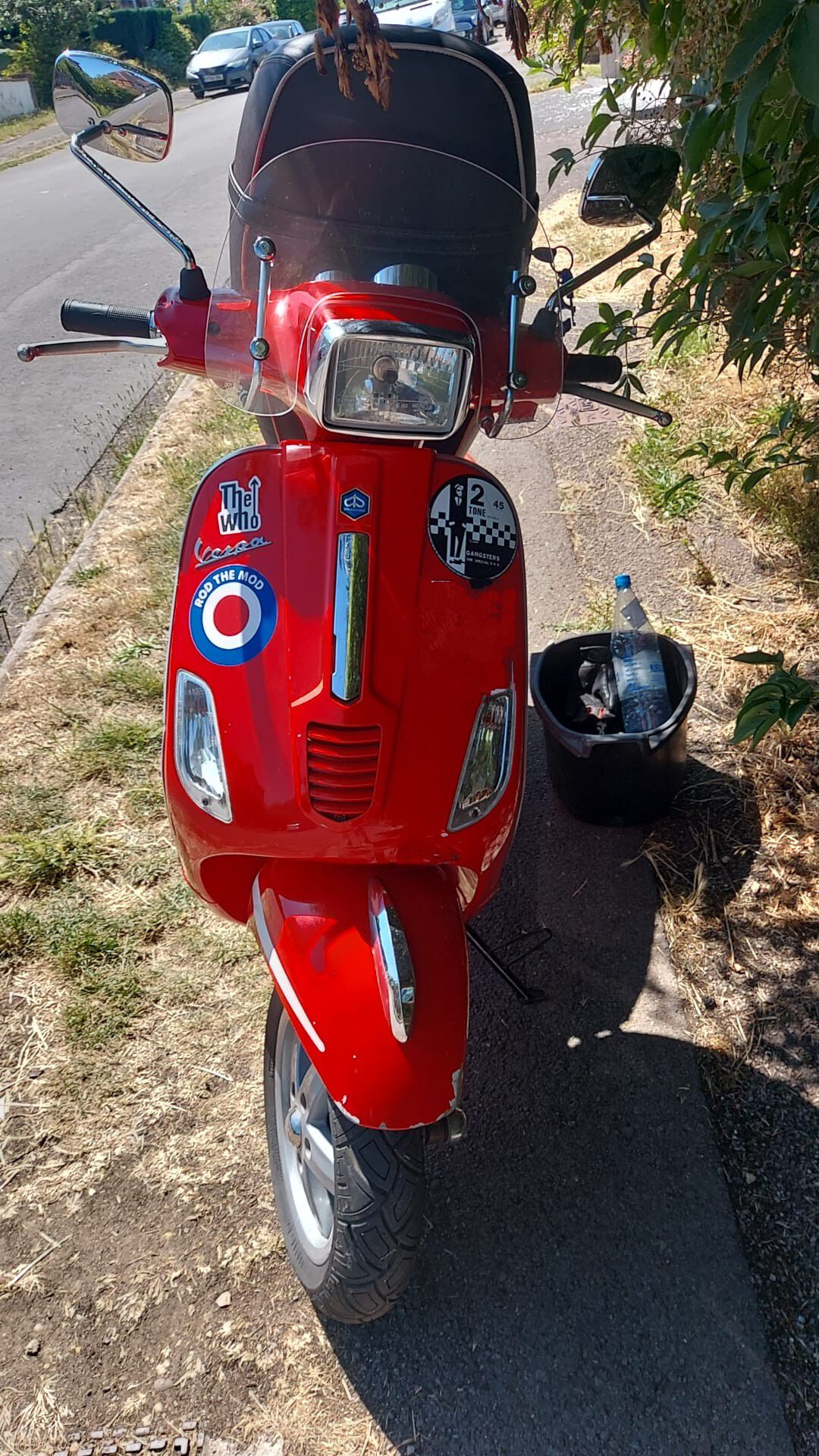

Hi I have trouble with my vespa I was driving on the road suddenly started to lose power on the throttle and then stopped. I took the scooter to a garage the said ignition system was tested fuel pump and fuel system tested and ok and they change the injector as they found it faulty ..on my way back to home after a 15 miles ride I stopped for a drink and then the scooter didn't want to start have to wait around 30 min to then the engine cold down and the engine start again so in resume after a 20 minutes the engine get hot and do not start some people say its the coil and other people told me maybe the exhaust any help please
