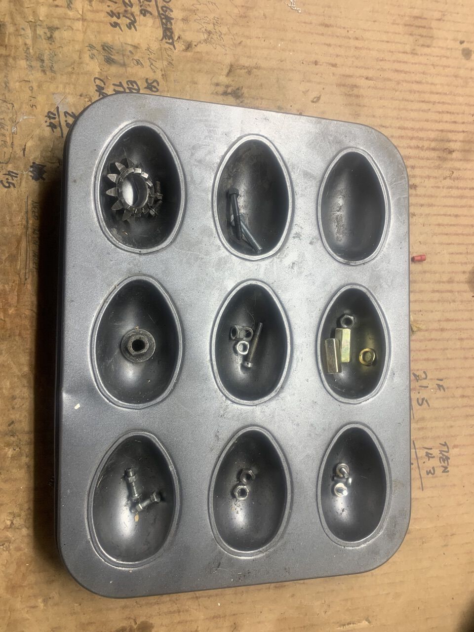

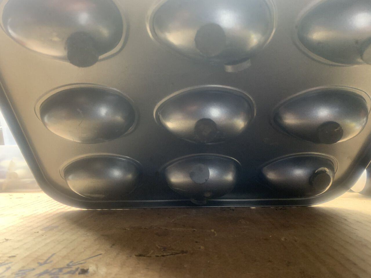

@socalguy avatar
bodgemaster
Posts: 7868
bodgemaster
@socalguy avatar
Posts: 7868
MJRally gave me this gift years ago for keeping little bits organized
metal muffin tray …
metal muffin tray …
… with magnets hot glued to bottom
