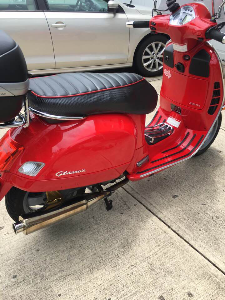

PM Tuning PM68 will do the job very well. It comes with it's own tuned length header and I've never had any issues with it. It was dyno tested during development to give a 1.5 hp increase. It's full stainless and very well made; I've had mine on 2 different GTS 250's for over 20K miles.
On the '21 Scooter Cannonball, it survived my very bad crash; then was transferred to another GTS after that rider had broken 2 header pipes with his Malossi exhaust - and he finished the event with no other exhaust issues.
It can get a bit noisy over time, but it's also easy to repack by drilling out the rivets on the can. Then use new pop rivets to secure. It's also much lighter than the OEM and requires zero maintenance or exhaust gaskets.
