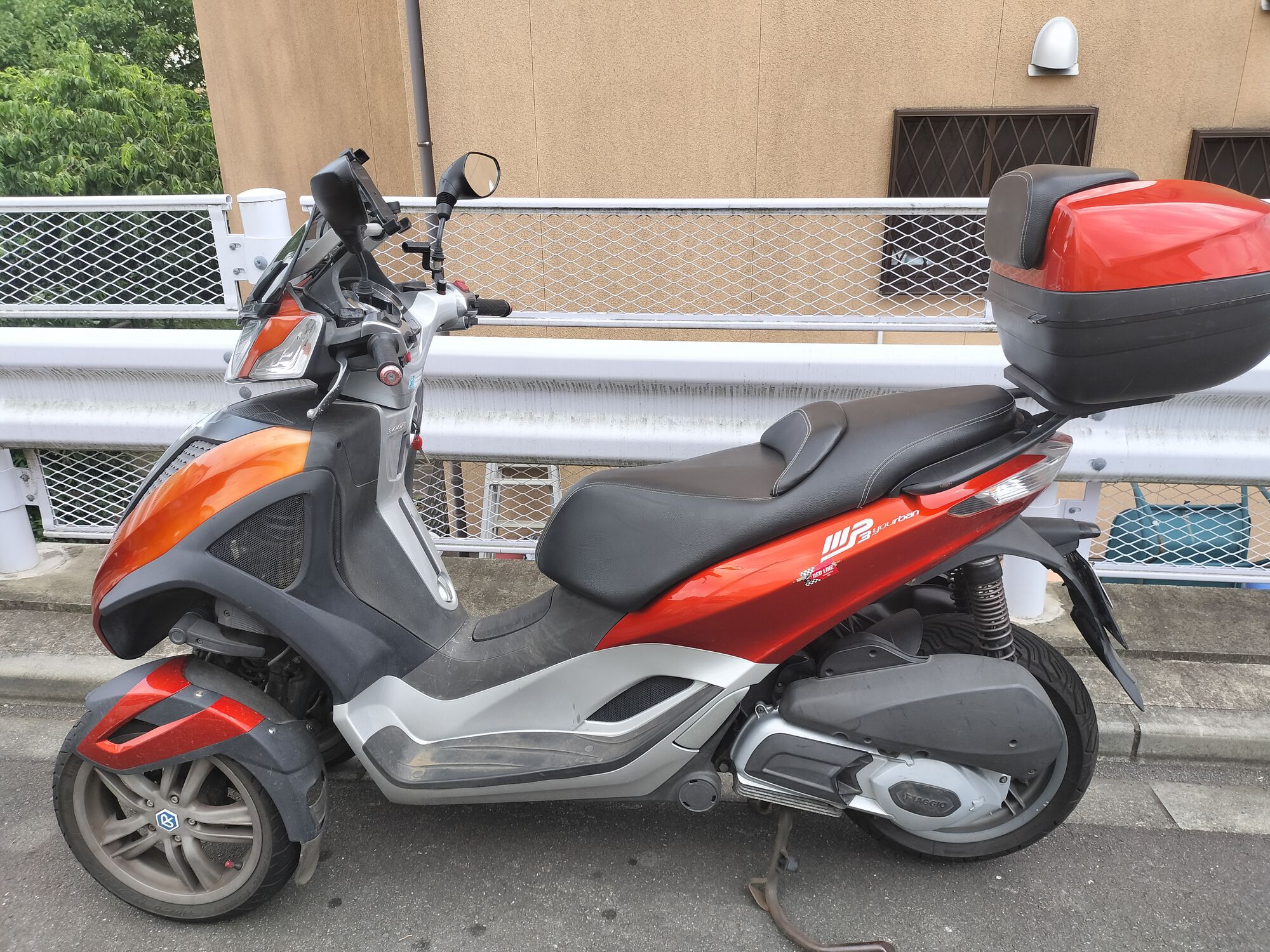

It only works at low speeds. It's like the seat sensor is working.
The throttle body is taken from a working model.
I replaced it but it didn't fix the problem. I replaced the master key and it worked fine.
I also borrowed a seat from a working car and replaced it. No change.
The roll lock is normal. O2 sensor replaced, water temperature sensor replaced, ECM cleaned, speed sensor is a used replacement and works fine. Injector replaced with a new one, ignition coil replaced with a new one, plug wire new, plug cap new.
If you open the throttle, you can reach 120km/h. It has power. It only misfires at low speeds and is out of order.

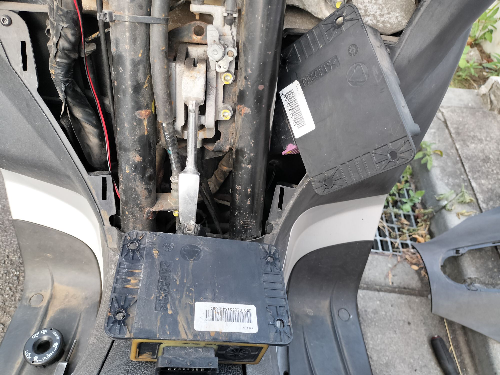

There is no secondary air and the engine starts and idles normally. The only problem is a misfire at low speeds.
For now, the idling is normal, the seat sensor is released with the center stand, and the engine runs smoothly when I turn the accelerator. So it's probably a sensor or wiring.

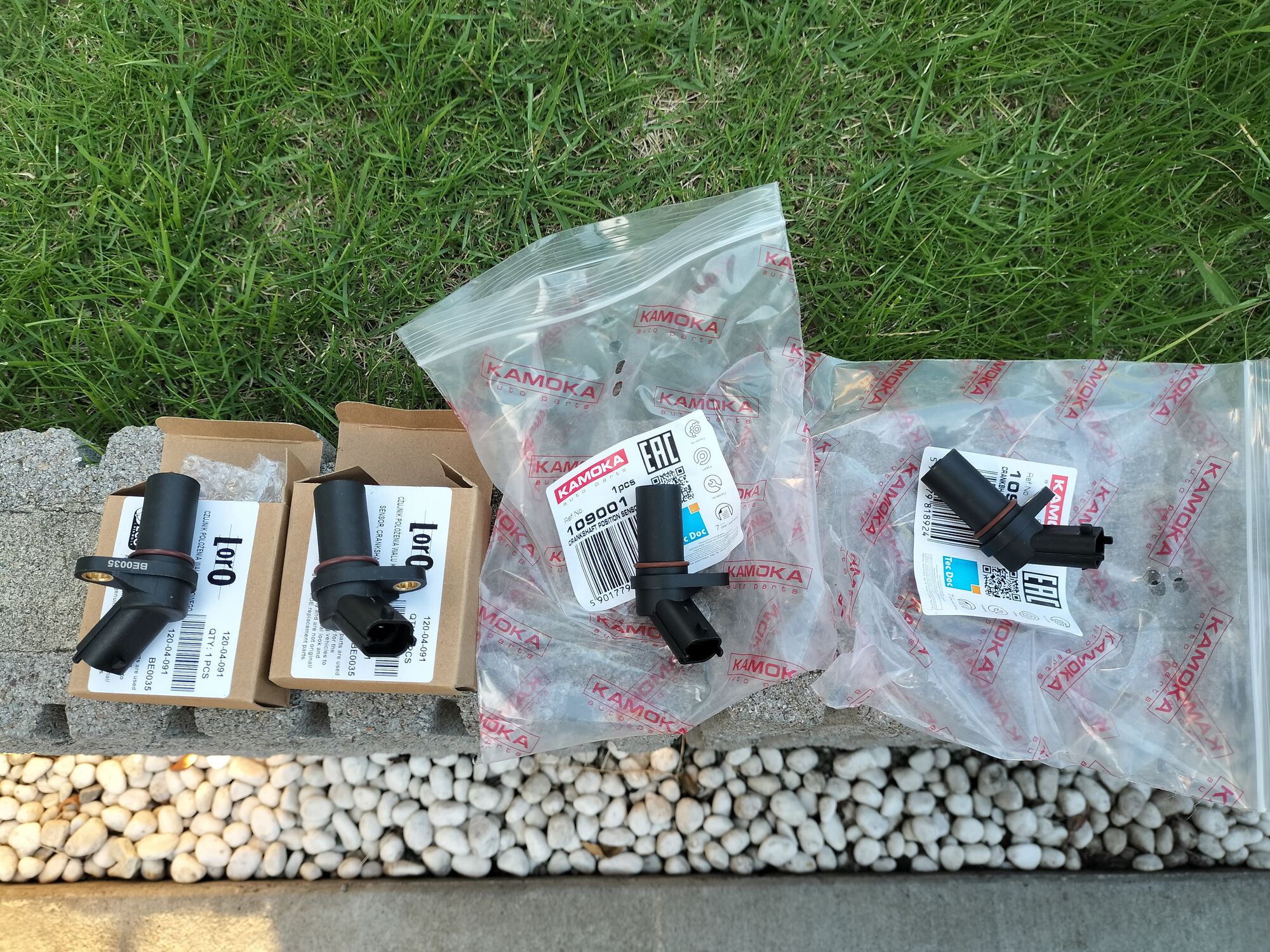

When I put the center stand up and opened the throttle, the engine turned fine. When the wheels were turned, the misfire only occurred at low speeds. I replaced the speed sensor with a new one, and the roll lock unit was used, but the problem did not improve. I also replaced the immobilizer antenna, which was in stock, but the problem did not improve.

Speed sensor new
Speed sensor new
Speed sensor new

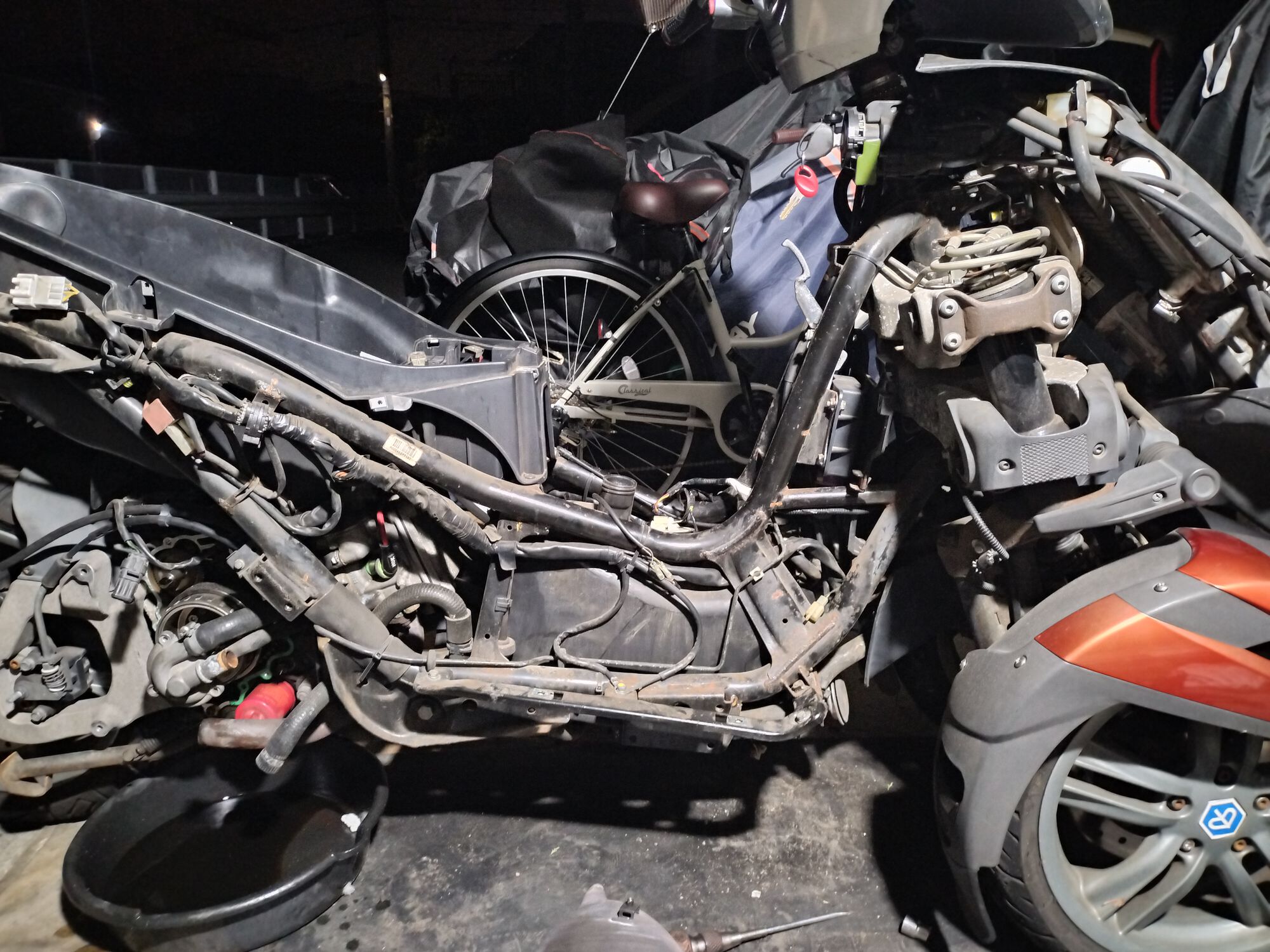

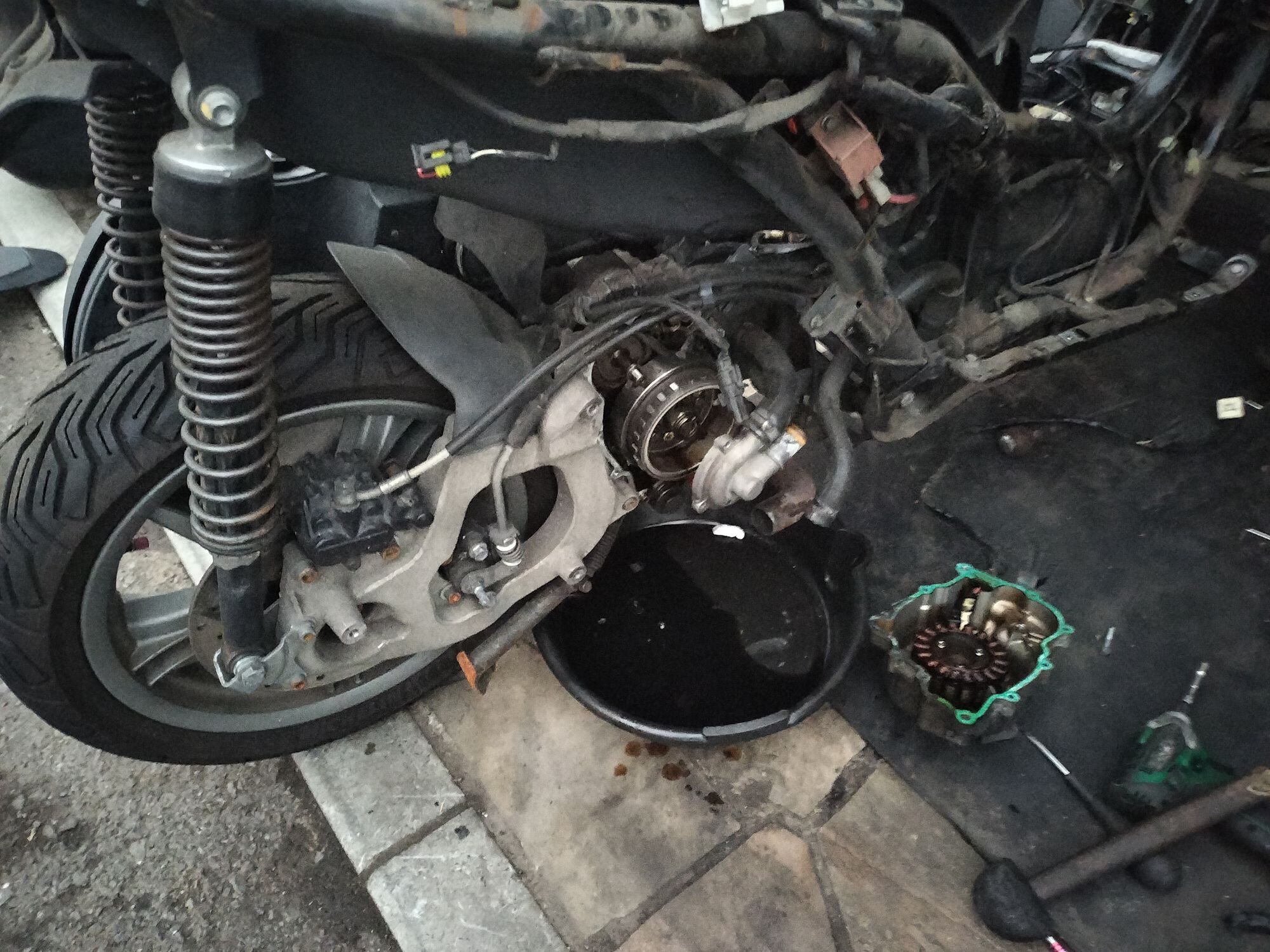

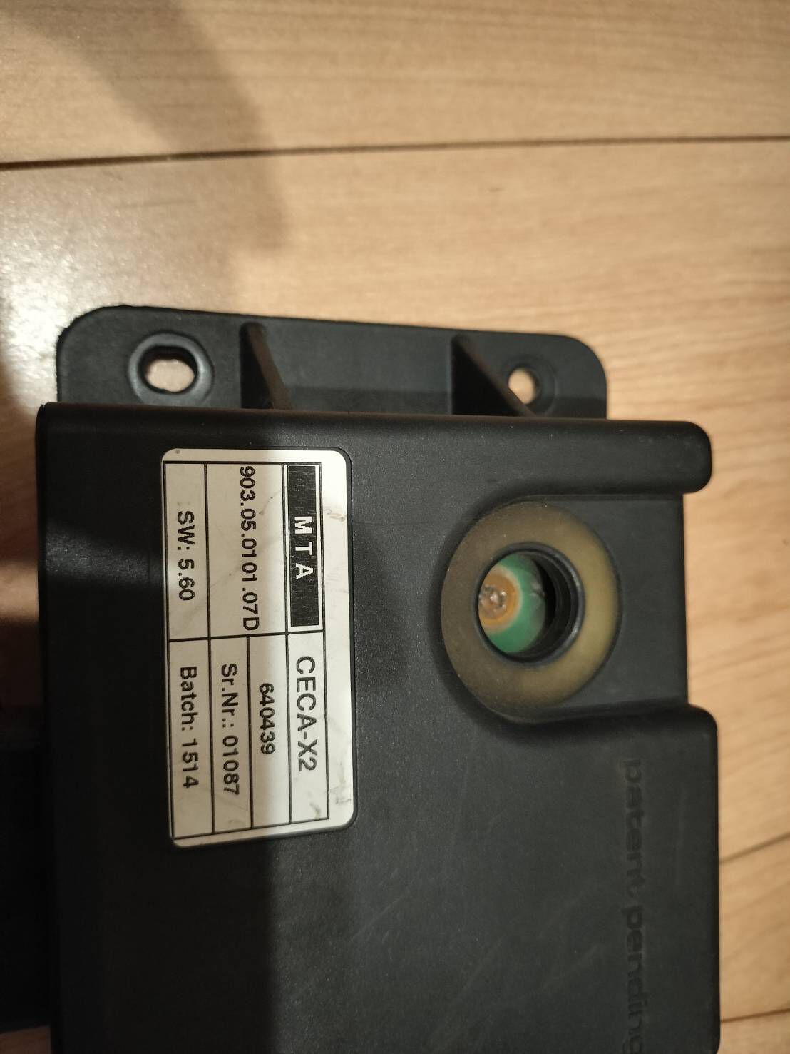

After that, I replaced the roll lock ECU but it didn't fix the problem. Today I replaced the pickup coil and it was completely fixed. I hope this is helpful.
Posts: 4
Location: Vespa gt200
Posts: 4

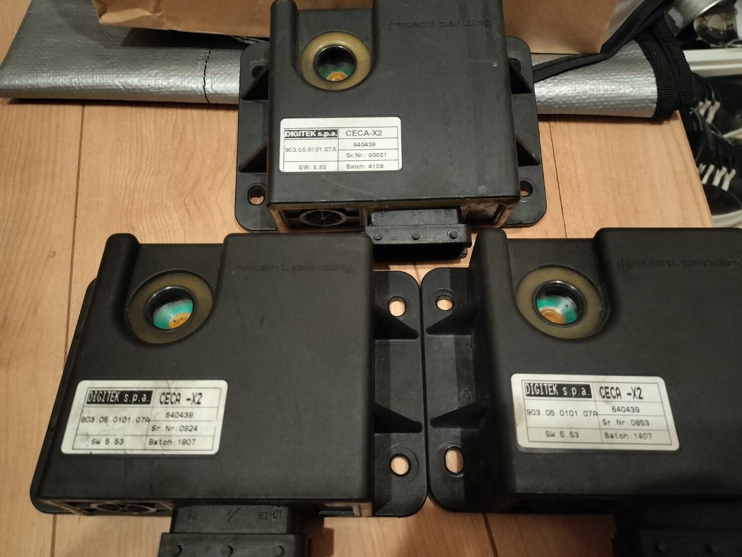

The problem has recurred. It suddenly malfunctions. After repeatedly replacing the unit, it suddenly started working normally again.
The only thing that concerns me is that the type of ECU I have is slightly different. When I use this particular ECU during a malfunction, it behaves differently.[img][/img]
