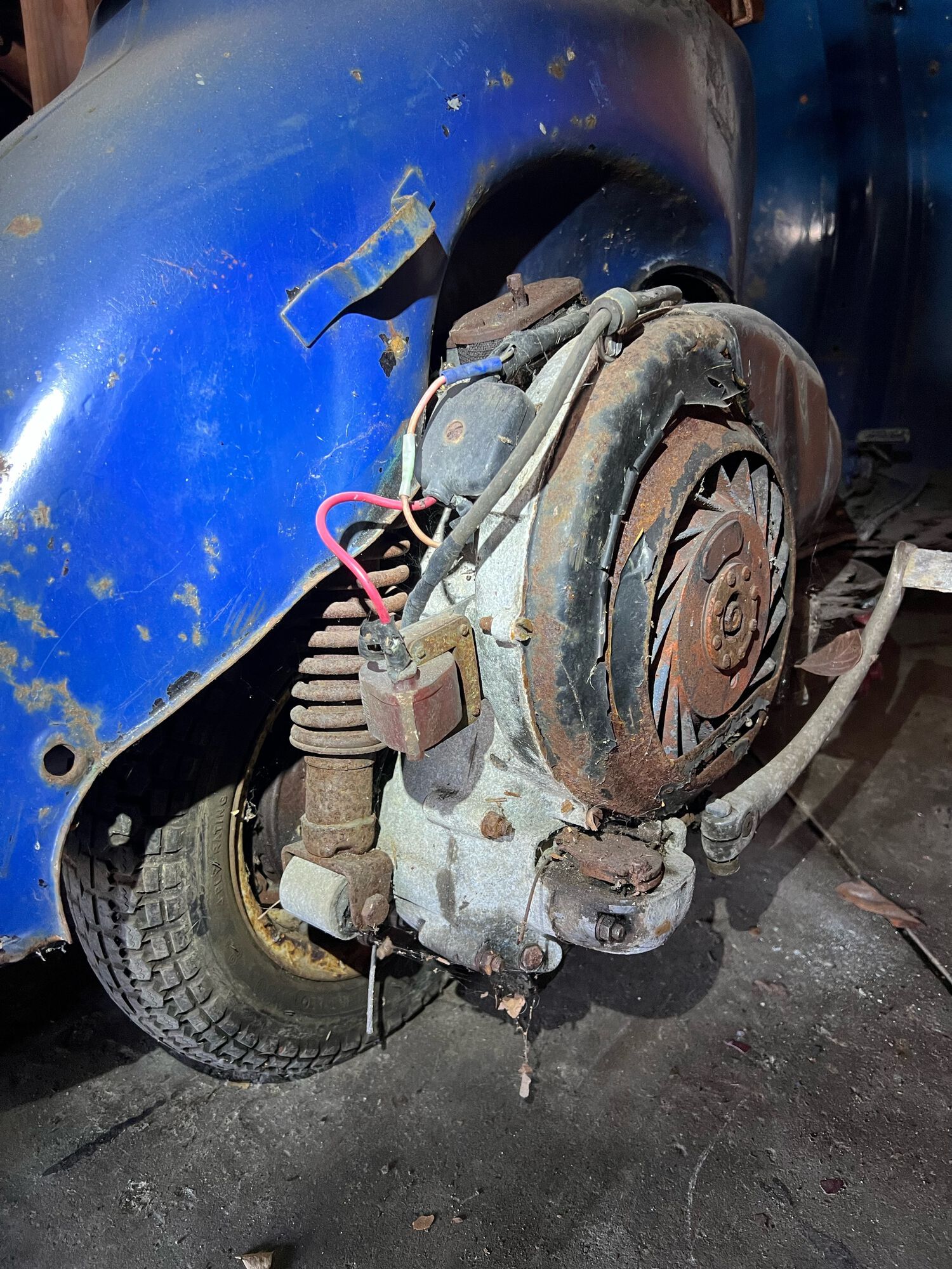

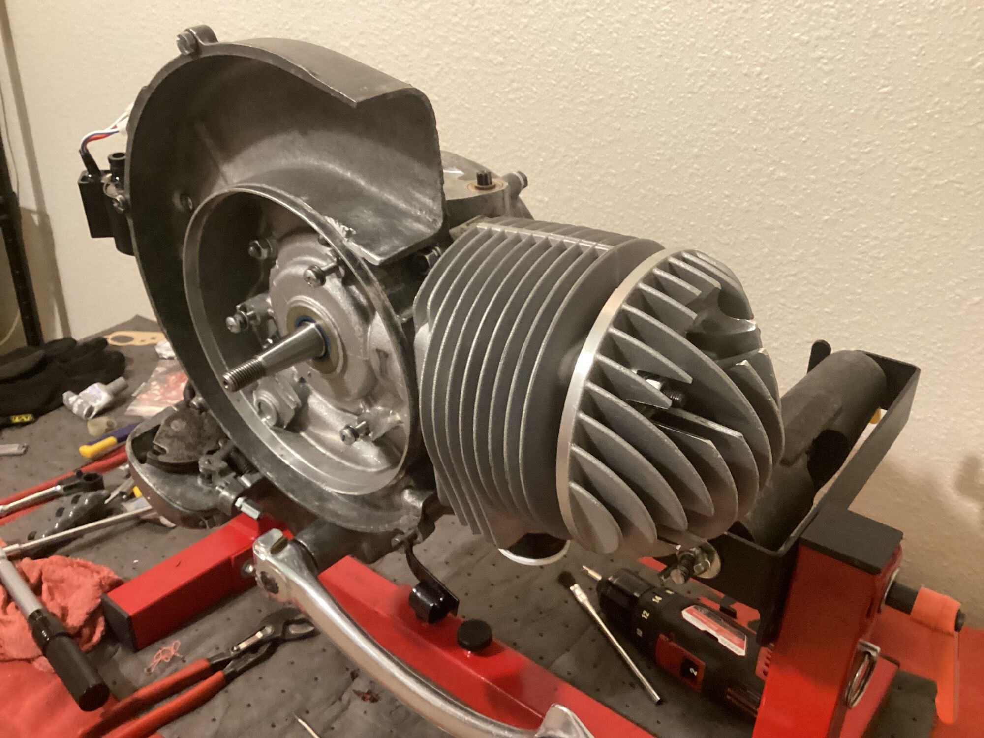

It started last summer with a Scoot2net ad.
The patient
The patient
The carb was junk and the pistoncylindercrankshaft came out as one piece of rust. Internals looked real good and the gear oil was fairly clean with no shimmer.

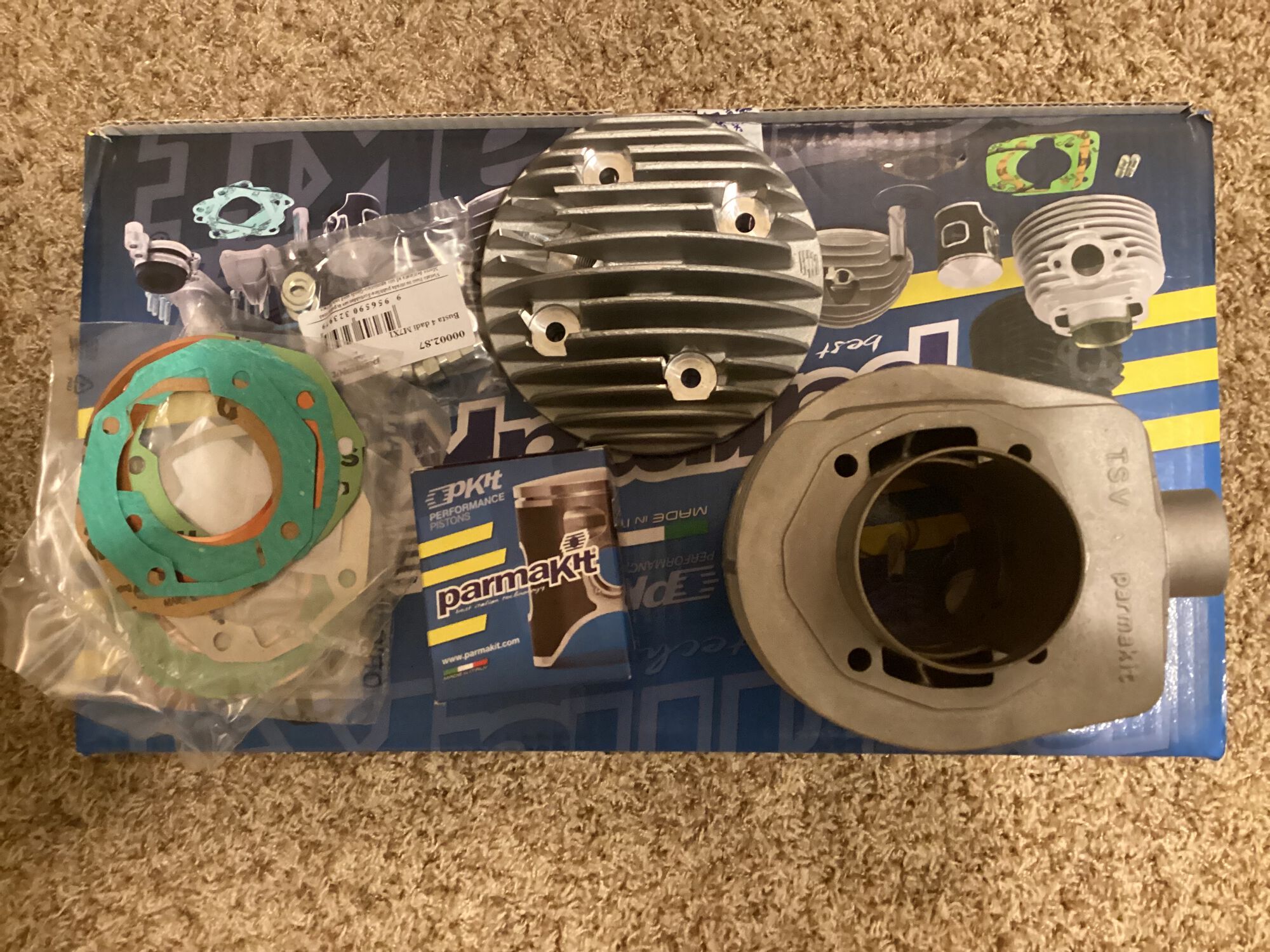

Chose this kit as I am already running the two port iron Pinasco 177 and variety
Nicely packaged and plenty of extra gaskets. Good Italian to English translation is too much to expect.

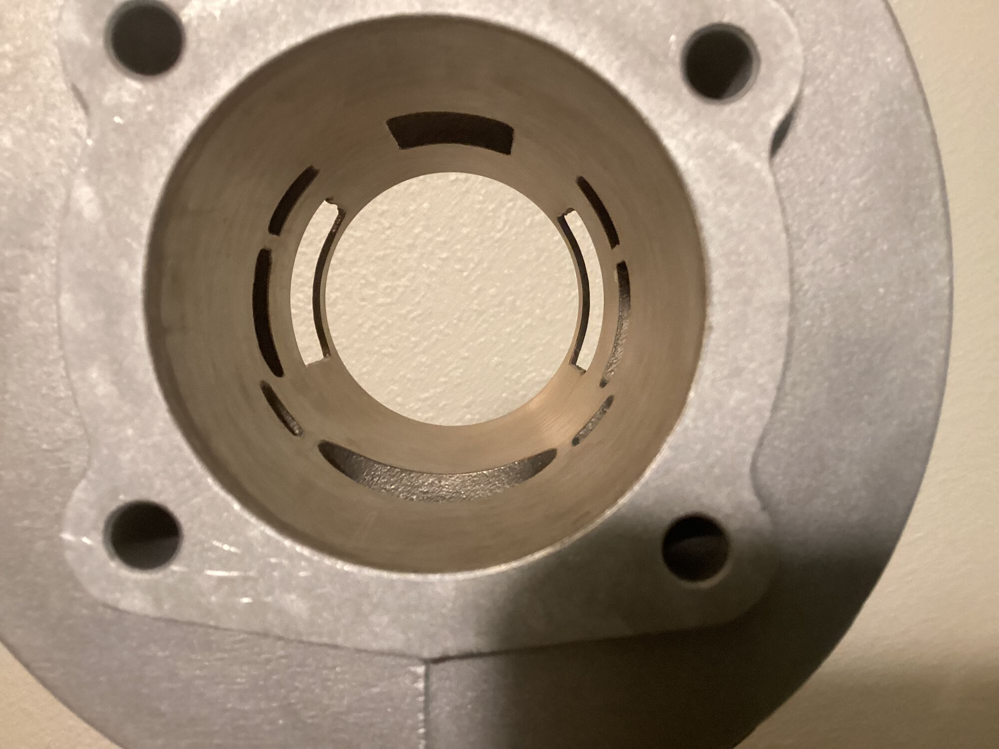

Interior
Interior

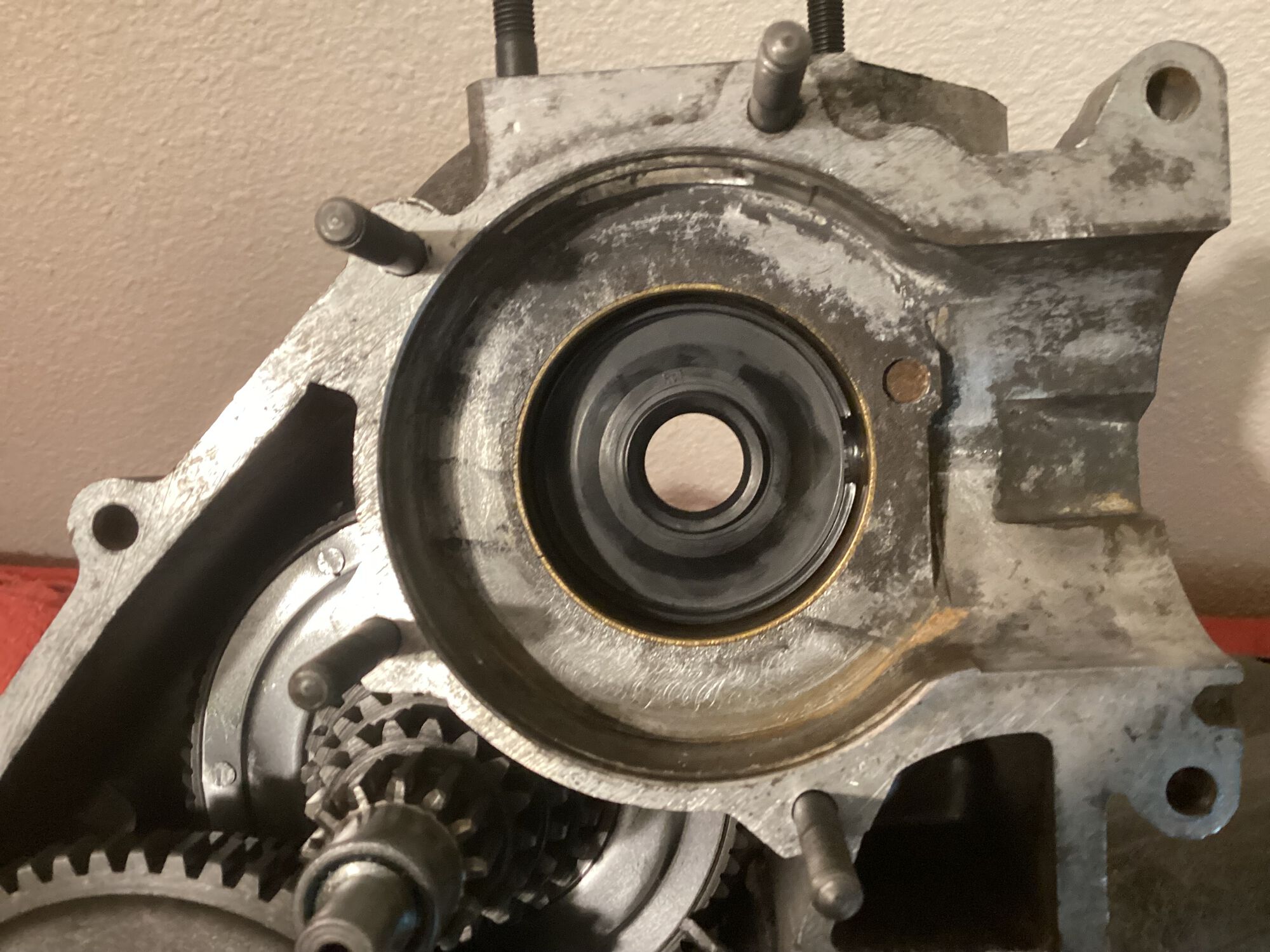

Almost ready to pressure test

So with one copper head gasket and one paper base gasket I cannot get full travel of the piston. So when adding a spacer do I need to have a paper gasket on both sides?
@ginch avatar
Posts: 9919
@ginch avatar
Posts: 9919
No you don't. In fact if it helped you could just use sealant and no gaskets at all.
What do you mean by not getting full travel? Does the piston hit the head?
Without a head fitted and no base gasket, how far does the piston project above the top of the cylinder?
@grumpnut avatar
'58 VBA
Posts: 665
Location: Chico CA
@grumpnut avatar
'58 VBA
Posts: 665
Location: Chico CA
Yep the piston hits the head which sits inside the cylinder. Still have to set the squish
@ginch avatar
Posts: 9919
@ginch avatar
Posts: 9919
Starting with no head and no base gasket, torque down the cylinder using spacers on the studs. Rotate crank to exactly TDC and measure where the top of piston sits relative to the top of the cylinder. Add the depth of the head drop down bit to the recommended squish to get your gasket/packer thickness.
You can go on from there to measure your port timings, placement of packers/gaskets top or bottom will affect this.
@grumpnut avatar
'58 VBA
Posts: 665
Location: Chico CA
@grumpnut avatar
'58 VBA
Posts: 665
Location: Chico CA
Thanks Ginch. That is super helpful.
