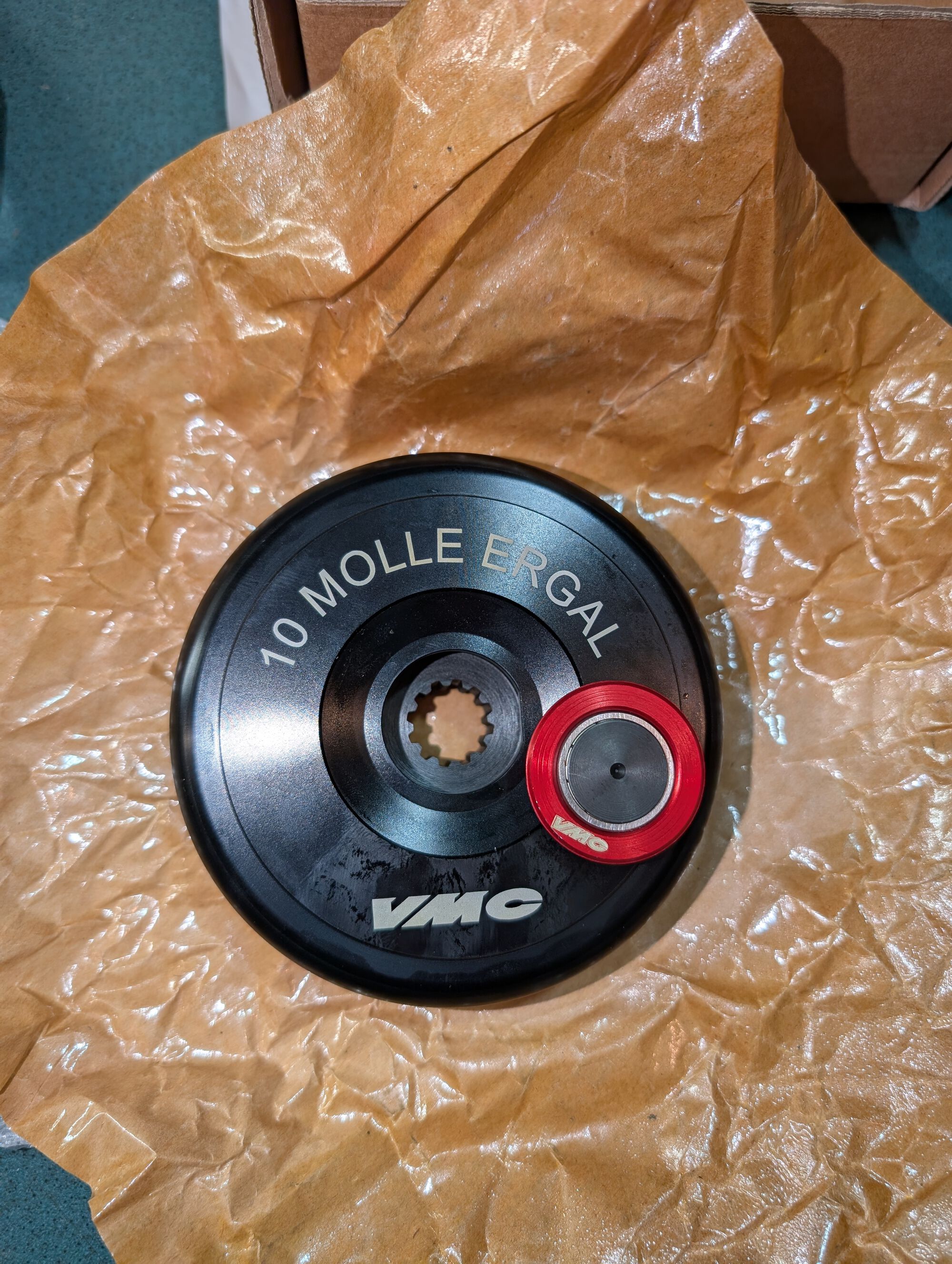

My brother runs a machine shop and believes he can grind/mill out the Autolube gear from 15mm to 20mm to fit onto the splined crank. IF that works, I'll put a spot of weld bead on the gear to lock it to a mating recess milled into the clutch base plate or maybe better, into the crank splines.
So, the next question becomes: If I go with this VMC clutch that Rikko linked,
https://www.ebay.de/itm/396709274776
what kind of insert do I use to get the 22T clutch gear? I don't see anything by VMC. Looks like what I need is a Cosa 2 Clutch Gear Cog, is this DRT part compatible?
https://www.sip-scootershop.com/en/product/clutch-gear-cog-23-teeth-drt-for-clutch-cosa-2-for-drt-primary-z-65-z-67-z-68-for-vespa-125-vna-ts-150-vba-super-180-200-rally-px80-200-pe-lusso-cosa-t5_87475000?usrc=Clutch%20gear%20cog%2023%20teeth%20drt
Does not look like 22T is an option (to mate with my existing 68T primary), but 23T would probably be fine and maybe better.
SIP appears to have that VMC splined clutch in either Steel or Aluminum basket version.

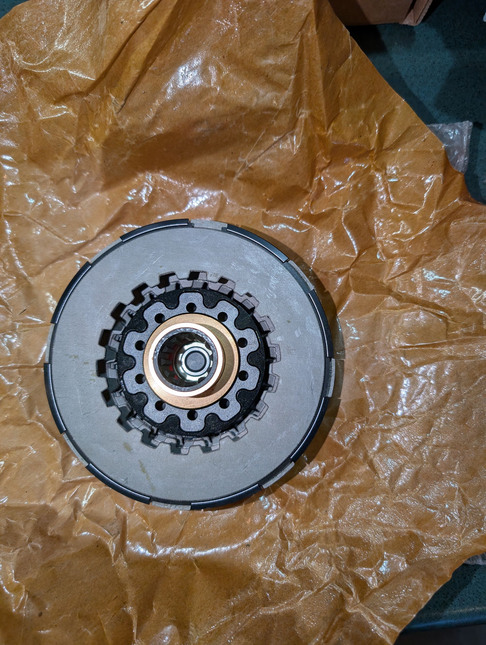

Did a bit lf learning tonight, disassembled my original 20T clutch and the new SIP Cosa 2 23T clutch. Found out they contain the same Clutch Gear Cog I was looking at earlier, and they are interchangeable. So I should be able to order just the VMC splined clutch and use the 22T clutch gear cog I have.

Gonna go with this clutch, it includes the pressure plate/bearing and is about $100 less shipped
https://ebay.us/m/eldPYa
It is aluminum, which should be fine for the moderate ~20hp I'm hoping for.

Most that I found on eBay include the pressure plate (with bearing), shim, and a nut (yet to see it in eBay photos). I ordered the Ergal (Al-alloy) kit, keyed mount, with 4+4 plates, Seeger ring, two sets of springs. Total at 195€ + 10€ for shipping.

I have ordered one from the same seller that Rikko linked, but chose an aluminum version.
https://ebay.us/m/o2Joei
Fingers crossed it works out ok, will find out in a few weeks or so

Got the new splined clutch a few days ago, very nice! Came with the cool throwout bearing.
I'm starting a thread where I know I'll have many questions as I build this PX150E with Crono & Long stroke crank.
