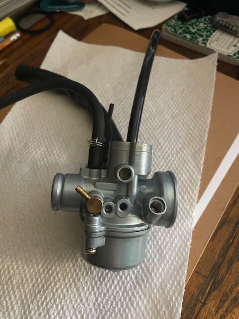

If the scooter is stock, don't replace the carb, just clean it. The carburetor will have either been made by Weber or Dellorto.

I have attached a picture of the as-found carb.
It appears the scooter probably came with an automatic choke which was replaced by a manual one. The automatic choke was sitting in the engine area.. I am assuming the black lever seen at the top of carb is a manual choke.
If I clean the as-found carb and try it out, I need to make sure I hook the vacuum, fuel, and oil lines correctly. So three questions:
1. Can anyone tell what make/model carb this is?
2. The brass nozzle pointing towards 10 o'clock in the picture, is for the
oil line, correct?
3. Should I attempt to install the automatic choke, or remove from the
scooter? (note: my wife will be the driver of this thing)...
Thank you again ...
Mike
