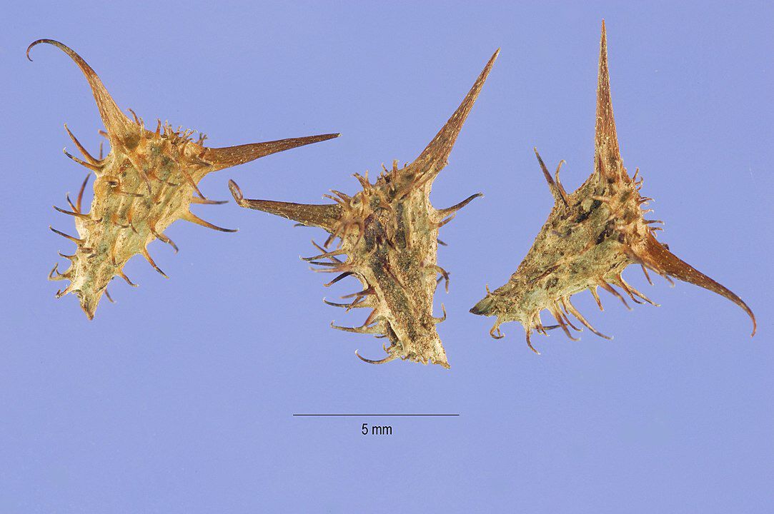

I don't have any experience with scooters, but after my son put slime in his bicycle inner tubes he went from fixing flats every few days to every few months. If he noticed the tyre was soft, he just removed the cause of the puncture, if it was evident, pumped the tyre up, spun the wheel to get the slime to the puncture, and rode off.
"Goat's head" seeds: deadly to bicycle tyres!

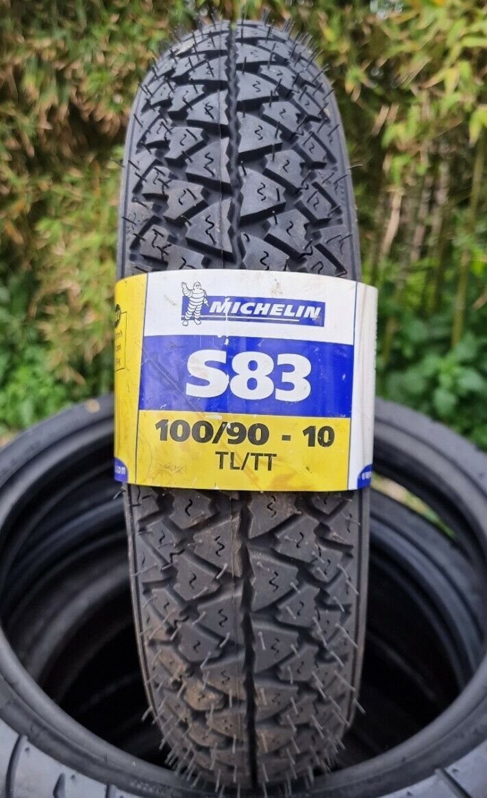

Nitro200 wrote:
Tubes in a Tubeless wheel will cause a blow out and are very dangerous
Tubeless wheels are much safer because they tend to go flat slower when the tire gets punctured resulting in just a wobbly ride .
FYI lots of tires is TL/TT. For example Michelin S83 TL/TT type have note on the side - "Tubeless. On tube type rim use a tube"
