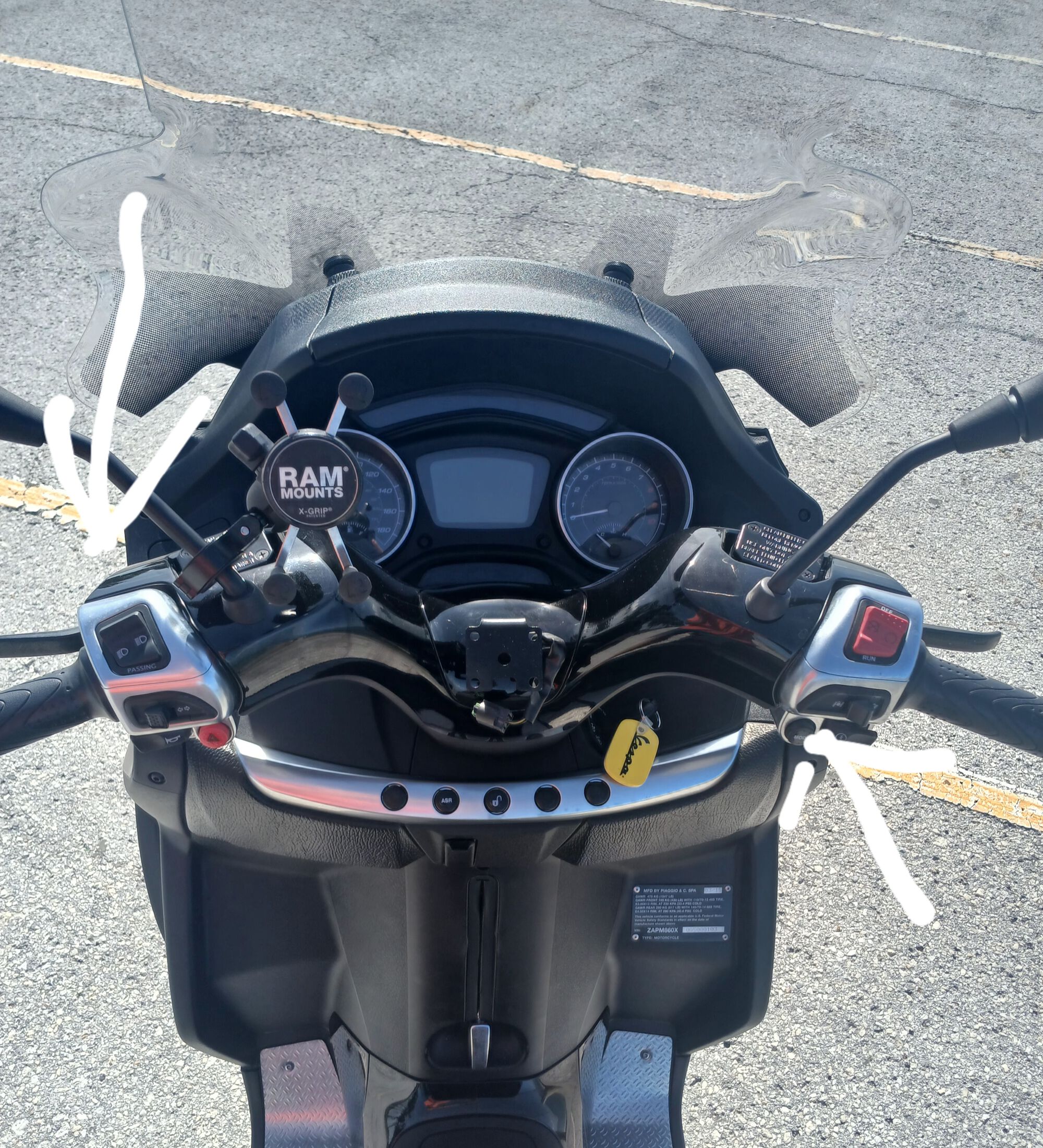

I recently purchased a 2016 mp3 500 sport. I've noticed a lot of hot air coming through the handlebar cowling and over the grips. Is this normal? Can I reduce or divert it via fan shroud?
Temp guage is running at half mark as it should. I live in florida and prefer scooters over bikes because the heat is directed away from me.

It seams the fan shroud is designed to vent the heat into the console and handlebars.
