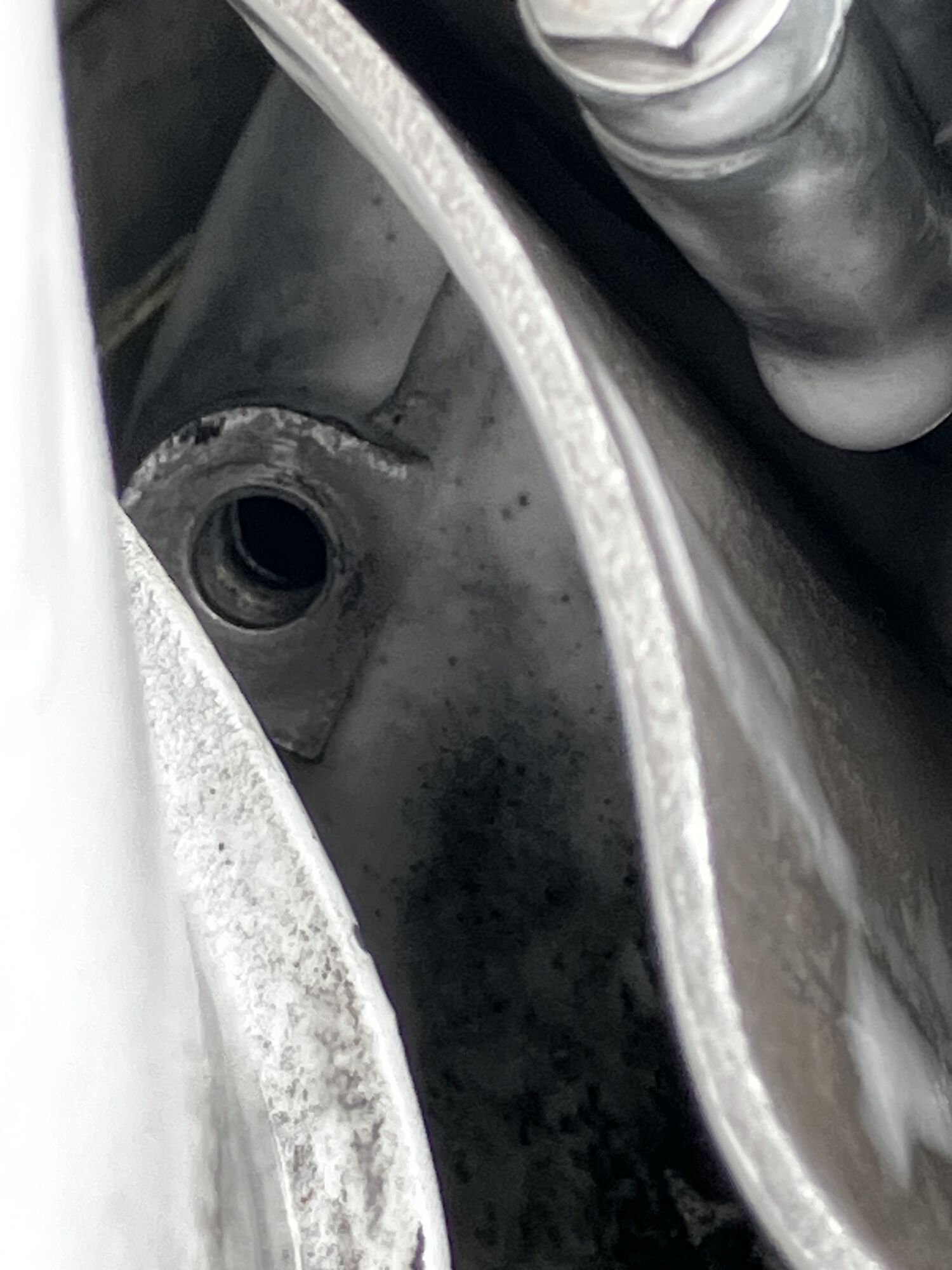

I just noticed that my muffler was loose while running it, imagine my shock... I have no idea how long it was like this, but the pipe was bouncing where it meets the motor. I fear there's a chance I let entirely too much air into the cylinder ans a result of it being loose, causing the motor to overheat. I'd bet that I fried the seals, or possibly cracked the piston rings, or worse at this point. I'm afraid the only way to assess the damage is to pull the cases and rebuild the motor. A costly rookie mistake… I think that would explain the compression being somewhat low at 100ish PSI and the scooter only being able to run at full throttle.

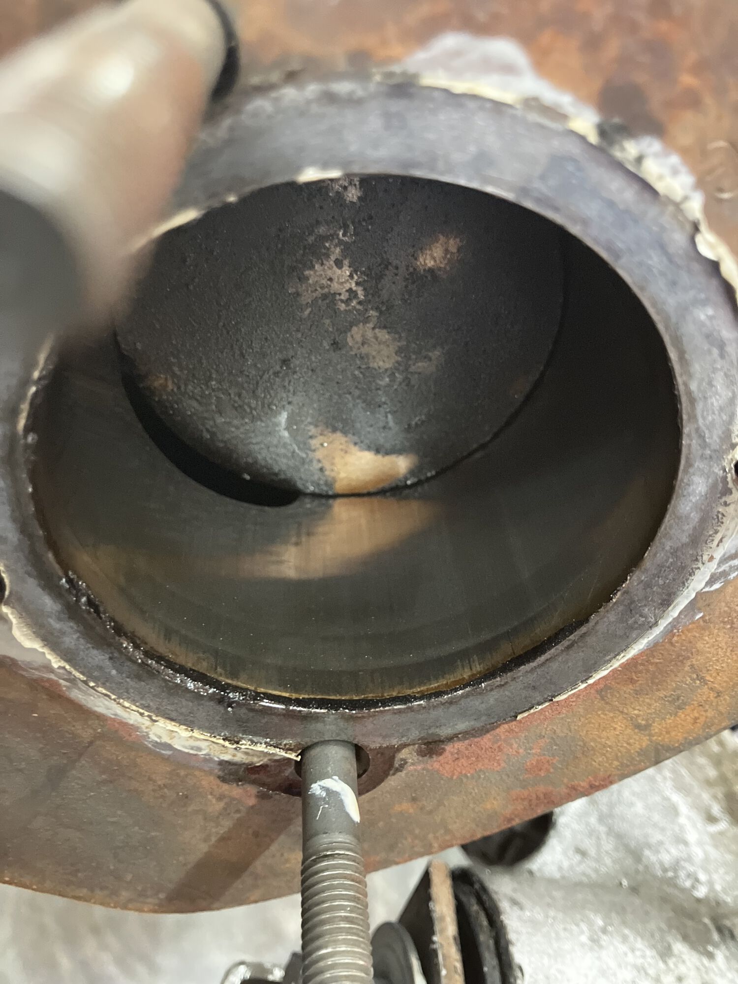

We put a borescope into the cylinder and the top of the piston is caked. There's also some scoring in the cylinder wall. I'll post some pictures of that shortly. More bad signs.
I'm thinking at the very least a new muffler, I'm thinking Malossi Power Classic. This one is an old Sito Plus that was sitting in a field with the scooter for years before we tore the bike down. I'm also thinking a new cylinder kit, and a full rebuild kit for gaskets and seals, cush drive, etc. This could be a $500 mistake so please friends, don't be like me.
Any other input would be appreciated. More pictures soon.

Borescope picture, as promised. My theory right now is that it's way too hot in the cylinder due to the loose muffler/blown seal to the point that it's baking the oil onto the piston, further worsening the lubrication situation. I learned in shop class many years ago that the #1 cause of engine failure is overheating…
If anyone has a better idea, please tell me. I'm crestfallen.

A blown seal or loose exhaust won't have a drastic effect on temps in my experience. Running way too hot will give you a very light-coloured piston and plug.

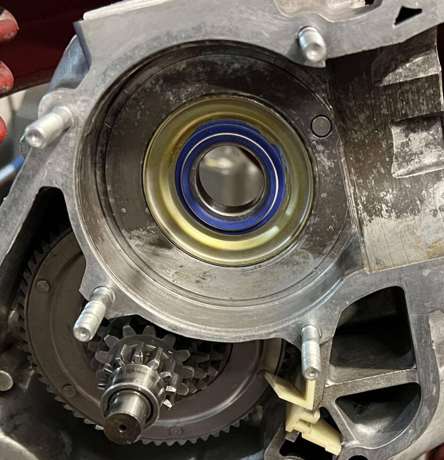

Did the clutch breather test. Removed the clutch breather and put a finger over the hole. When kicking the scooter over, the clutch breather port wants to blow air out, you can feel it. When the scooter starts is running, the port wants to suck air in.
We added some glass cleaner to watch for air leaks to confirm our findings after this test, and it wanted to suck the glass cleaner in while running.
What does everyone think?

Pulling in the glass cleaner, is pretty much the same a pulling in the oil from the same compartment. Which suggests an air leak.

I think your clutch side seal is toast and you're going to need to split the cases and pull the crank to replace the seal.

You were correct, my crank seal failed. You could actually see it rotate with the crank while the motor was on the stand. It was a blue crank seal that was incorrect for the application. I should've taken a video.
Attached is a picture of the cylinder. It's not as bad as I thought it was, but I went and got a new stock cylinder anyway. The crud on the piston tells me it was running a little rich. The cylinder looks glazed to me, but there's no major scoring.
Hopefully all the parts will be here by tomorrow so I can replace the seals and gaskets, install the new cylinder & piston (chamfering ports, setting ring gap, etc), and button it all back up. While everything is open we're also going replace the kickstart quadrant, rebuild the clutch, replace the neutral switch and install a new Malossi box exhaust.
I've never chamfered a cylinder before, much less ported one, so I'm a tad hesitant… but I think it will be worth it to have a fresh new cylinder while the cases are split. Should run like a top.

That cylinder looks pretty good to me! I don't think you effed anything up to bad. If you soft-seized it would be all scuffed up. And even then you could ride with it unless it was really bad.

So the chronicles continue…
Today was the first start-up after replacing the crank seal and putting the motor back together with fresh gaskets, rebuilt clutch (new plates, springs, etc), new stock top end (cylinder jug and piston) and a new muffler.
https://youtube.com/shorts/AnNCF4qKOrQ?feature=share
This is a video of it running on its first start-up. There's this whirring sound and I'm unsure what it could be. It sounds like it's coming from the carb. Any insight would be helpful.

Are you installing the clutch side seal in the correct orientation?? To me it sounds like the seal is rubbing on the crank…

I'm not even sure it is possible to mount it the other way round, would the case close ?
Spiritof1993 did you check the clearance between the seal and the bearing ?

The only one I have ever seen been installed the wrong way round was tje full rubber seal. That one is possible.. I've never seen the metal shield installed tbe wrong way round

Maybe he installed the rubber one the wrong way ?
This noise is really strange ! Never heard something like this before

Pic is only for reference, the rubber seal can be mounted the other way around but I've also seen the same with the metal one. How they managed to do it though, I don't know…
They probably used a hammer to close the engine

It sounds like it's coming from the carb/air box to my ears. Do you have the fiber/spacer washer mounted underneath the airbox?
Pull the carb and airbox. Make sure all is kosher and then torque the carb back into spec.
