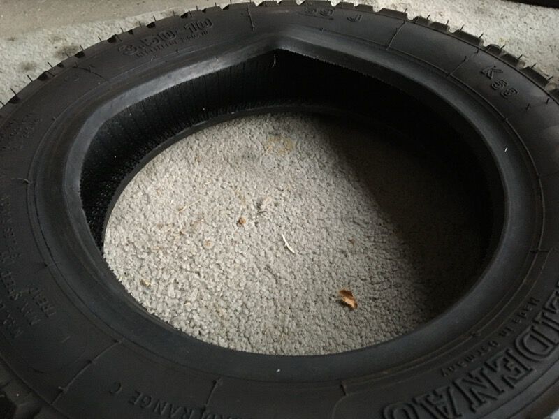

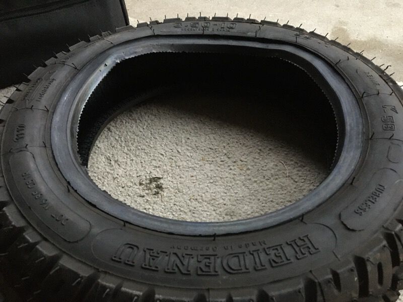

This is the reason I used them on my ZNEN. I had a business put a set of 10" Heidenau K58s (J rated) on my bike. They got wobbly at about 20mph and continued to wobble afterward. I didn't realize that they did this to the tire beads when they put them on my wheels. (see below) I'm surprised they sealed up.
Under 20mph around town, they weren't spinning fast enough for it to be as noticeable. (In fact, I've been told that a lot of places will not balance tires on a 50cc bike because at those speeds it's unnecessary.) Granted it was there, but not as bad as it was at higher speeds. I used the Dyna-Beads (or whatever brand they were) in them and they stopped the wobble. I could cruise at 55mph comfortably.
The thing to remember, as in the video, he's using a standard sized CAR tire for testing. Not to be confused with a 10" scooter tire. I won't do the math, but how many RPMs is a standard car tire spinning at 40mph vs a 10" scooter tire? It's about RPMs, not linear speed. The beads settle in at much slower speeds on smaller tires because the centrifugal force is greater at lower speeds. It's spinning faster.

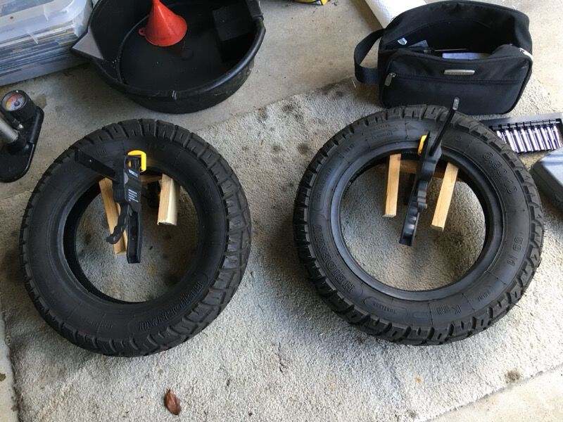

Having said all that, I reshaped the beads with clamps and put them (with tubes) on some split rims for the Stella, where I've had no issue.
