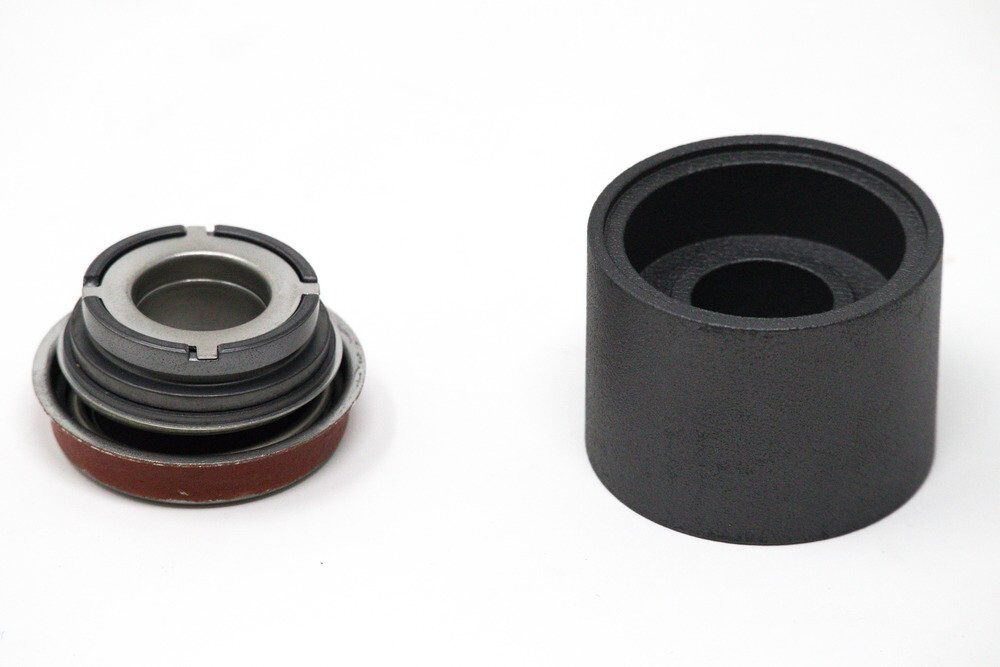

Only for reference* (is not correct tool i guess)

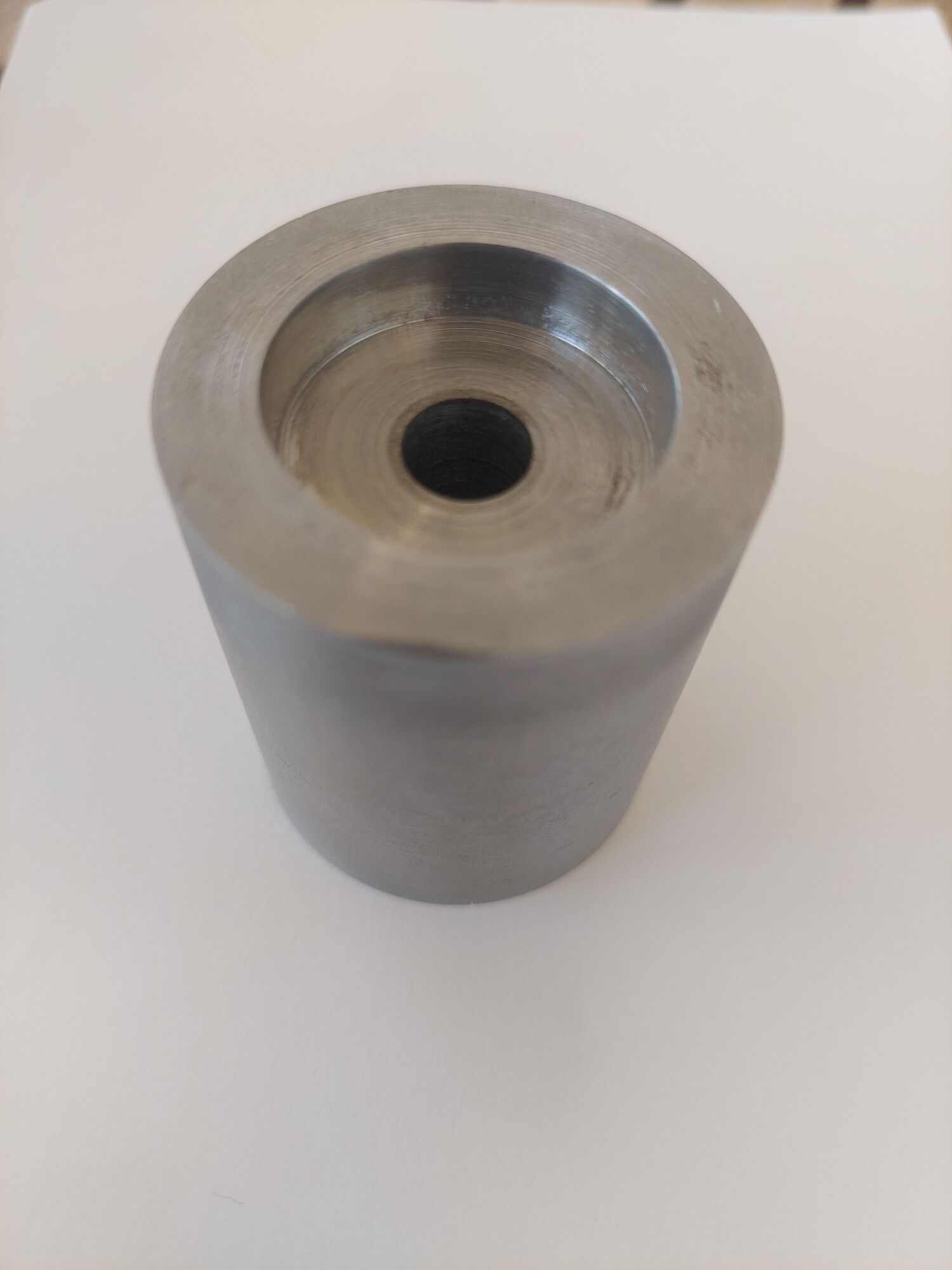

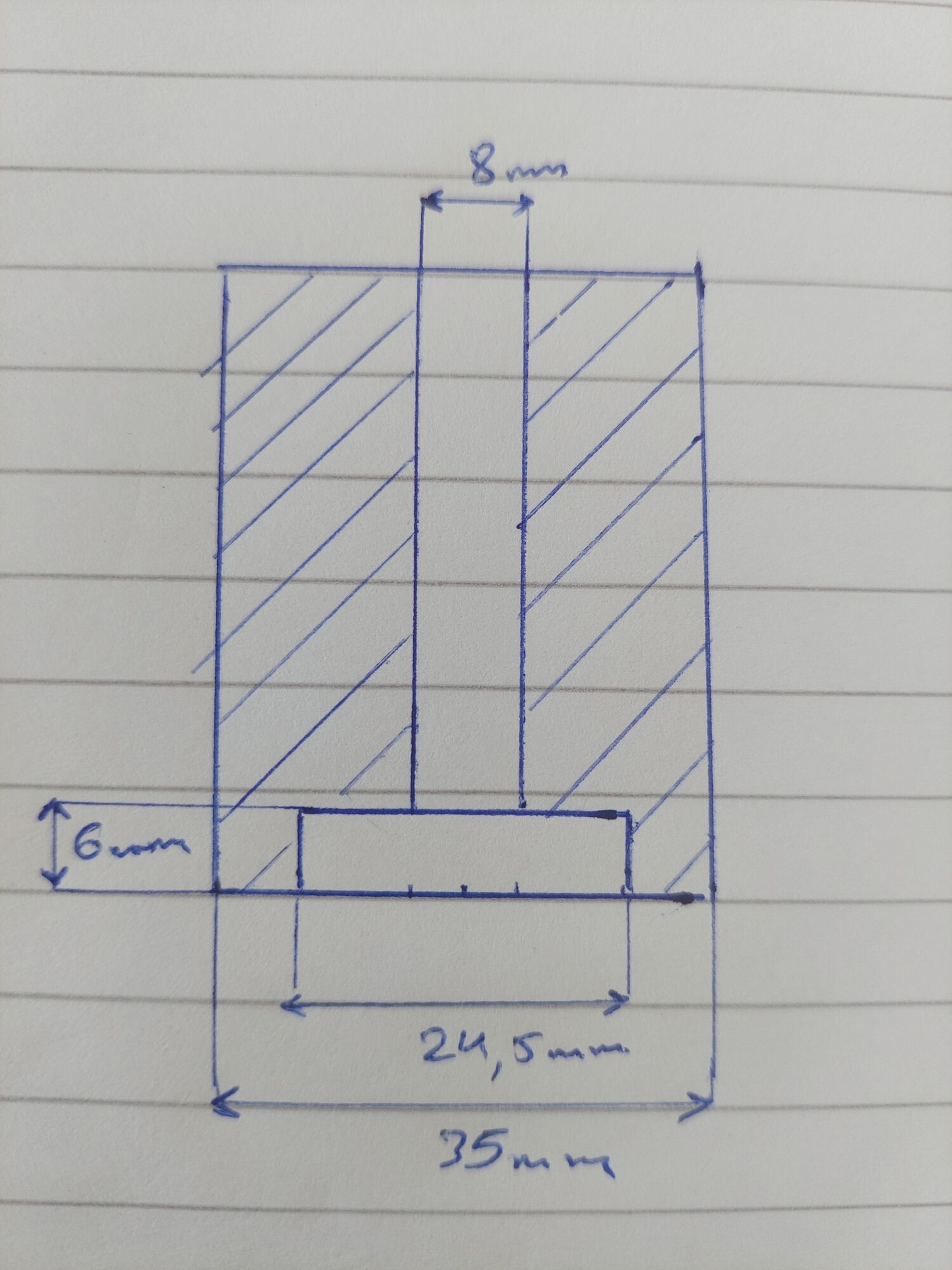

I used sockets before I made this tool.
