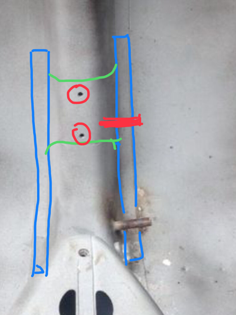

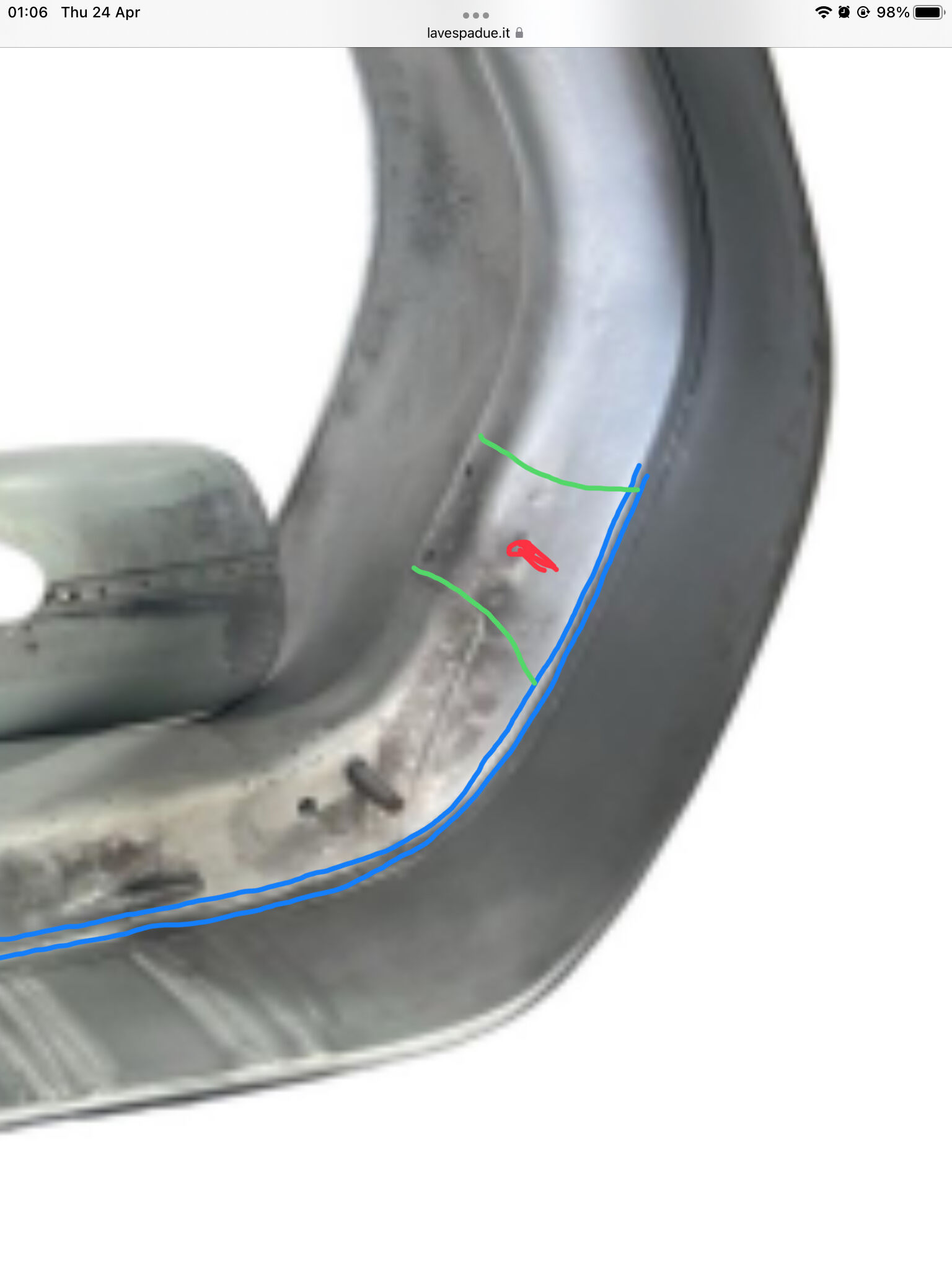

I envision that the ORIGINAL PEDAL could stay in place, with cable extending to new pedal.
Use spare wheel mount holes to secure it
Possibly brackets thru floor

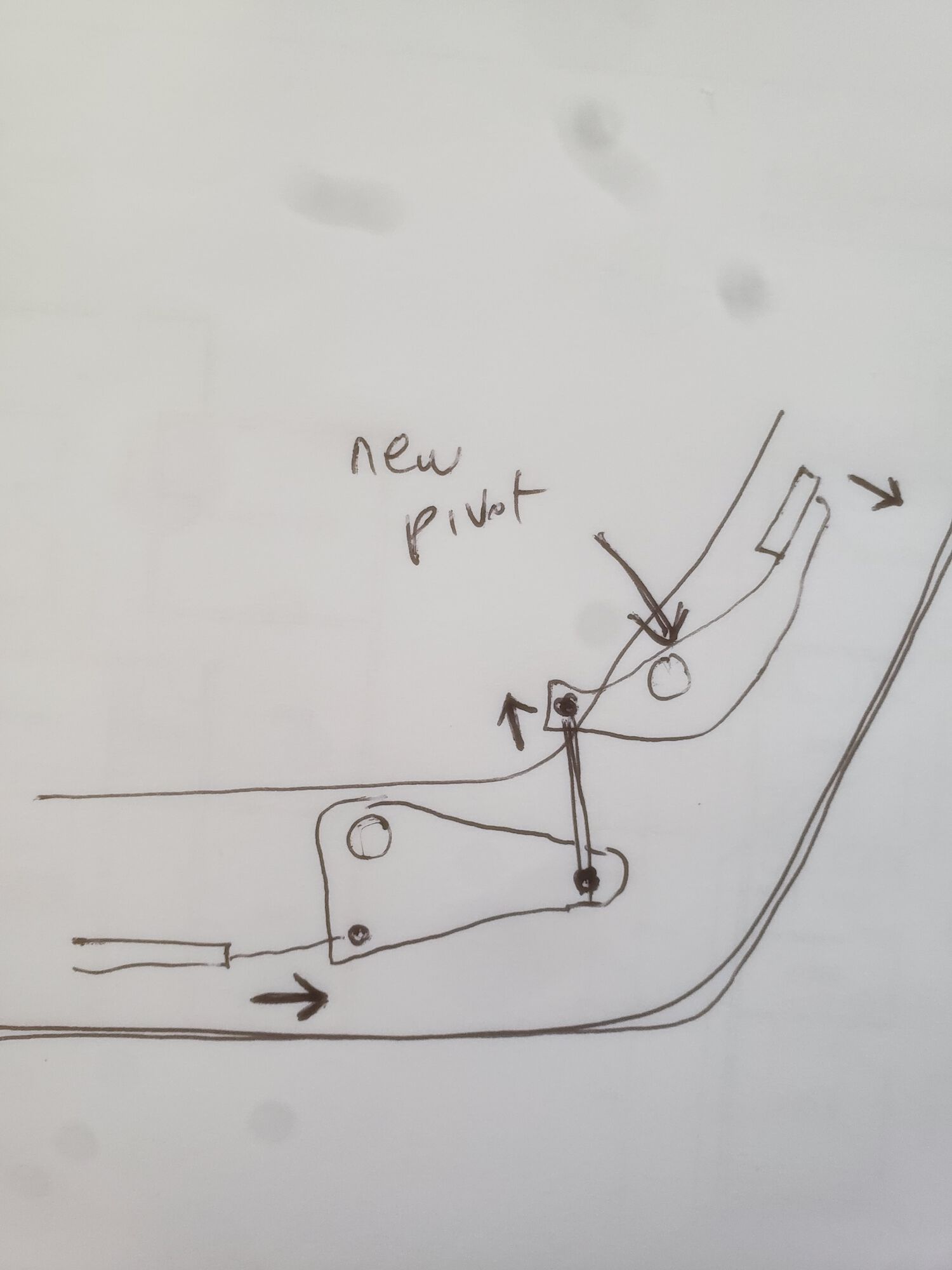

You'd need to make sure that each pivot had as little friction as mechanically possible, but I think this could work?

Think Ginch is on it.
The extra pivot might also increase pedal power!
I like that idea

SubEtherBASS wrote:
I like that idea
I imagine the new pivot could be mounted to a plate that is very closely shaped around the spine. It could be screwed into position from both sides so it can be removed with not much damage.
I think you could use a small sealed bearing, and size the pivot to press-fit into it. The bearing might be also sized to be a press-fit into a pipe, and a 20mm slice of pipe would be welded to the brake pedal. I think you can get small rose joints or similar for the linkage. The pivoting plate where the old pedal was would also need to activate the brake light switch.
