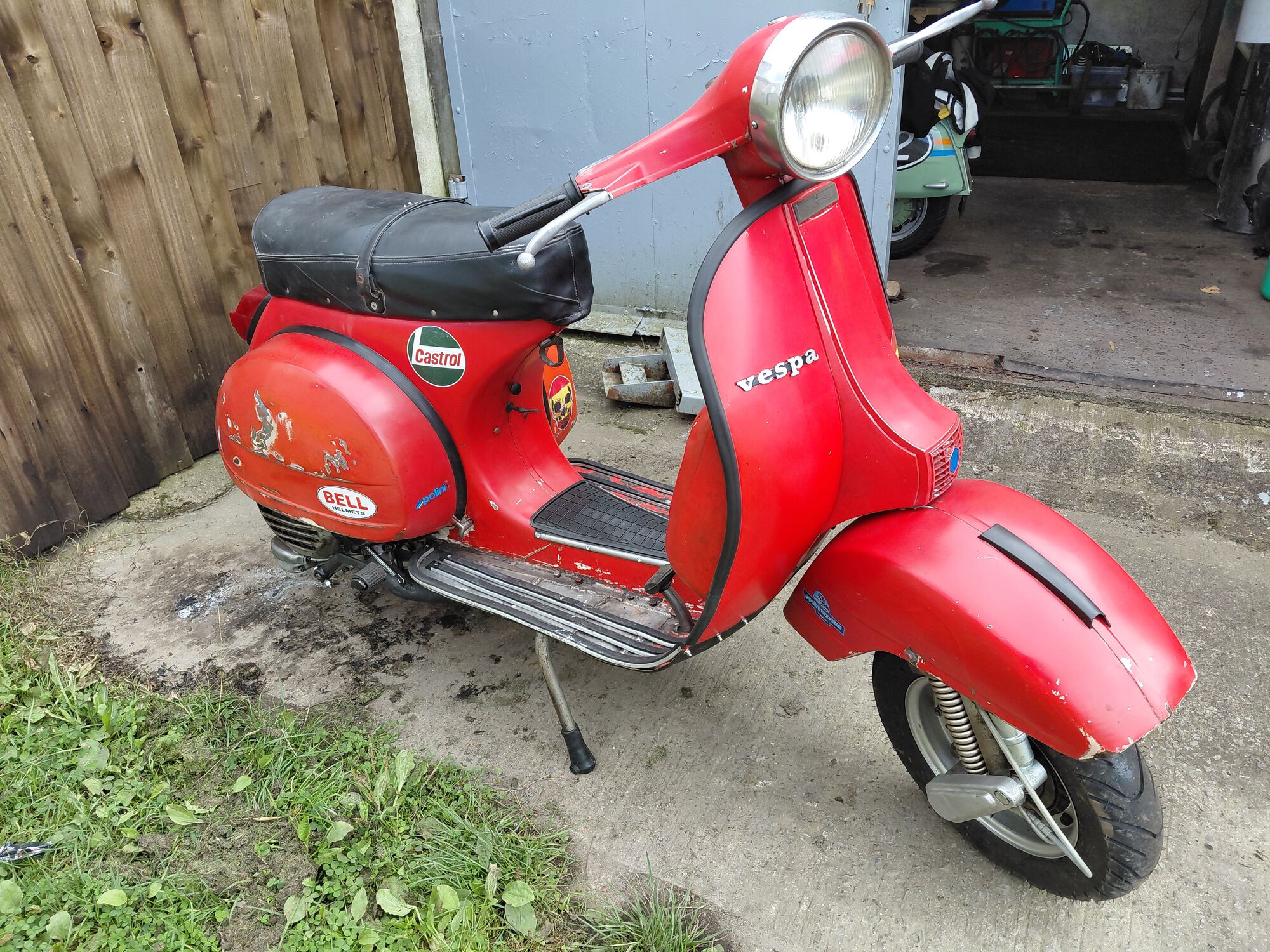

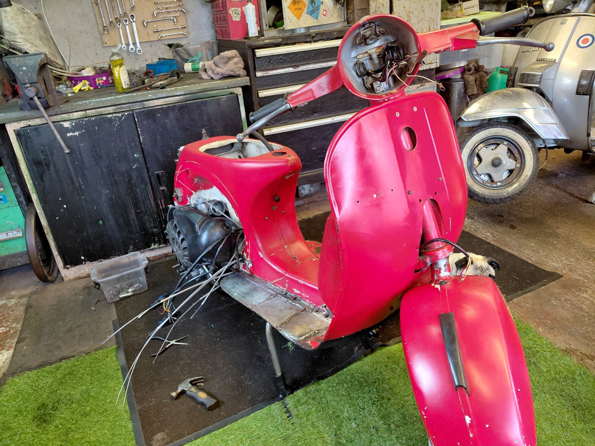

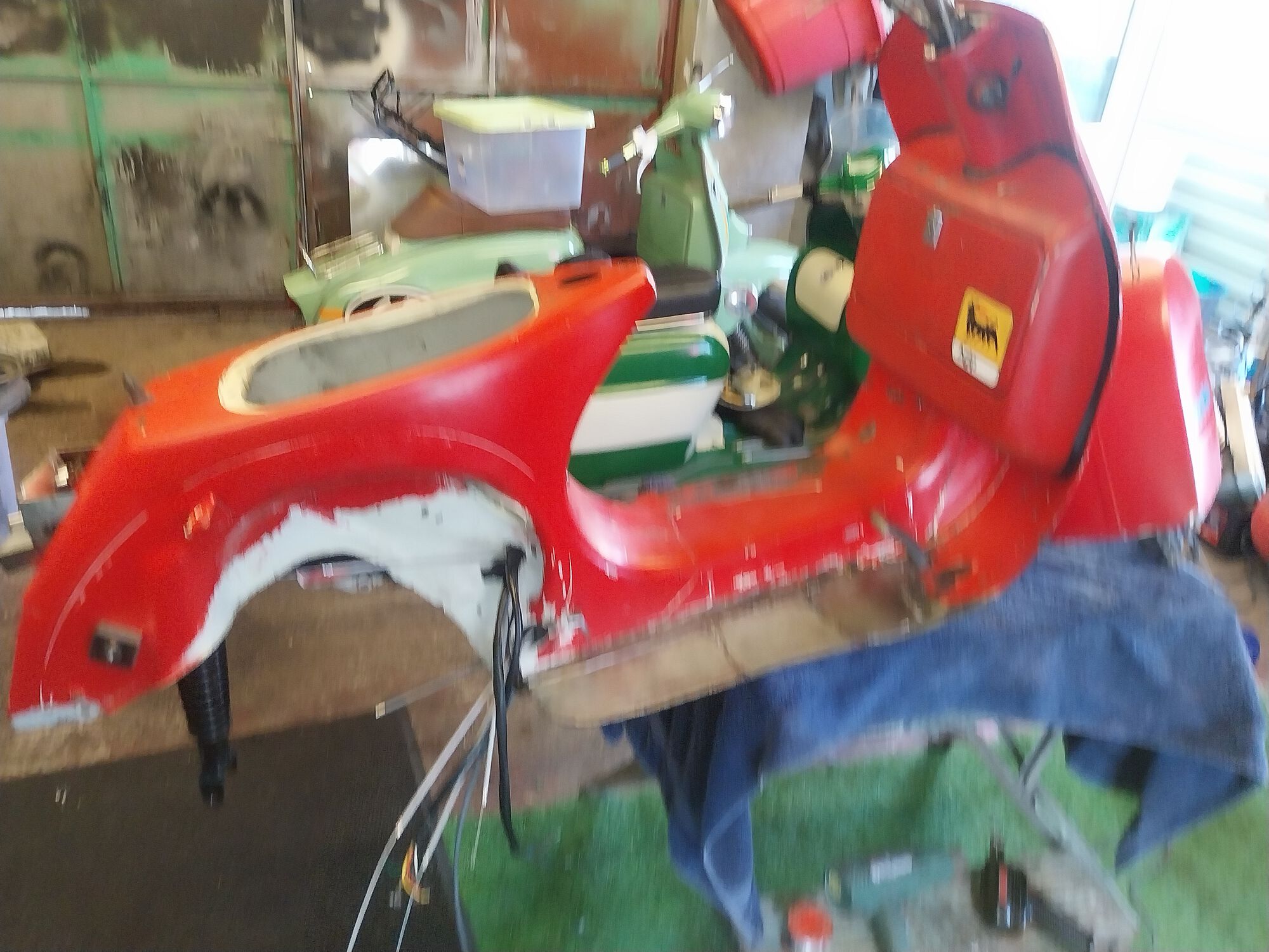

Well, it did look like this , it's in many small bits now , just sorting a rotten floorboard one side and I'll start rebuilding

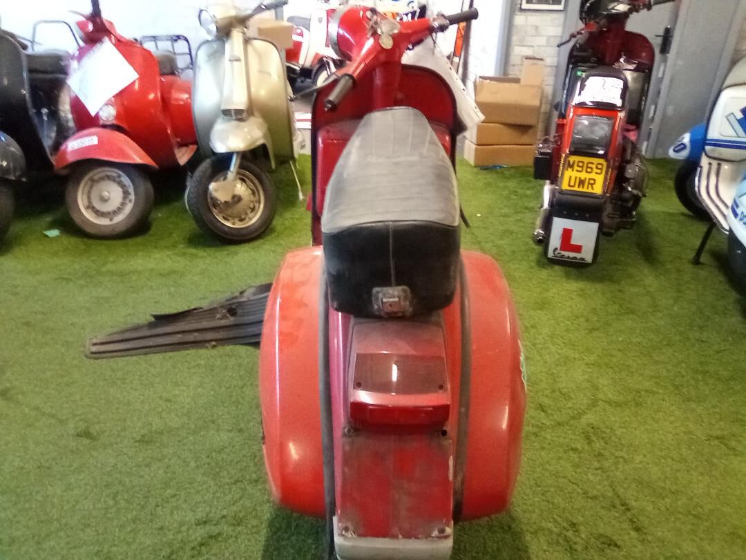

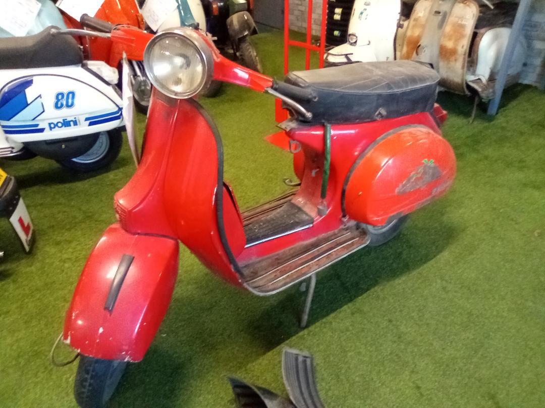

And more

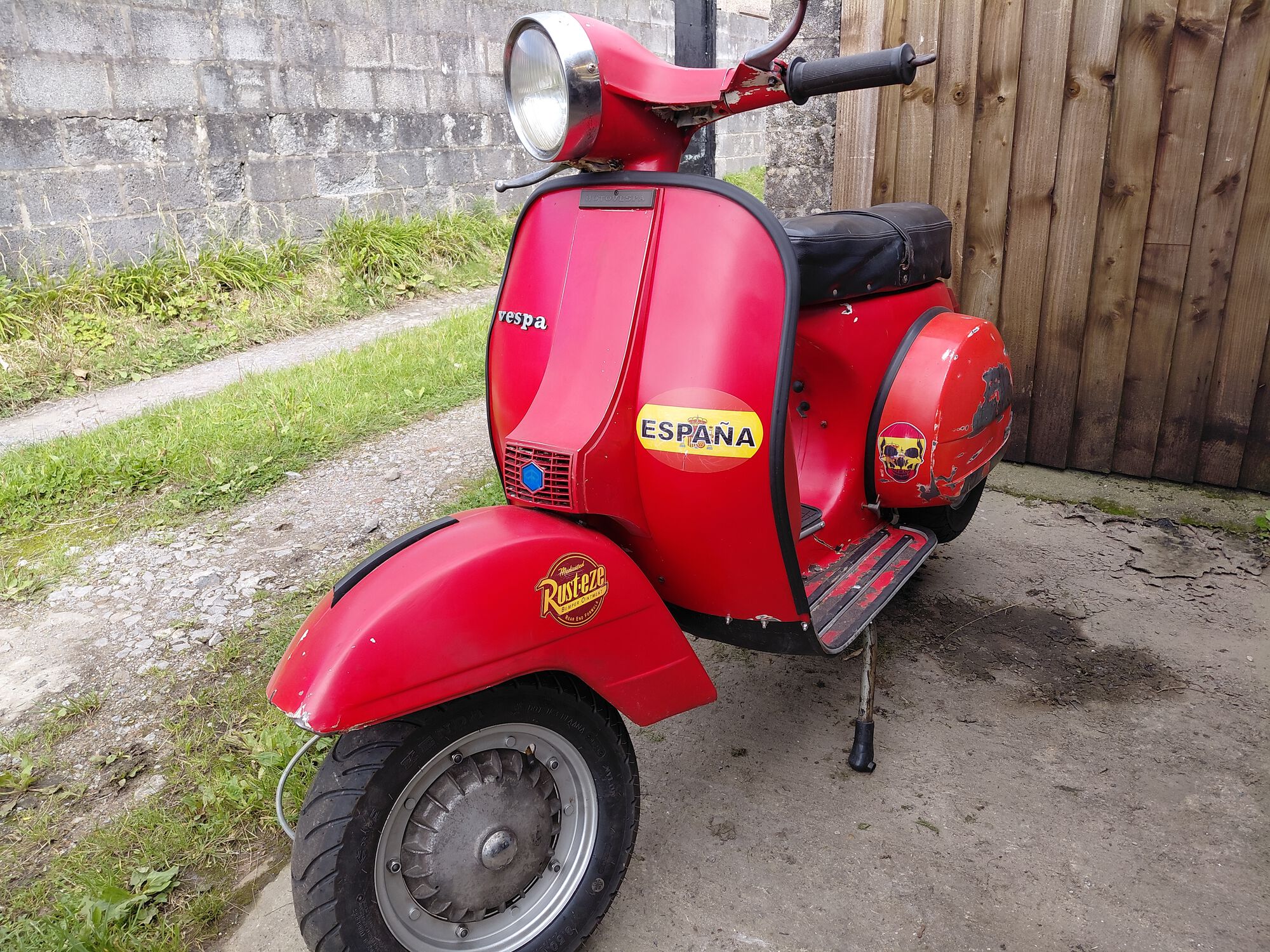

All done ....will be lots of ongoing fettling obviously as the clutch cover leaks , the downpipe leaks , the selector box leaks and finally I think the flywheel side oil seal leaks ....absolute pleasure to ride though ...
