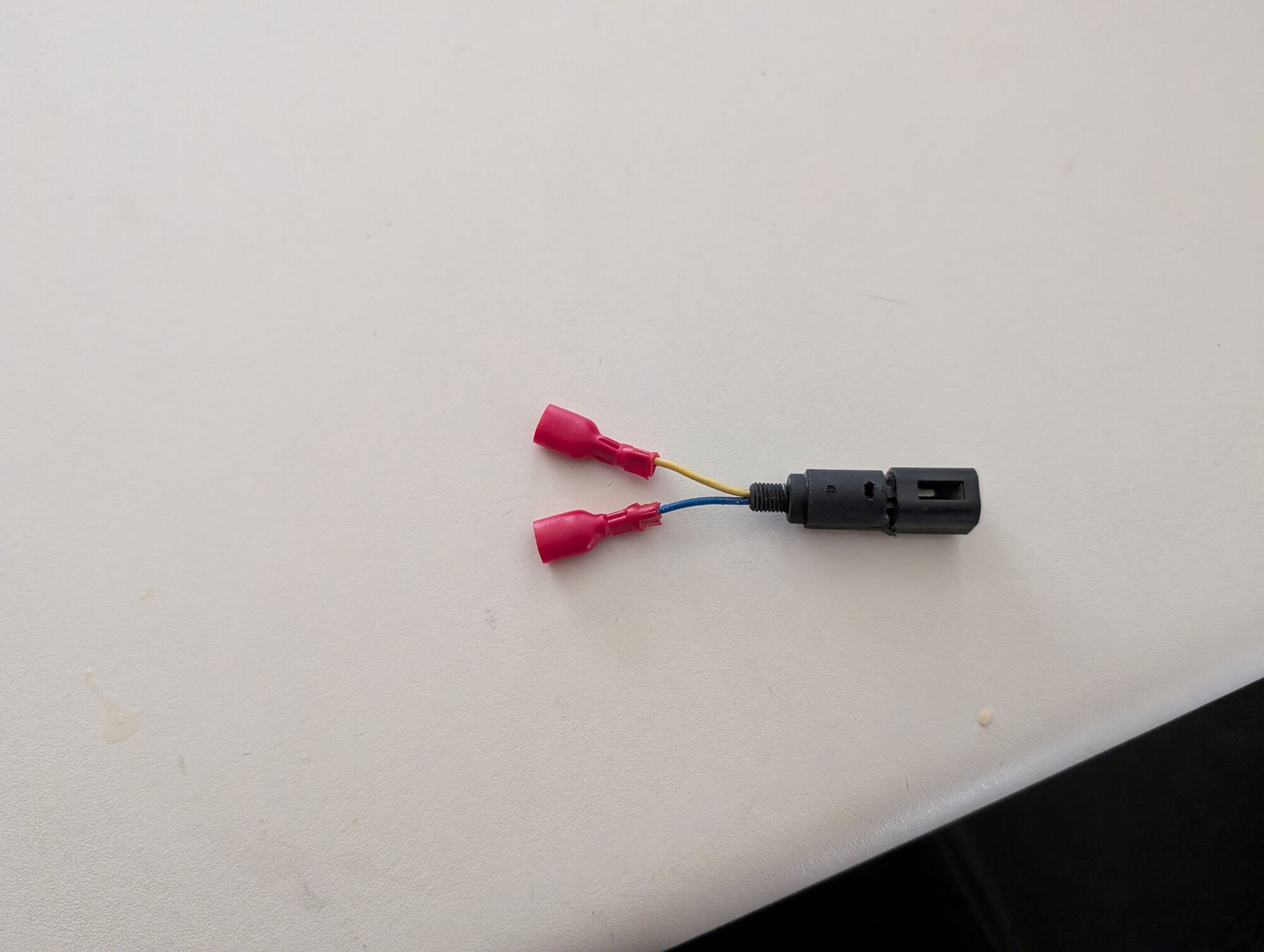

OK so I'm trying a knockoff master cylinder with a cherry switch instead of the vespa brake switch. I hate hacking harnesses so made this as an adapter using an old broken vespa brake switch
That way if someone ever fits a genuine master cylinder later they can revert to the standard switch
wiring adapter
wiring adapter
