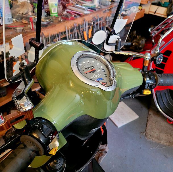

I do this all the time. I start with perforated metal off air filters and JB-Weld on the backside. Then dremel out a V on the side that does show and fill with PC-7. Finish with Bondo, spot putty, primer and paint. This headset had a 3" crack all the way through and 2 broken tabs. The paint is a sample of house paint matched to a body panel ($6.00 at Home Depot) and Rustoleum enamel clear gloss rattle can.

That sounds totally OTT for ABS - which is so simple to repair!
