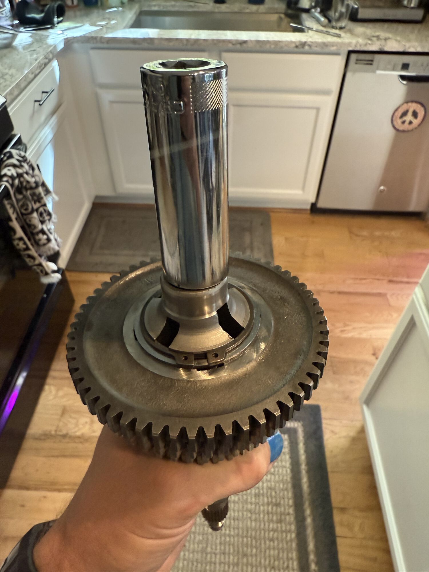

Hello all,
Trying to install my drive shaft into the new bearing but am having issues. I don't have the proper tool. I heard some people stack washers and pull it into the bearing but…..
How the fuck do you keep it from spinning while tightening?
Thanks!

Friend sits on scoot, transmission in 1st, foot down hard on rear brake.

Do you have access to a press?
That's how I put mine in.
Or you could shock it home with a soft mallet - not ideal but doable in a pinch

Thanks guys, I ended up getting it by using a large socket that rested on the shaft. Couple good smacks and it went right in.
