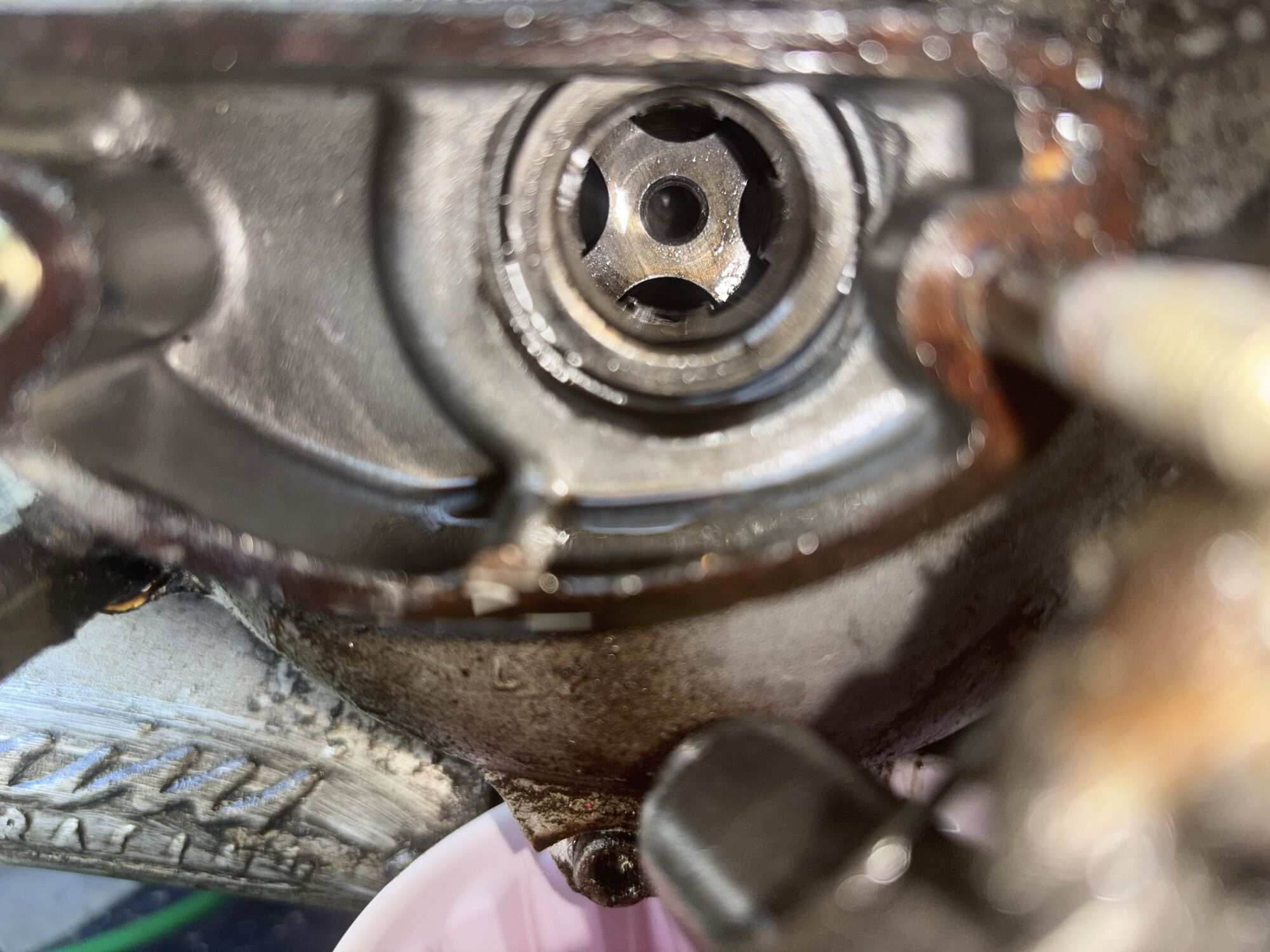

Finally having a chance to open her up. These are some pics of inside the gear selector and of the cruciform. Tell me if anything looks out of the ordinary plz.[/img]
Inside of gear selector
Cruciform
Cruciform
@gravelrash2004 avatar

As o expected.
The selector rod has disengaged from the cruciform. and it also appears to have stripped the threads on the selector rod.
You need at least a new selector rod... I can't tell if the cricifom thread is also stripped. But I would imagine it is
You now need to split the engine to replace the cruciform and selector rod
