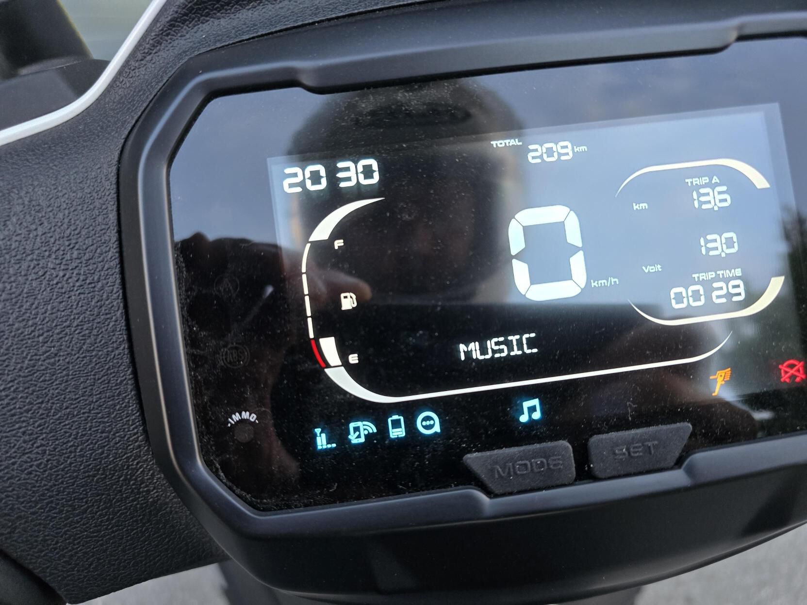

Here you can find pictures of my dash - it is clear that phone is connected but instead of 'MUSIC' these should be a song title displayed.
In this mode joystick does nothing.

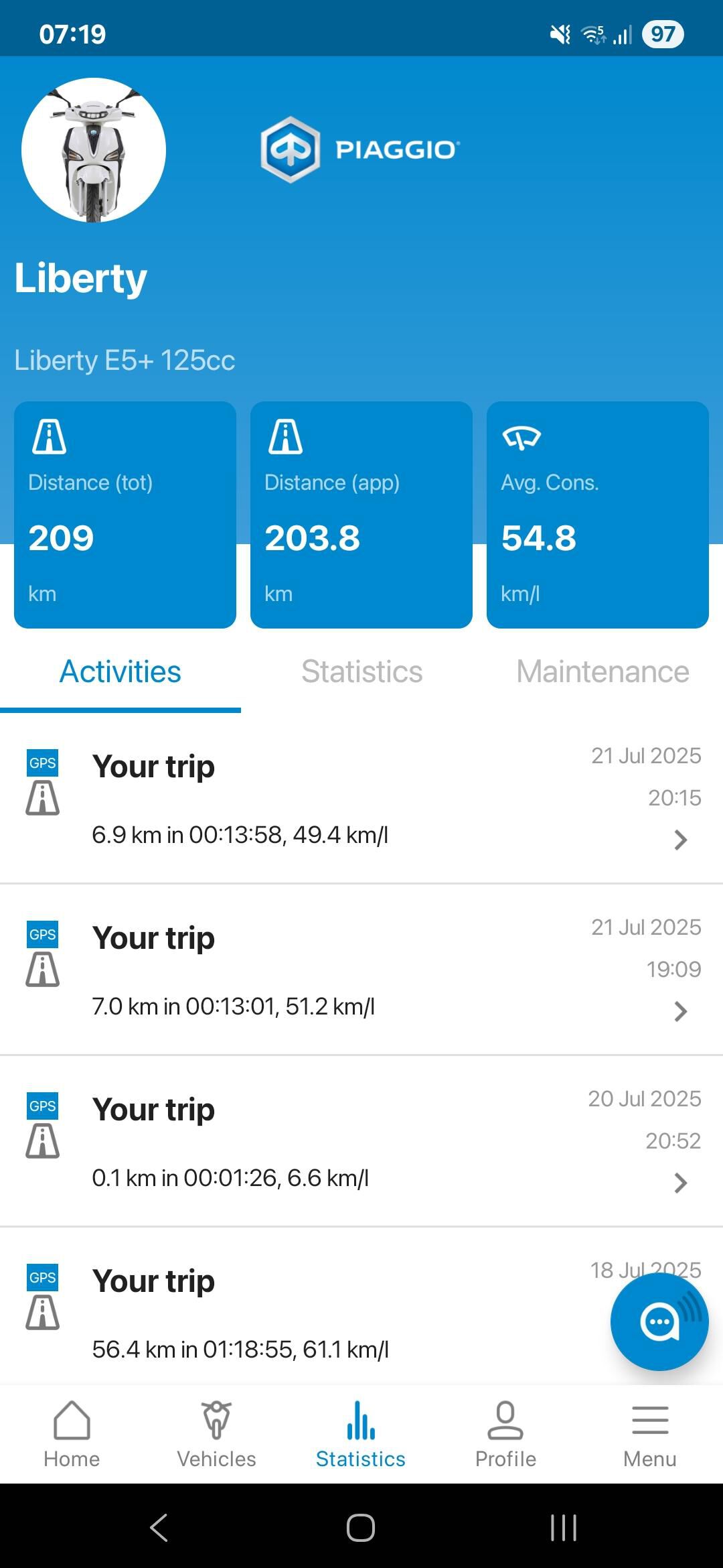

I have also attached a screenshot from my mobile device. It communicates normally with Bluetooth module. I just have to manually connect every time.
OK, I have 'solved' this with Routine (when phone detects my headset, it requests pairing with PMP)

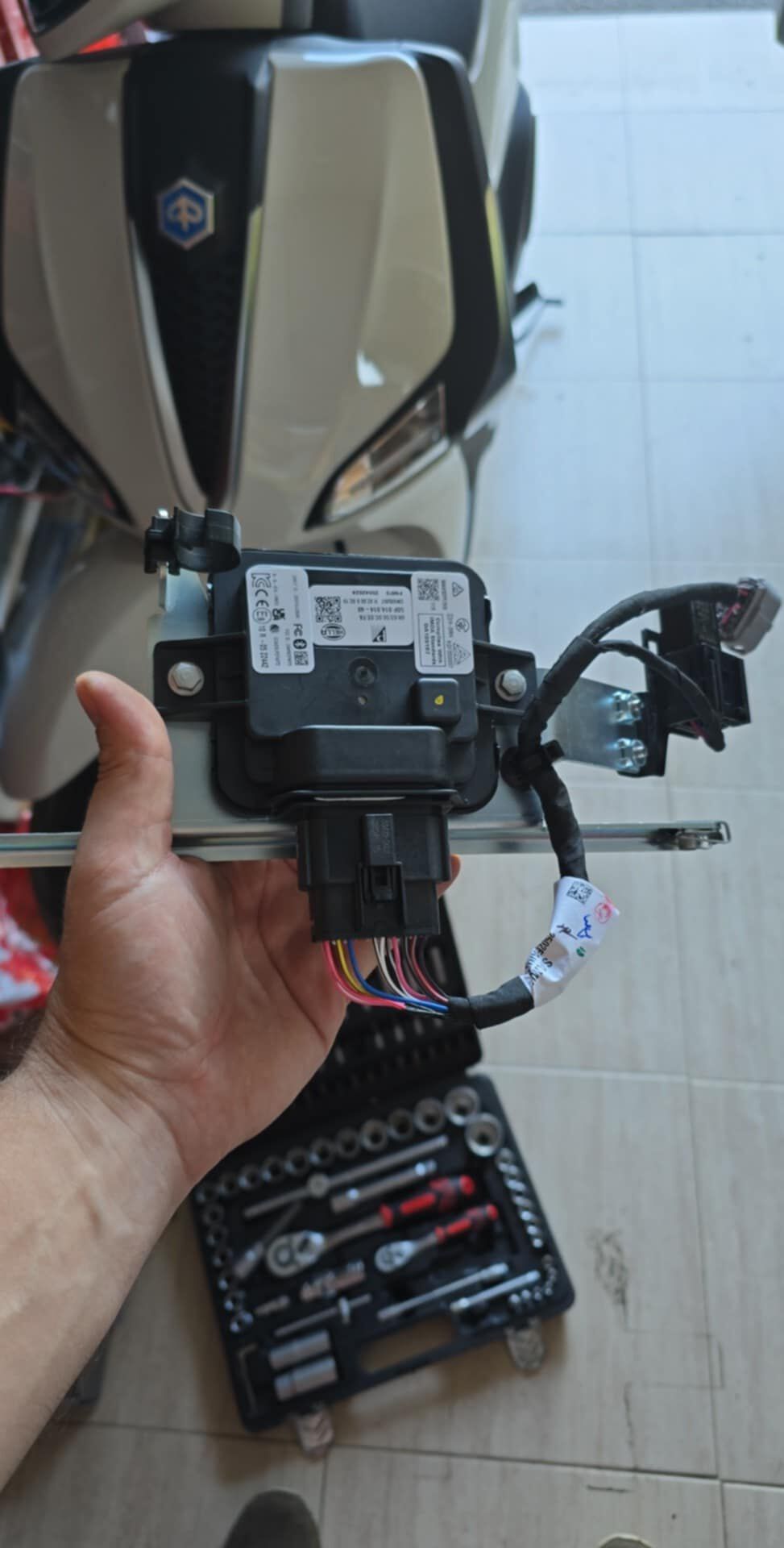

Found a photo of module I installed, it was manufactured 27.07.2024.

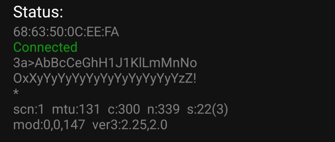

This is some info from SteelBytes app.
Is this firmware info or something similar/helpful?
Snoop
Snoop
Posts: 8862
Posts: 8862
2.25,2.0 Is the firmware/hardware version of the pmp3 module. P.A.D.S should be able to update this but I understand you have checked
147 Is the bike model. I don't know if this is being reported by the ecu OR if it is set in the firmware of each different pmp3 module. It would be interesting to disconnect the ecu and then disconnect and reconnect the battery so the pmp3 looses power (ecu remaining disconnected). Then turn on the ignition and connect vespa snoop. If his number does come from the ecu then I would expect vespa snoop to show 0. If this does not come from the ecu then it would still show 147 and represent which bike the pmp3 firmware is made for.
