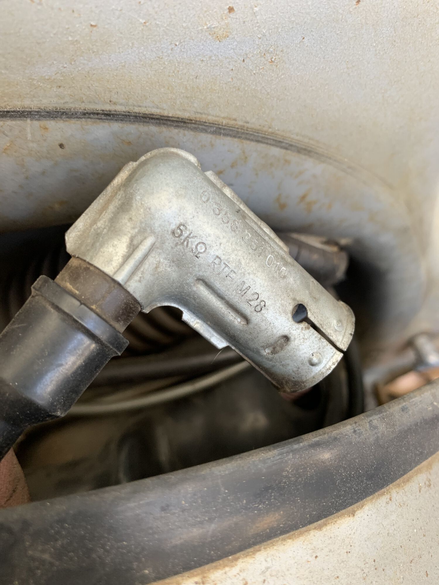

SoCalGuy you are quite right. I have only seen one PX200 but there was Chinese aftermarket cap.
I also got this Grabor cap from an Vespa engine I don't remember. But is it OEM? And is it have resistor?
