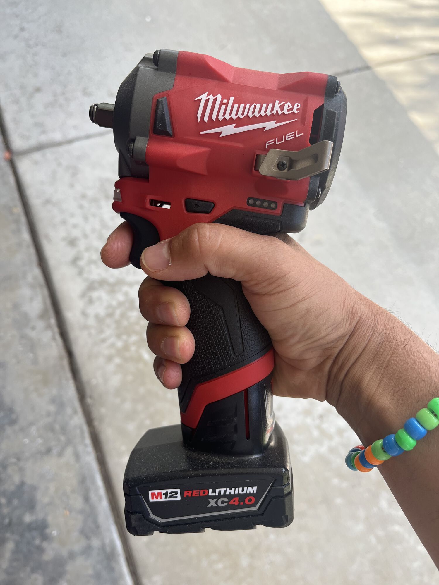

Probably too late for this, but I invested in a battery powered impact wrench during a dirt bike revival project I was working on.
I've spun off so many stubborn bolts with it, it almost feels magical. It's not even a big boy, only 12v.
