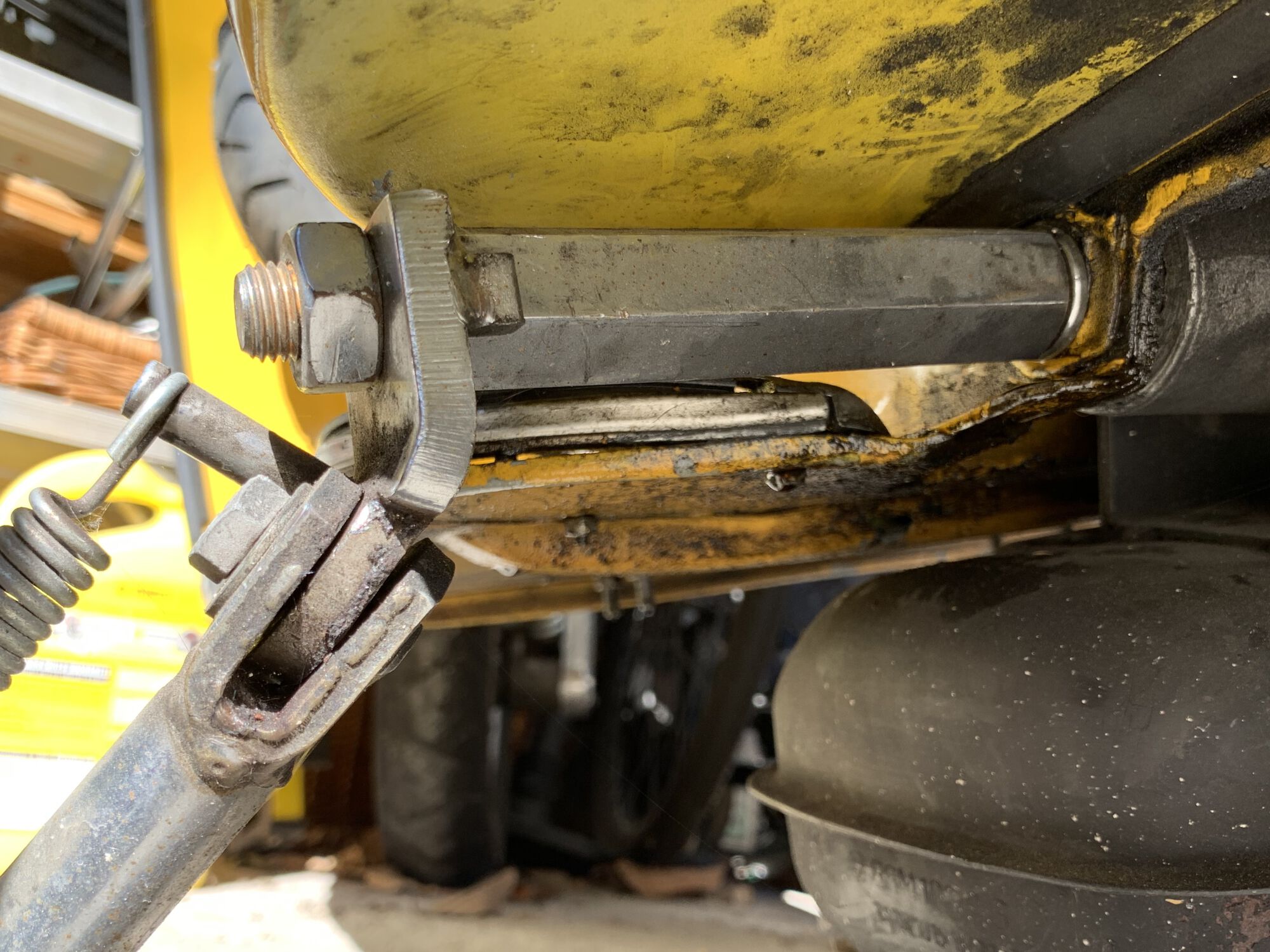

I recently bought a sidestand from an Indian e-bay vendor I've used several times. Instead of attaching under the floorboard, like the SIP sidestands, it looks like it attaches under the left side swingarm nut.
Anybody use one of these before? Anything I need to worry about?

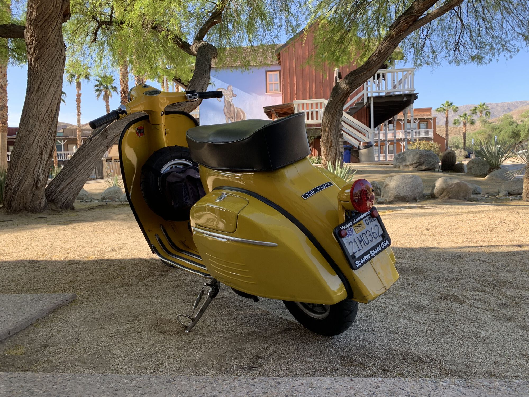

I have a Hurricane sidestand on two of my scoots. Love it. Can't vouch for the e-bay stand, but if it's similar nothing to worry about.
The "long" nut replaces the centerstand nut. Just make sure you torque it down tight - 45-50 ft/lbs and mount the sidestand so that when it's in the up position it's parallel to the ground. Might take a few tries.
excuse the crud
excuse the crud
