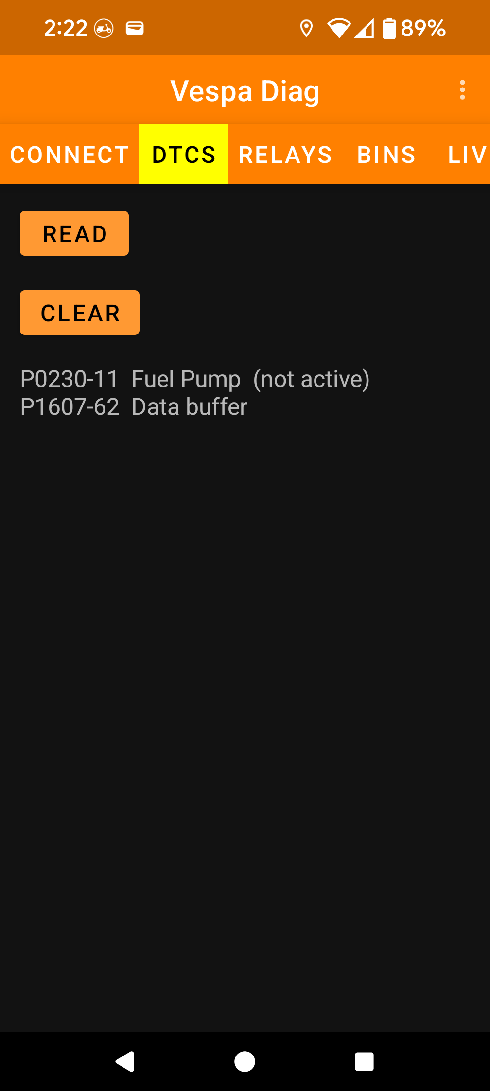

Yeah ... P0230

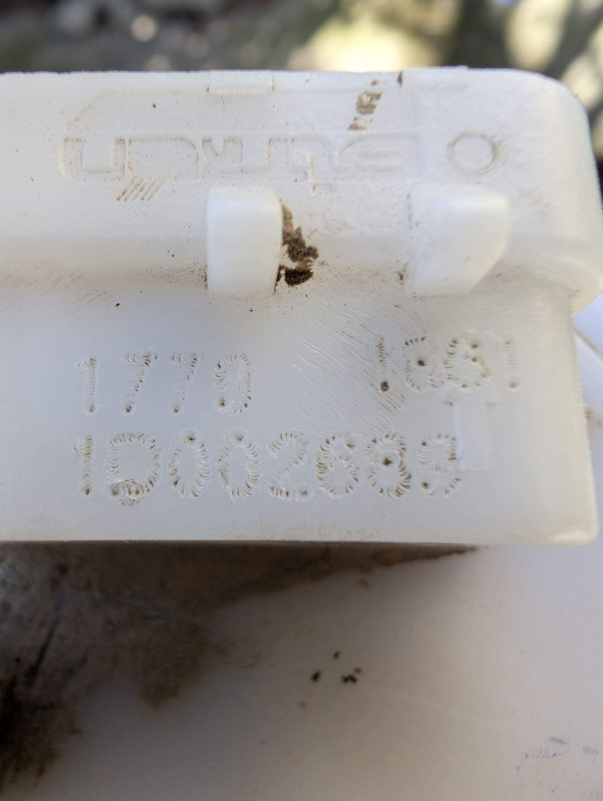

SteelBytes wrote:
My 2019 is not included in the recall. The VIN was checked by the dealer years ago.
I recommend having the VIN checked again, as the recall may have been extended.
In Germany, the serial number of the fuel pump (not the chassis number!) had to be checked at the time to determine whether the pump had been replaced at Piaggio's expense. I assume that Piaggio could not say for sure which batch of pumps had been installed in which vehicles. I would therefore submit a new warranty claim with the serial number of the pump. Maybe you'll get lucky.

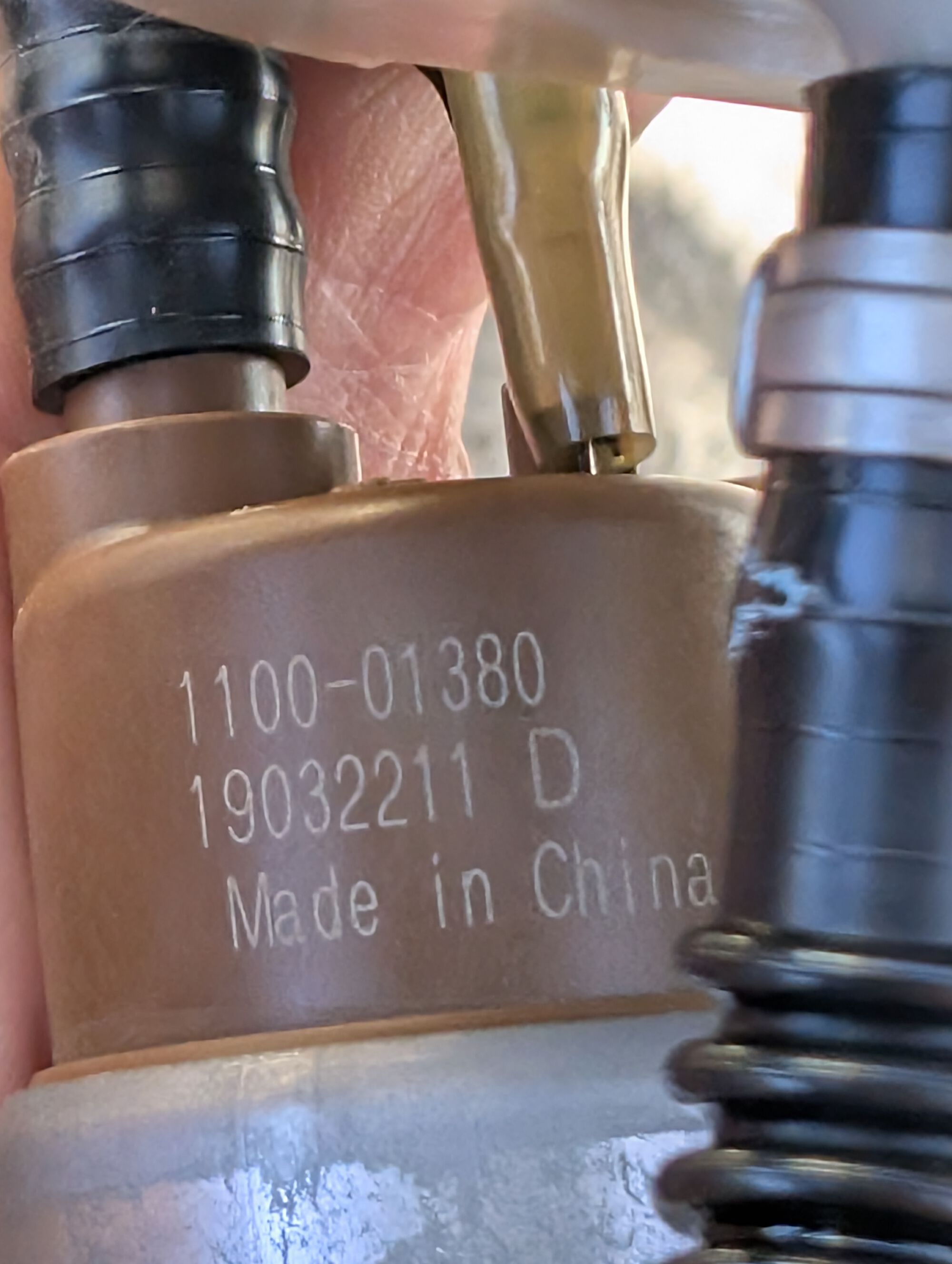

although you're right to ask my dealer I don't think this is it.
I checked the list of VINs on the recall notice (link below) and noted that all the year letters in the vins is 'M". mine is a 'K' so two years earlier.
plus that was for a warm fail and mine is a cold fail - never has failed when warm
https://b2b.psimporters.com.au/DOWNLOADS/Bulletins/Service%20Bulletins/Vespa/PSB61%20-%20Vespa%20GTS%20%20GTV%20Fuel%20pump%20and%20sender%20replacement.pdf

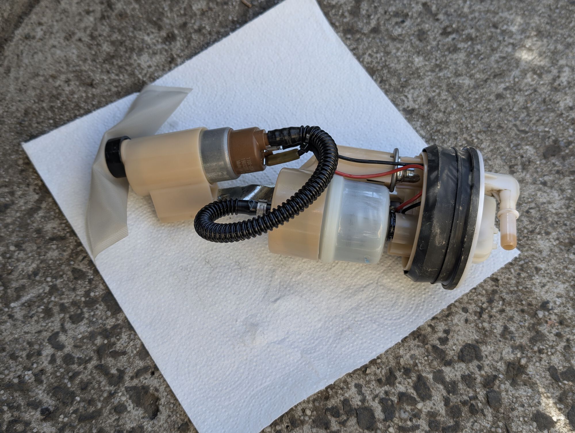

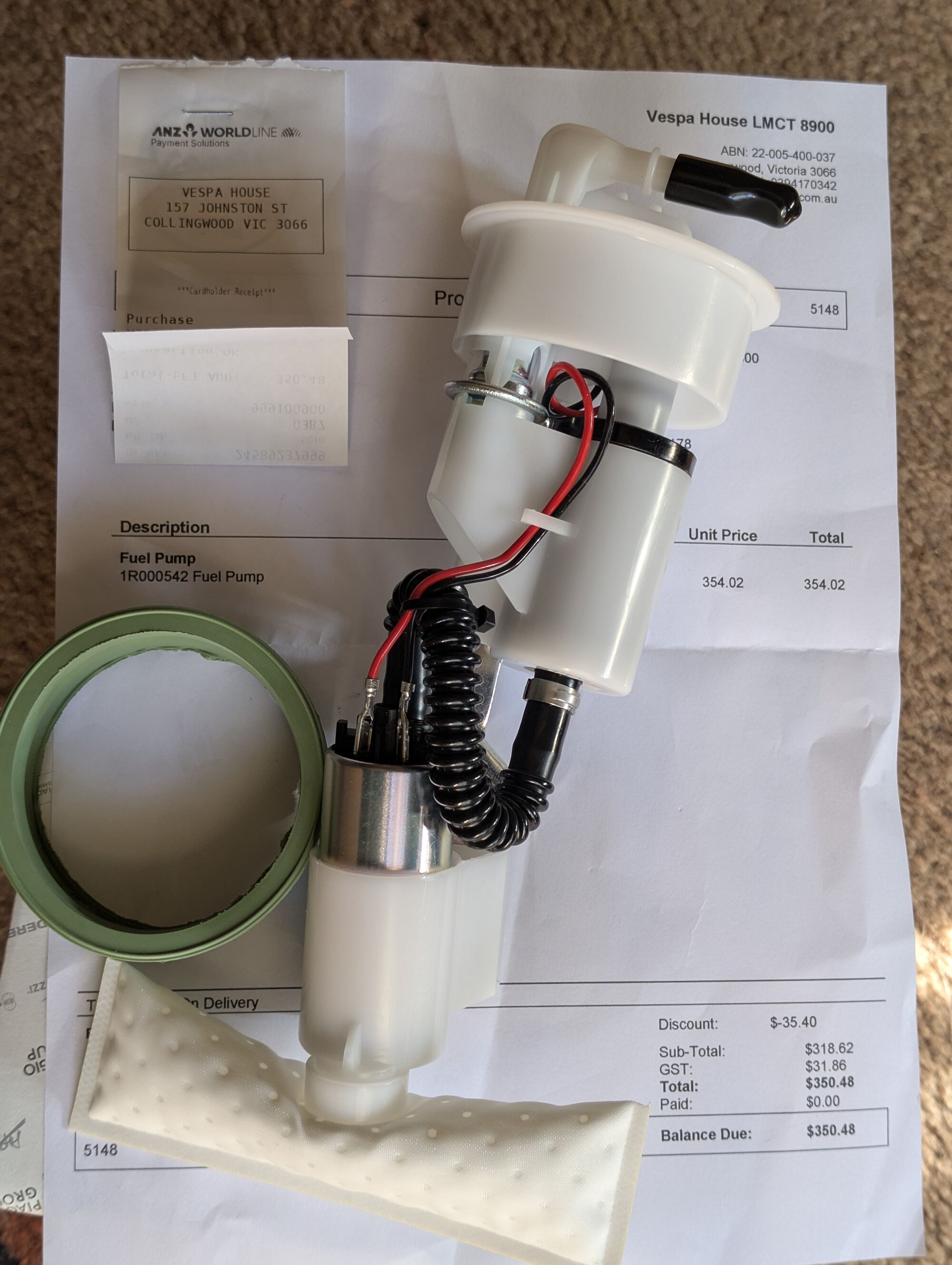

After plenty of Vespa Tetris it is running.
Posts: 8763
Posts: 8763
didn't fix it 🤬

I've also been sometimes getting a P0480 (at the same time as the P0230) which is supposedly for the fan relay. the fan relay is a child of the injection loads relay which is making me wonder if the injection loads relay is the problem
