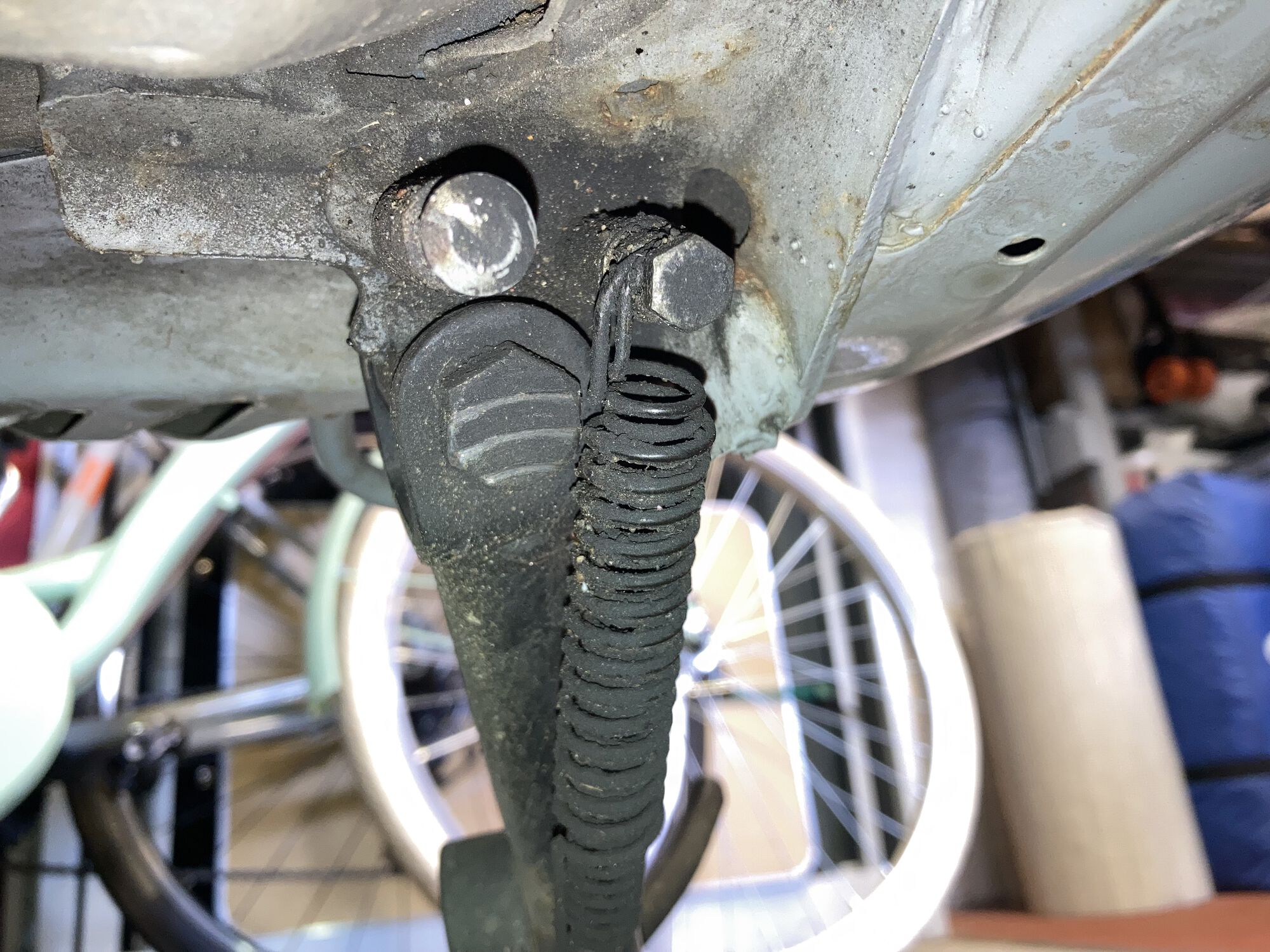

The answer to both questions is no.
Vespa relocated the spring post on the body to the other side of the pivot on later models.
Fix is intuitive, spring post on one side of pivot, stand retracts. other side stand stays down. Lots of pics of different execution on various threads on here.

This is what I did to my 2007 GT(V) some years ago, think I had to drill the hole and used a bolt with a nut either side with the thread showing. I must have tried the existing hole lower down but presumably it didn't work. The spring rubs on the pivot bolt but you can't have everything. It has caught me out once or twice, fortunately before I left the driveway 😯
