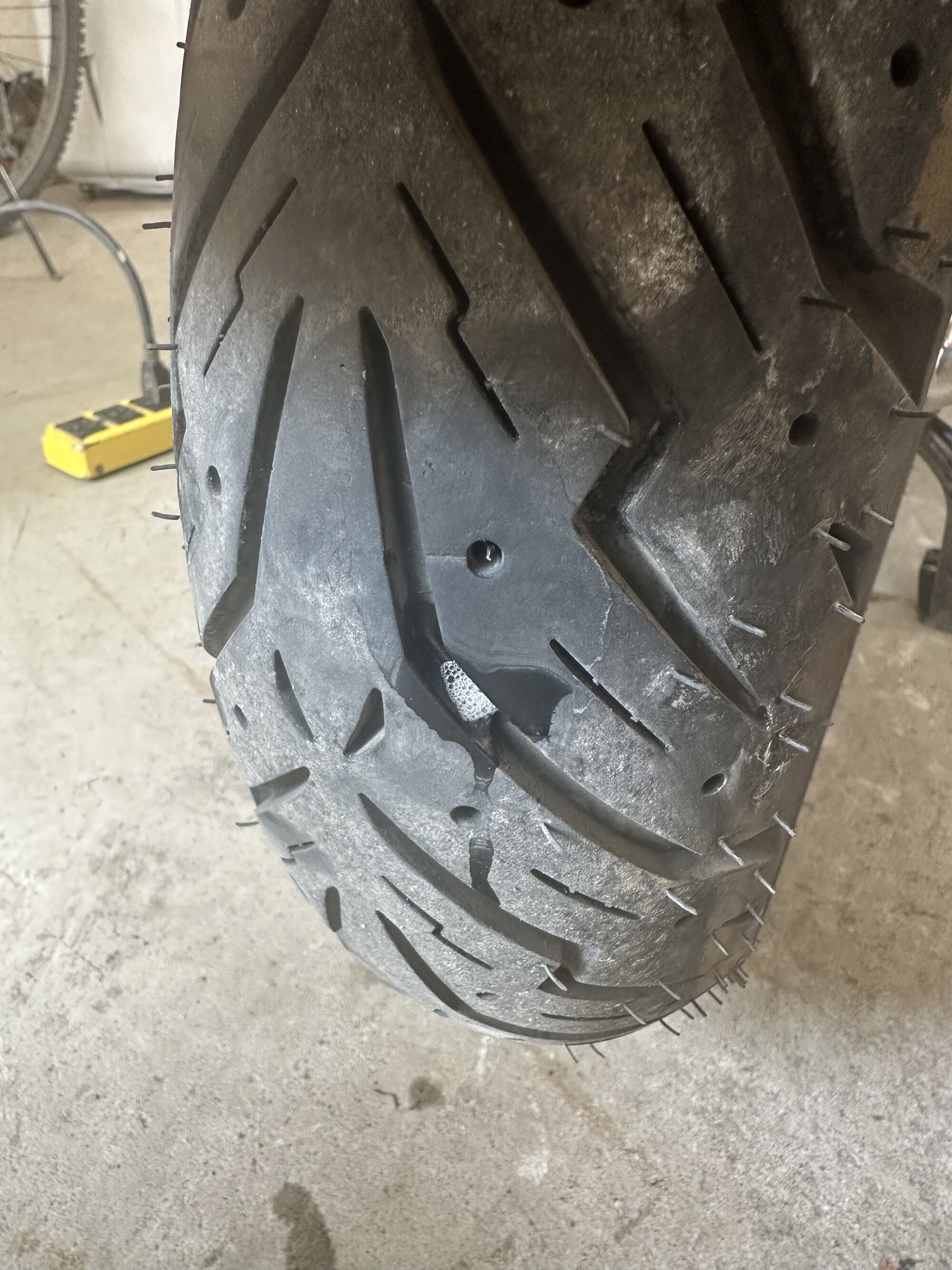

Hello everyone,
I just noticed that the rear tire of my Vespa Elettrica was almost flat (it was down to 15 PSI instead of the recommended 36 PSI).
I found a staple (see photo) stuck in one of the tread grooves. When I tried to remove it, it broke and part of it stayed lodged in the tire.
I assume it should be repairable, but since the puncture is inside a groove, I'm not sure if a plug kit would work in that spot, especially since I've never done it before.
The scooter is brand new, so I'm a bit hesitant.
Do you think this kind of puncture can be repaired with a plug or tire repair kit or should I bring it to the dealer?
Would love to hear your thoughts!
staple in rear tire.

Yep,
sticky rope, easy. If you don't know how, since you've not done it before, watch a couple YT videos. You'll wonder why you didn't learn to do it before.

If you plug it, keep that in mind the rest of the tires life and keep a good eye on tire pressure. Especially for the first few weeks after plugging, to make sure there is no slow leak.
Do not use a mushroom plug, they can push out/into the tire on gravel.
Posts: 46190
Posts: 46190
As above - use a sticky string plug. The golden rule with those is Don't Twist It inserting it or when yanking out the insertion tool. It'll almost certainly be fine for the life of the tyre.

Thank you all for your tips.
I gave it a try and tried to respect the golden rule as much as I could.
On YT videos, some people leave about 5 mm of excess plug sticking out, while others cut it flush with the tire.
I decided to leave a bit of extra material.
After inflating the tire, no more bubbles. 🤞.
I'll check the pressure on a regular basis.
Again, thank you all.

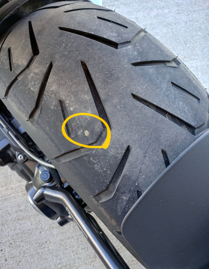

I picked up a nail in the rear tire of my Rocket 3R last year and used a sticky string plug in it. First time I ever plugged a motorcycle tire, and I was justifiability concerned about it, but the plug worked very well with zero pressure leakage, and the tire went another 4000 miles before I replaced it several months ago.
At one point, I forgot that it was a plugged tire and hit 120 mph on the bike in a fit of acceleration exuberance, but because I'm writing this now, it's obvious that the plug held.
The nail...
