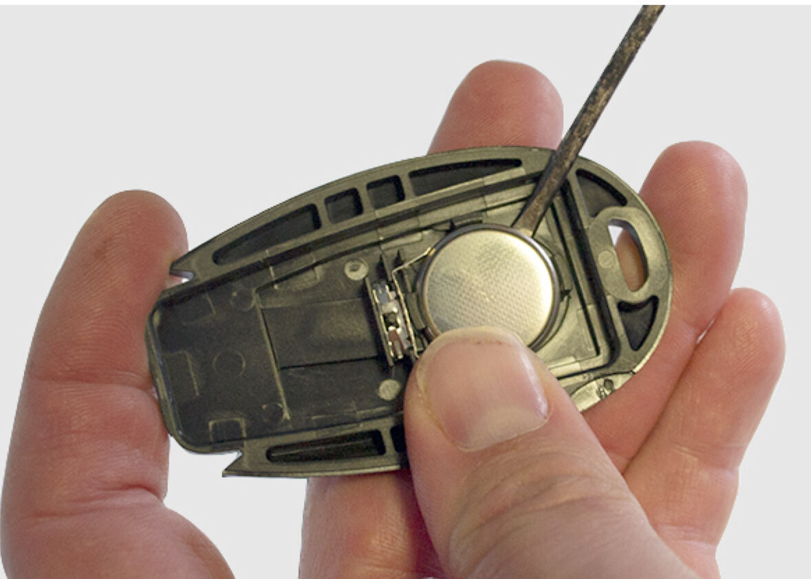

JPMScoot wrote:
I have changed the battery again no joy,
there are no lights coming on in the key,
Measure the battery (or put it in another device) to make sure it has enough juice.
Are you sure it is inserted the right way top/down (see picture)?
Do the terminals make contact with the battery and are they clean?
The correct type is a 3V button cell CR2032.
