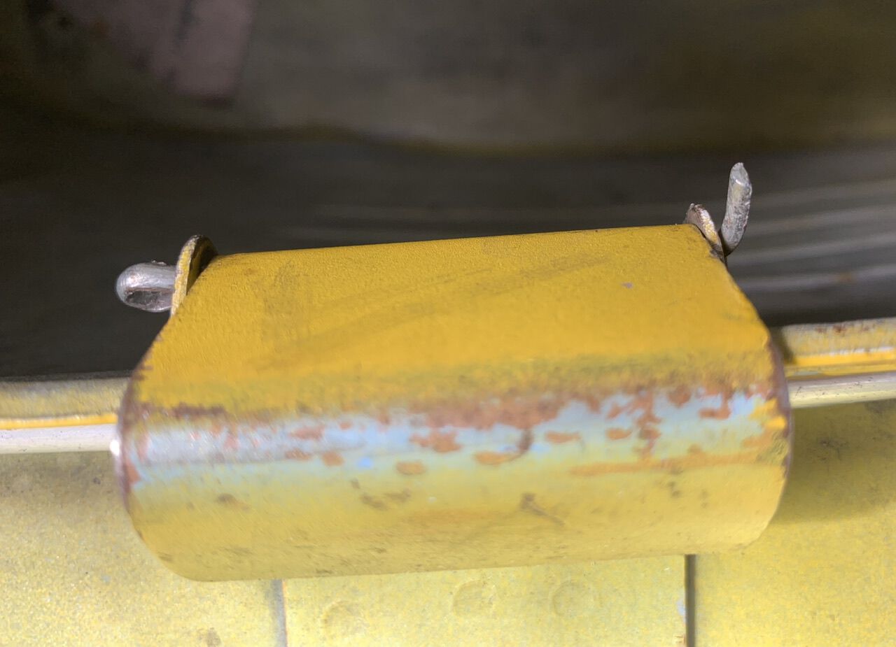

There's gotta be something better than a cotter pin to hold this on.
Never gave it much thought before, but giving the Yellow Beast some love and de-rattlization.
Skinny bolt? What all do you use here?

I'd lean towards some sort of clevis pin, unless you can find a bolt with a long shoulder. Wouldn't want the threads gouging away the hinge from the inside.
Maybe use a C- or E-clip on the end of the pin to keep things tidy

get a bit of metal rod and then just bend it over on both sides? That's basically what the Lammy glovebox hinge pin is.

One of mine has a framing nail… that's how it came to me.

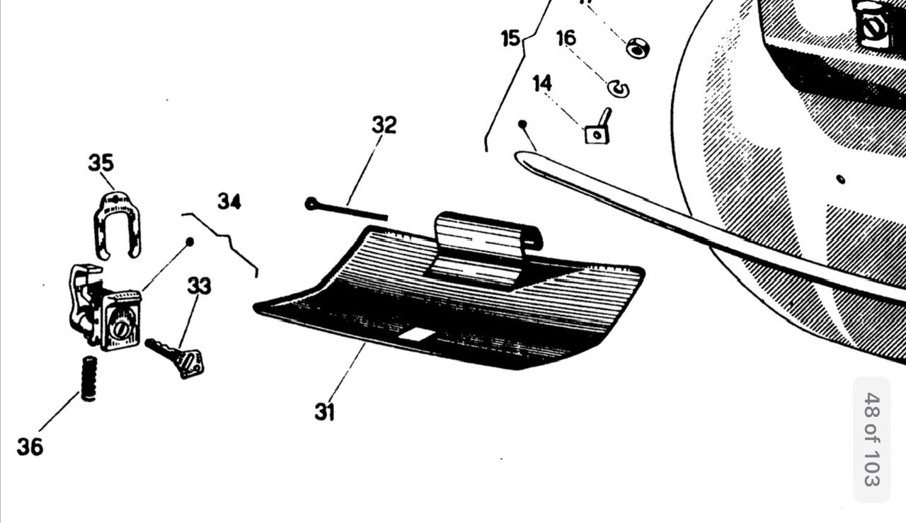

Parts book shows a split pin but I can't find one that takes up the slack. The right diameter metal rod or framing nail might actually work better.

Honestly though it does work better than the split pin, so I left it in there.

What in the world is wrong with using the split pin?

It rattles like a mofo

I used threaded rod with a nyloc on each end. Can put a bit of tension on it.
