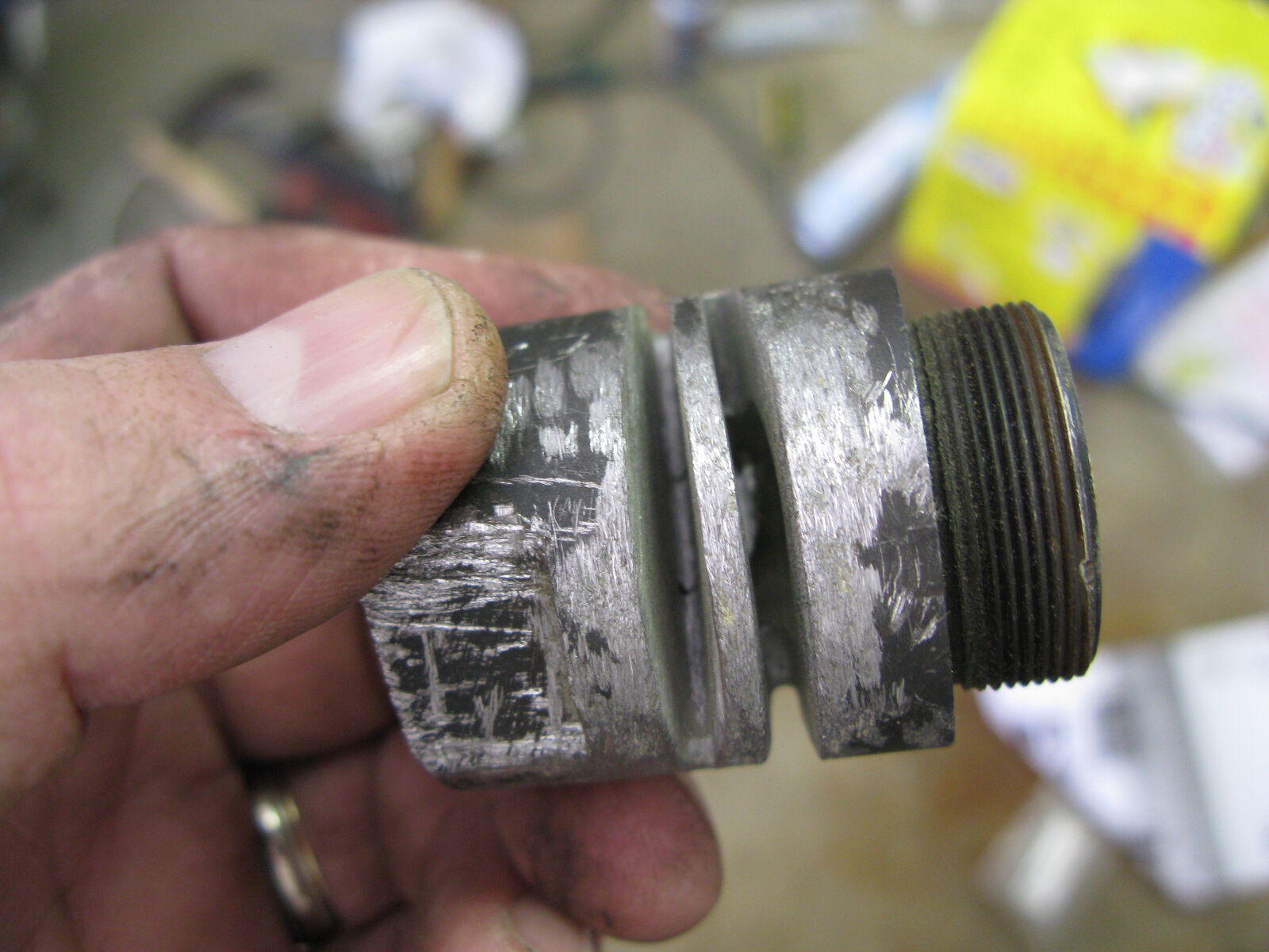

chandlerman you are right! It is the puller that has damaged threads and not the flywheel. Having a proper look in broad daylight rather than half light in my shed (and not jumping to conclusions) are my two takeaways!
So plan is to get an new puller and try again but with some heat applied.
Not sure where to go regarding new puller as hesitant to buy the same again. Maybe I'll just try a different one from a different seller.
Expect another post describing further failure in a few days
As bad news goes, that's good news.
Like I said, the puller is softer steel than the flywheel so that if something fails, it will be the puller.
When you try again, make sure that you have the puller screwed all the way in. you can see there's about a centimeter worth of threads in the flywheel, so use a pair of large pliers or a wrench to tighten the puller until it seats, then back it off about 1/4-1/2 turn.
Tighten the puller down and it should break the seating of the flywheel on the taper pretty quickly. If it doesn't, you can try rapping the puller with a hammer to see if that will free it.
You can also try heating the flywheel center with a torch, then quickly install the puller and possibly try rapping it with a hammer. Make sure you're really comfortable with fully installing the puller before you try to do it quickly, though.
The first time I ever tried to remove a flywheel, the extractor bolt sheared off under tension and I had to cut the entire puller off before I could even remove it. That was an older design of puller with a narrow extractor bolt.
I wouldn't worry about that happening to you, but it's a good reminder that while these things can be (and usually are) pretty easy to work on once you start to know what you're doing, but can be incredibly frustrating at the most inopportune times, too.

Make sure the extractor bolt is fully unthreaded for the puller before you thread the puller into the flywheel so that the puller threads are fully threaded into the flywheel threads before the extraction bolt bottoms out onto the crankshaft.

I had a similar issue about 6 months ago on a bike I bought from evilbay. The crank and taper had never been apart or lubed in its 10 years, therfore it had rust welded itself together and I ended up removing the rivets tnat held it onto the boss with an angle grinder and ultimately cutting it off with a 1mm cutting disk... I lost the flywheel, crank and stator
If I had ro do this again, I would remove the engine from the frame and soak the flywheel et al in a container filled with rust remover for a long time - think a few days - then try again
Think laying it on its side into the solution and you get the idea
I can heartily recommend the following as a superb rust remover. Just clean as much oil and grime as you can from the engine first before you immerse tje flywheel side in the solution

Gravelrash2004 wrote:
...If I had ro do this again, I would remove the engine from the frame and soak the flywheel...
Maybe Acetone + ATF, 1:1 ratio.
I don't necessarily disagree, but recall this dude had never touched a wrench before he took this on. He's doing great, even if he got off to a bit of a rough start.

I've got a new SIP puller, knowing SIP stuff has a good reputation. It feels a bit more substantial than the wrecked one.
Positive: it screws in fully and feels totally solid. Seemingly haven't damaged the threads on the flywheel.
Negative. I've not really gone at it. (It's not the right time when I'm knackered and impatient after work.) But it's still not budging, even after a few taps on the bolt. So Friday/Saturday I'll get some heat on it and try some more.
chandlerman - can't I get heat on it with the puller in place and under tension?
Gravelrash2004 - really appreciate the offer to pm.

Sounds like probable progress.
You can absolutely try adding heat with the puller in place. Can't hurt, and the worst thing that will happen (short of melting it all into a lump) is that it doesn't work.
The hard part of adding heat with the puller in place is that there are already a lot of heat sinks going on there, making it harder to add enough heat to be effective.

So I bought a blow torch and went through two rounds of heating and allowing to cool (the second one with the puller in place tight - thinking as everything cools and contracts it could put some nice gentle pressure on it).
When mostly cooled for the second time I tightened the puller and PING! - the damn thing was off. What a satisfying sound. The cone and shaft were clean as a whistle - was expecting some corrosion or similar binding it in place.
Stator plate swapped out in minutes, reassembly only a few more minutes (using a torque wrench for the first time in my life).
And it fired on second kick! I almost wept with joy.
Might be idling a touch lean so will adjust in the morning and take for a longish ride, pull the plug and start quizzing everyone about jetting (which I wasn't convinced was right before this episode).
Thanks everyone who helped for their help. Confidence and knowledge both boosted.
