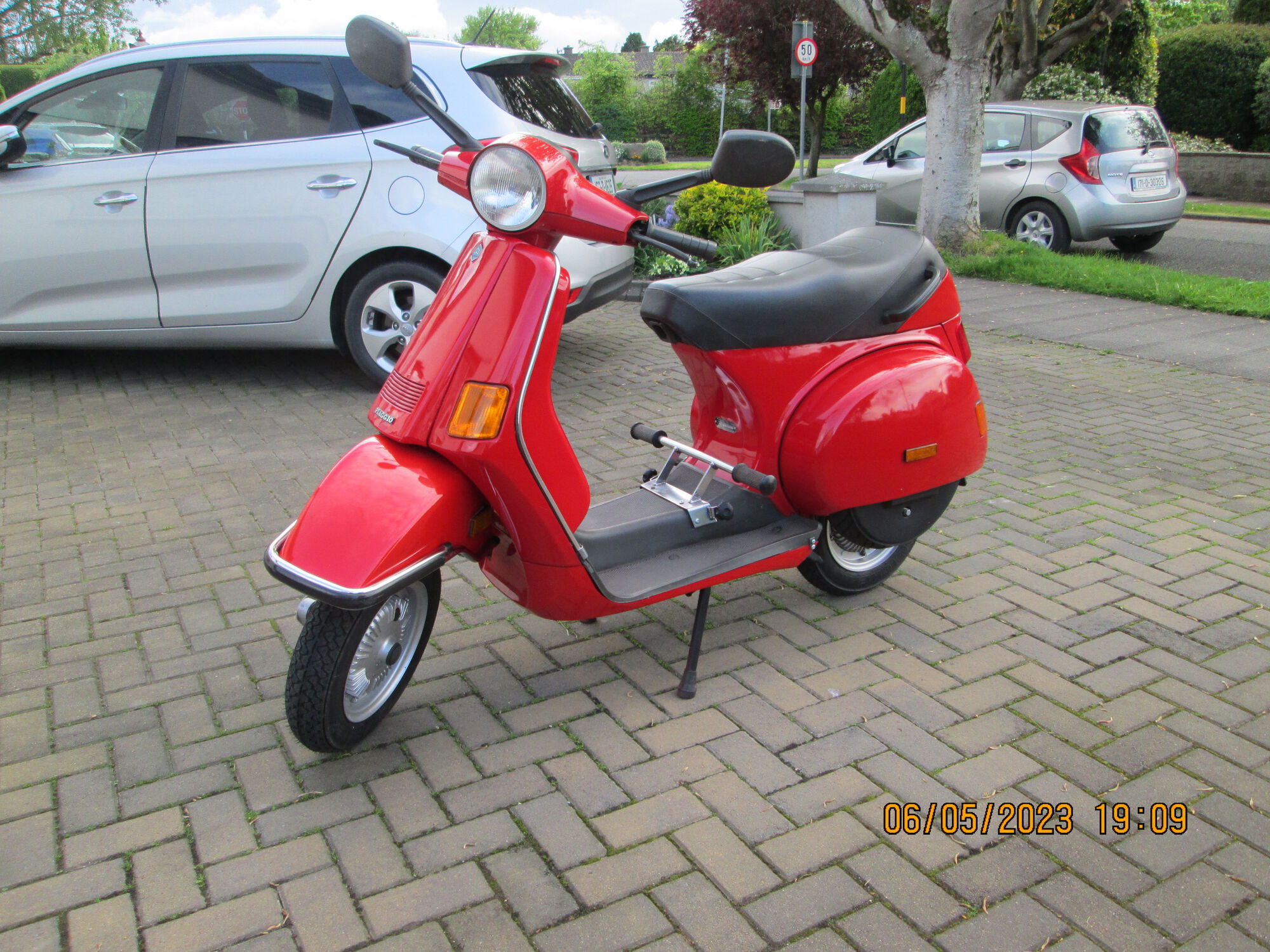

Ireland? Many Cosas there? How about a few pics of your bike w/ some local scenery?

Many thanks for your reply. Due to the very awkward access I decided to get a Vespa restore dealer to do the job.
There are very few Cosas in Ireland, but brakes aside its very similar to a Px200 so other maintenance is not a big problem. Spares are becoming scarce however.

Wow looking at that now you can really see the transition to modern day Vespa's cool scoot.
