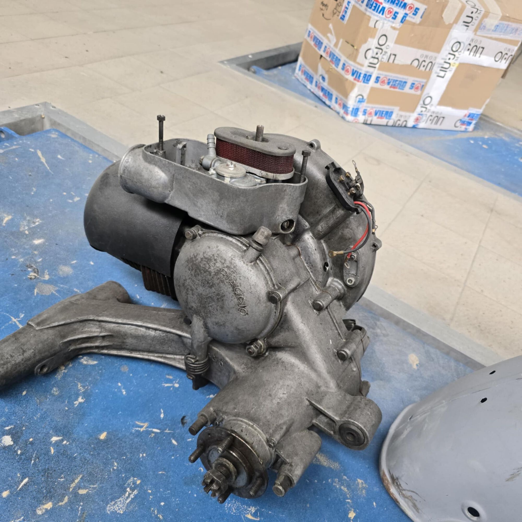

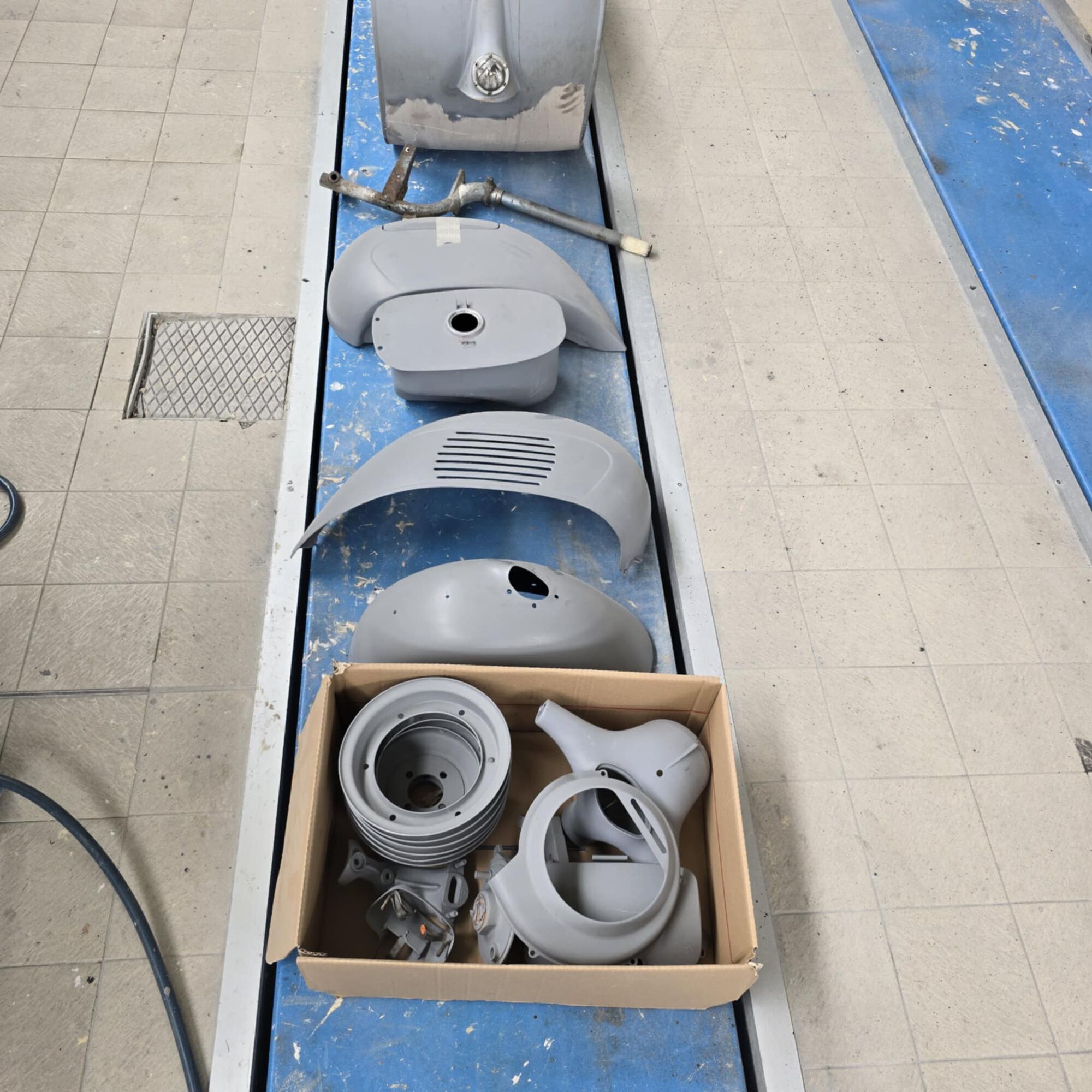

But it says 7 ports? I really don't want to drill my engine. I am already thinking I am over my head with this whole thing. Please advice. Also ALL tips are welcome (just getting my bike license) since I have knowledge in cars, printing, general engineering and electrics (Physics in the uni and all) but never ever have even driven a bike. Adding a few photos of what I've got.

For the cylinder kit it depends on if you have a 2 port or 3 port engine block.
If it's 2 port the Pinasco is fine, BUT Jon Gick posted recently that VMC is releasing a 2 port top end. The Stelvio could work but you would need to block off the third port in the cylinder. Jon Gick posted recently that VMC is releasing a 2 port top end. I'd wait for that personally.
If it's a 3 port engine case…. Then absolutely go with the VMC Stelvio. It's an absolute monster. And can't beat the price.
Just reread your post. You have the 2 port engine. So Pinasco or wait for the new 2 port VMC.

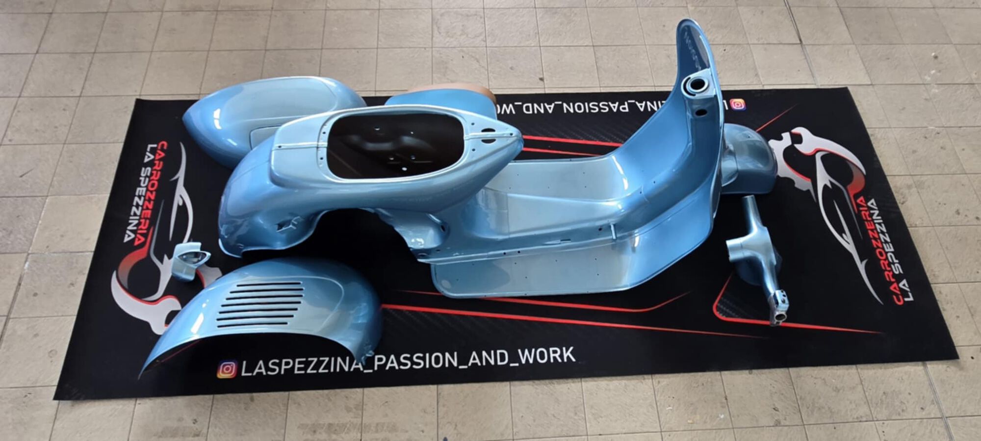

Paint job is ready and I think it turned out beautiful!
Absolutely!
