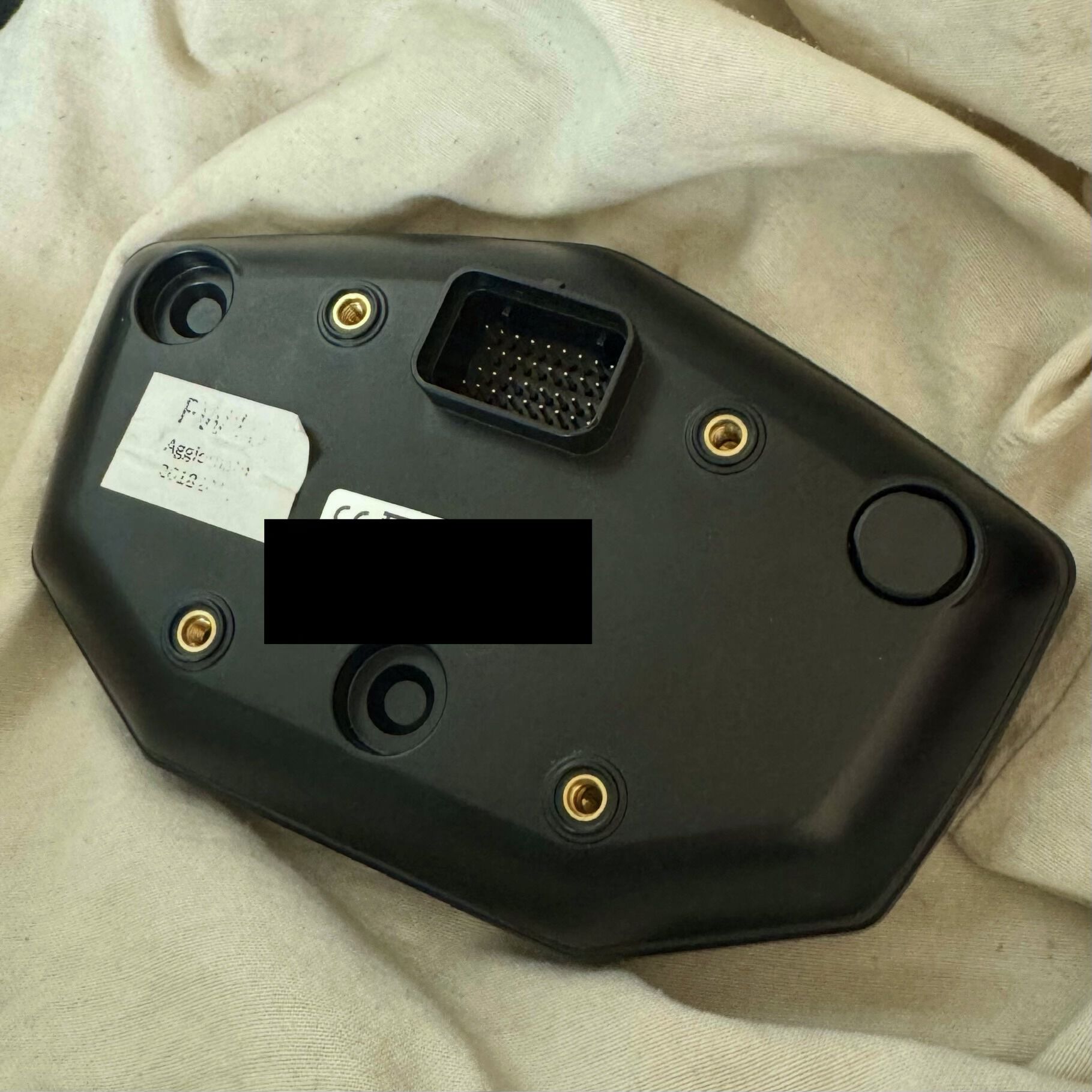

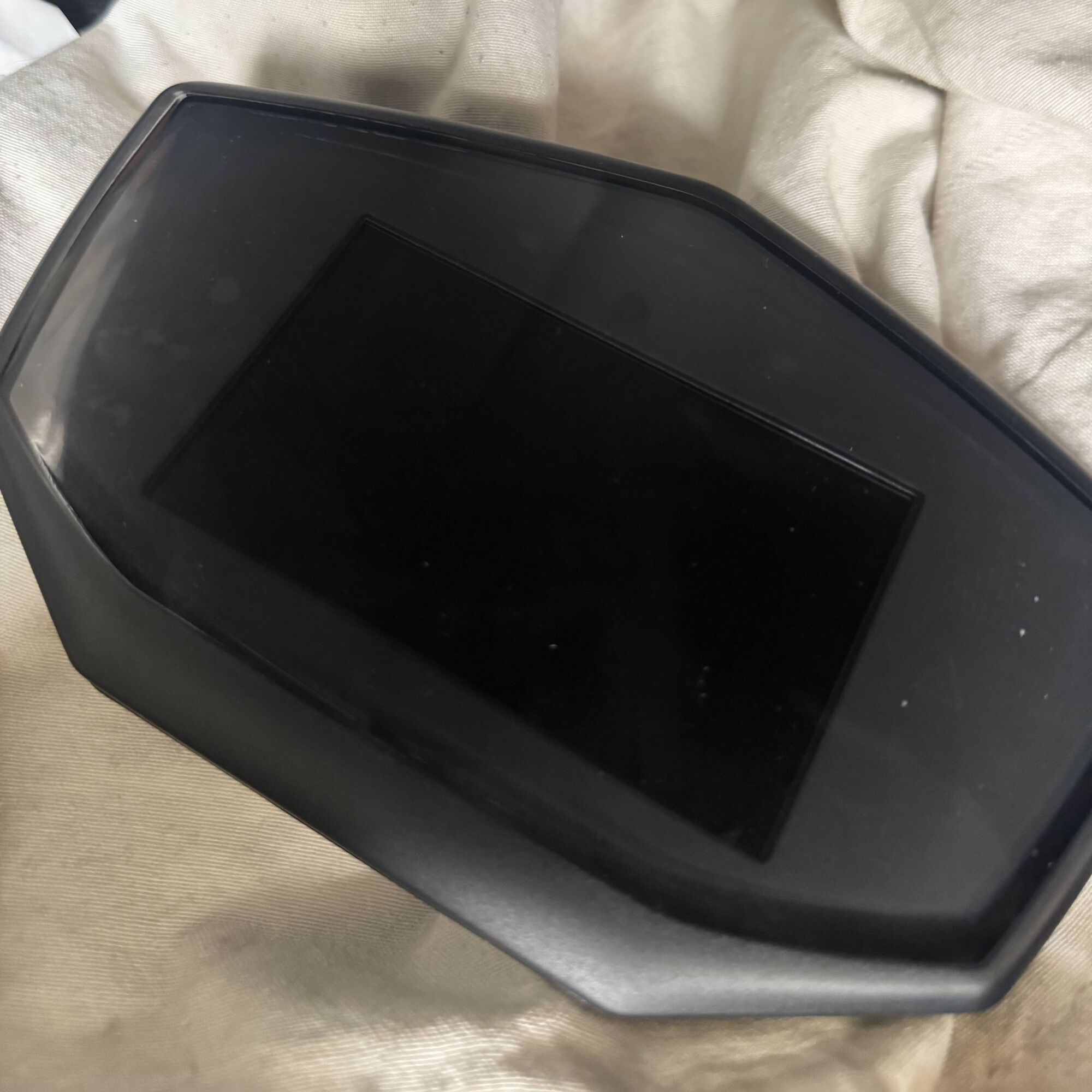

After several days of checking every cable and parts, I discovered that the instrument cluster (oem 1D002094) was causing the blown fuse.
Dealership of course suggested to replace it entirely, but I don't want to give up that easily.
I took it to an electronics shop hoping to have the PCB checked, but the owner didn't managed to pry it open (heat gun at 350°C / 660°F started to melt the plastic casing Laughing emoticon ).
Does one know if opening it is even feasible ?

As you'd have to replace it anyway if you can't open it - I'd try cutting it open by carefully using a hacksaw blade all the way round.
Good luck - I hope it isn't all encapsulated inside.

Thanks to Steelbytes, I now know that the lower and upper end are glued together.
We'll try to find a workaround cutting it open...
