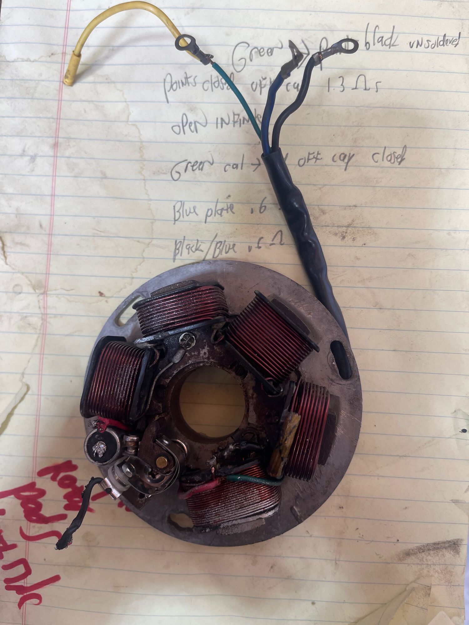

Need help. No spark. Good plugs good points gaped new plugs think I have a ground somewhere. I have a pic of the stator. Does anybody know what the resistances should be between the 3 wires? Capacitor checks good. Also has a voltage regulator in the left fender box. Does that mean it has a battery? If so where is the battery. Thanks for any help![img][/img]

Here is a good place to start: https://scooterhelp.com/electrics/60.elec.html
Also, where is the red wire for the kill switch? That could be your no-spark issue.

That ain't no 1965 stator... Looks very P125X. Things are getting interesting.
they painted the flywheel as seen by the overspray on the coils.
Agreed. Too many coils for a start!

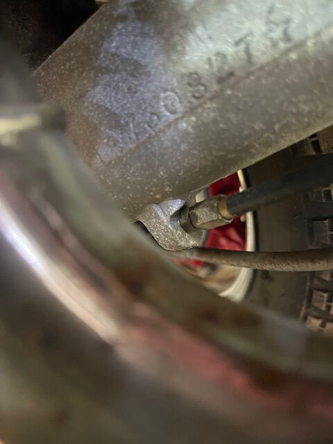

*730827* is the engine number by the exhaust

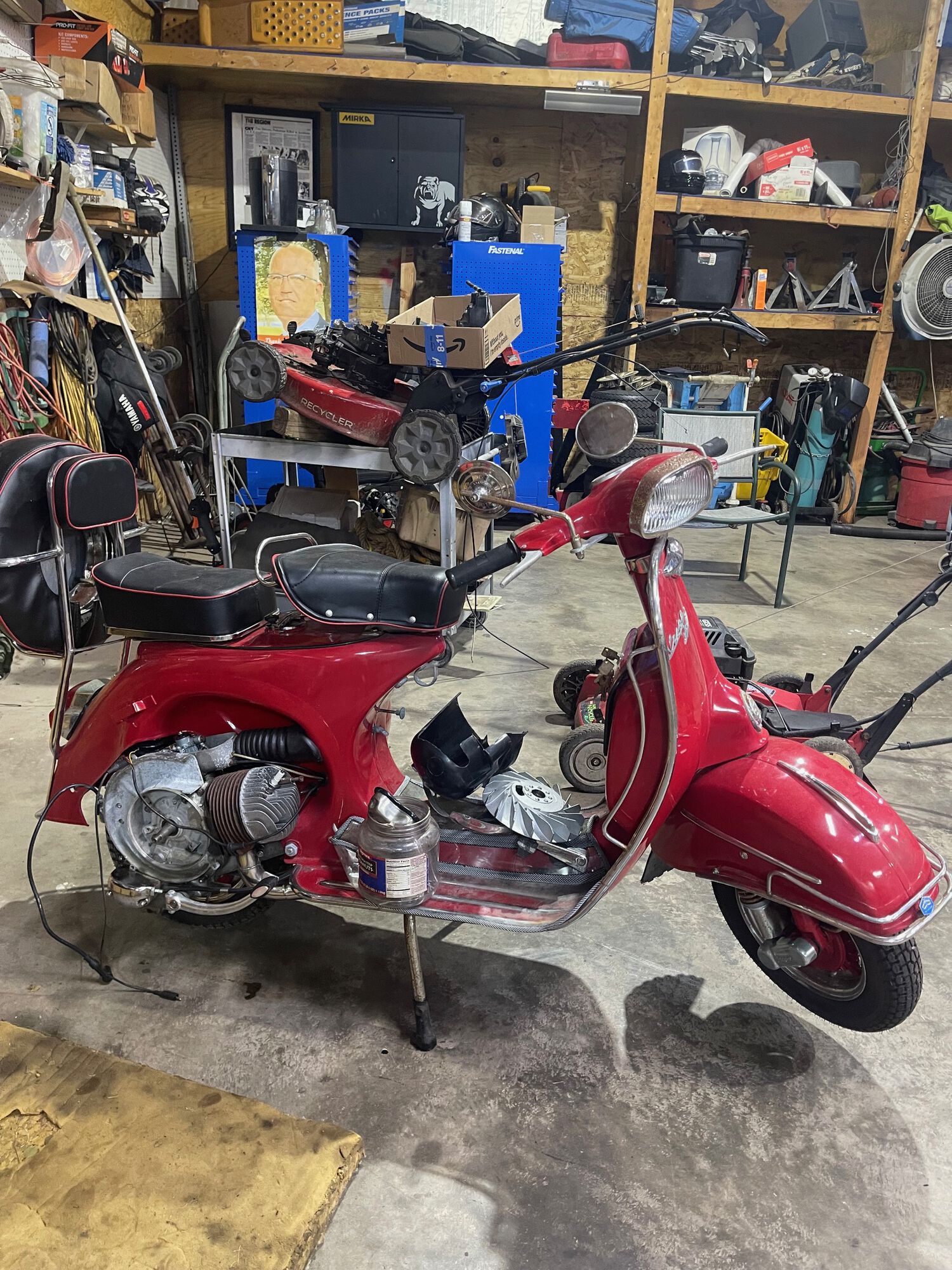

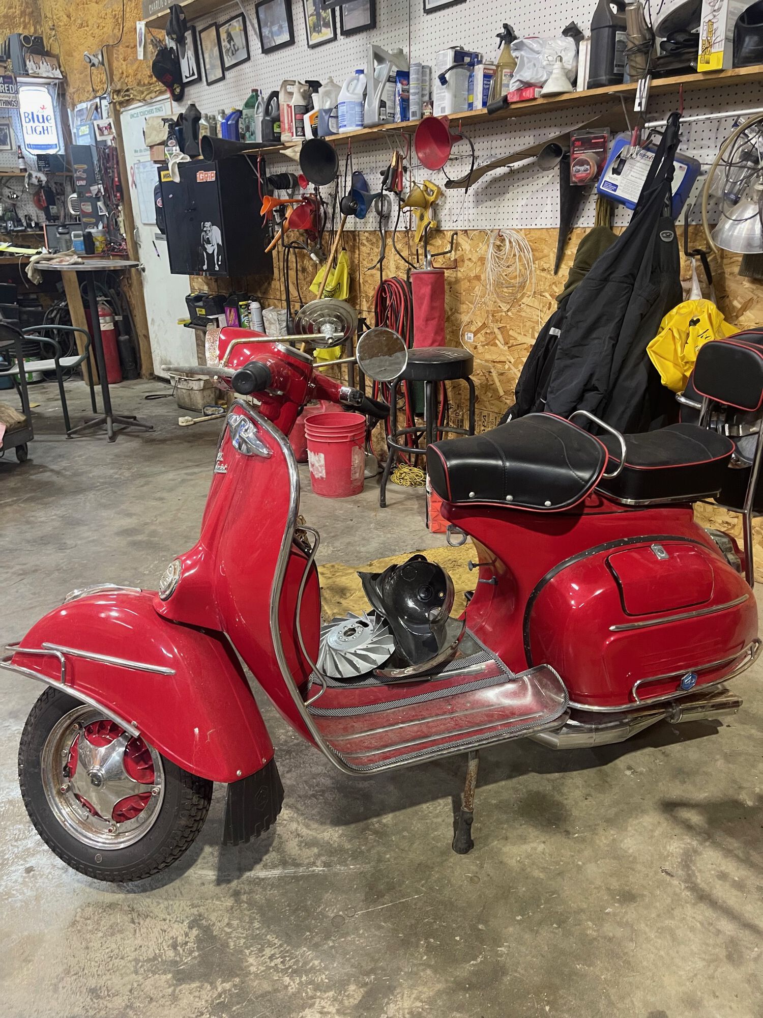

Got some pics[/img]

Do you know its history at all? and, how long have you had it?
@vma1racer avatar
Posts: 301
Location: Ohio USA
@vma1racer avatar
Posts: 301
Location: Ohio USA
Ok, things are officially "interesting".
"She's a beaut, Clark."
HEAVILY modified!
Exactly where I was heading with my leading question to post some pics. Interesting indeed.

Send a borescope up the frame tunnel before riding?
Make sure there's a cotter pin holding the rear wheel on too!

Im the retired back yard mechanic that my buddy drops off stuff. I have zero idea about any history on this or does he. I will check out those issues you guys spoke of. Now how about the ignition conversion? One last thing the " heavily modified " text. Can you explain this? Thanks a ton to all of you!!!

Short answer: The scooter appears to be one of the Indian or Indonesian 'restorations' put together using inexpensive reproduction parts, dressed up with chrome accessories and painted a shiny color to attract unknowing buyers.
For example, 1966 Sprints never came with a glove box behind the legshield. The ignitions are notoriously unreliable. If you look inside the tunnel, you'll probably find some unusual welds.
Scoots like these usually end up being one headache after another. Sorry.

every VN large frame i have ever seen has the main engine bolt going in the opposite way of factory, this on is no different.
The over spray on the coils gave me those VN vibes.
So, who's paying for your tuition? The learning curve is long and steep, but with the right attitude and aptitude you'll definitely learn some stuff.
It definitely takes a special "backyard mechanic" to take on this kind of challenge and not have it be a friendship ruining project.
Time to do some learnin'.
All the good S.E.A. bikes stay in S.E.A...

Post a pic of the engine numbers. Let's figure out what you have.

730827 is the number by the muffler

There should be a Piaggio logo and "VLB1M" stamped above the number (if it's a Sprint engine)

VNX1?

Hard to read, maybe you could use a soft brush or some steel wool to reveal the engine prefix (above the numbers)

The stator *looks* like a non-battery p125x stator (not common to the USA). So looking at a non-battery P series wiring diagram would be a start. Getting what you have to work by making that stator still be part of the bike rather than re-reengineering the system will at least get you going. If you can't understand what's there how will you get a completely different system working?
The learning curve is getting steeper, but if you have the reference materials to learn the basics of how things should be you'll figure out how things want to be.
There is no "just do this" solution without some extra effort on your part.
I'd love to see the rest of the wiring for a start.
