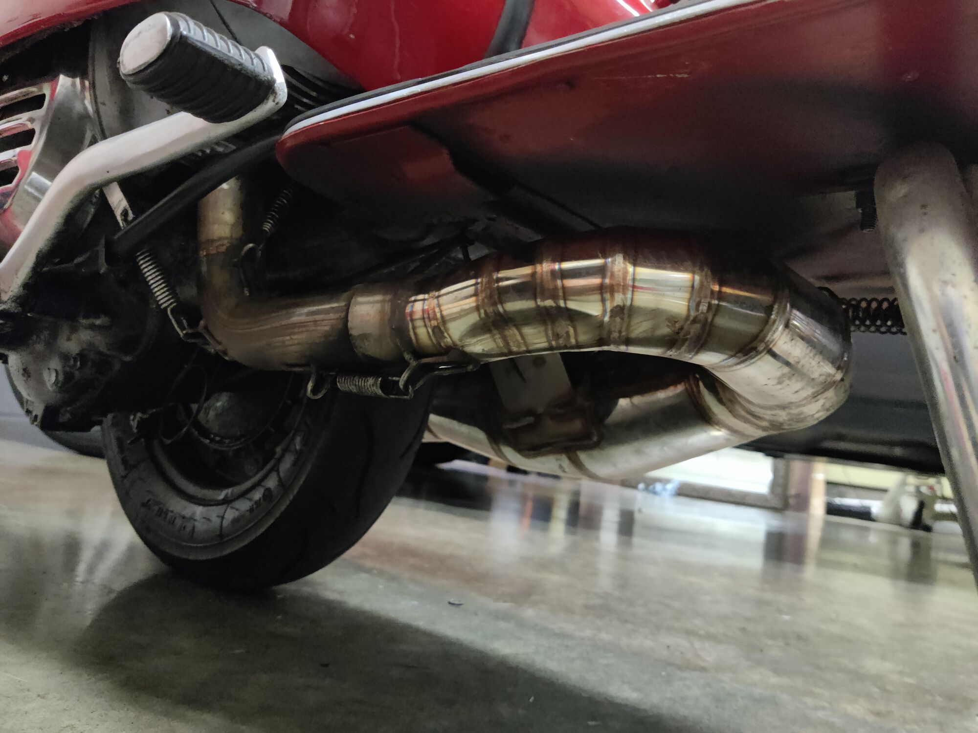

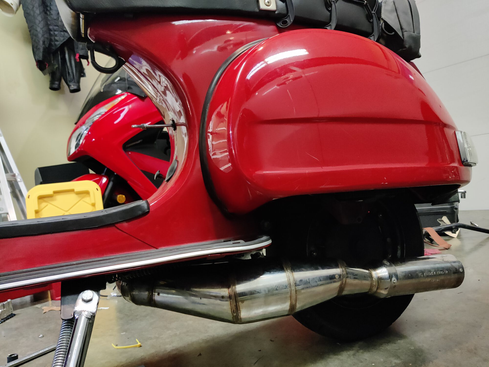

Now for the good stuff; I was offered a SIP Performance 1.0 expansion chamber (the JL designed one with the welded silencer) for a great price, as well as a MRP 30mm intake + PHBH28 kit! I had been holding off on going to a SI 24 or 26 for ages now because I knew I would eventually want to do a big reed + sidedraft anyway, and now that I have it I can finally stop blabbing about the "potential" of my Stella and put the proof in the pudding, or whatever the saying is 🤣
Waiting for the last few odds and ends to ship, I put the new pipe on with the stock carb setup to give myself one last SI jetting challenge. In the process, I saw that a few site descriptions for the BGM 177 kit state that the head gasket primarily serves as a spacer for setting port timings to a reasonable spec on a 60mm crank setup, and that it is not intended to be used on a 57mm setup. This explained my inability to get a squish tighter than 1.14mm even on the thinnest base gasket. I removed the head gasket and went to the thickest base gasket I had, a 0.6mm. This resulted in no squish change; only an increase in port duration. This, combined with the new exhaust, allowed me to reach a new top speed of 73mph GPS! Very happy with that result on a SI20 with no venturi, and a case with no port work at all!

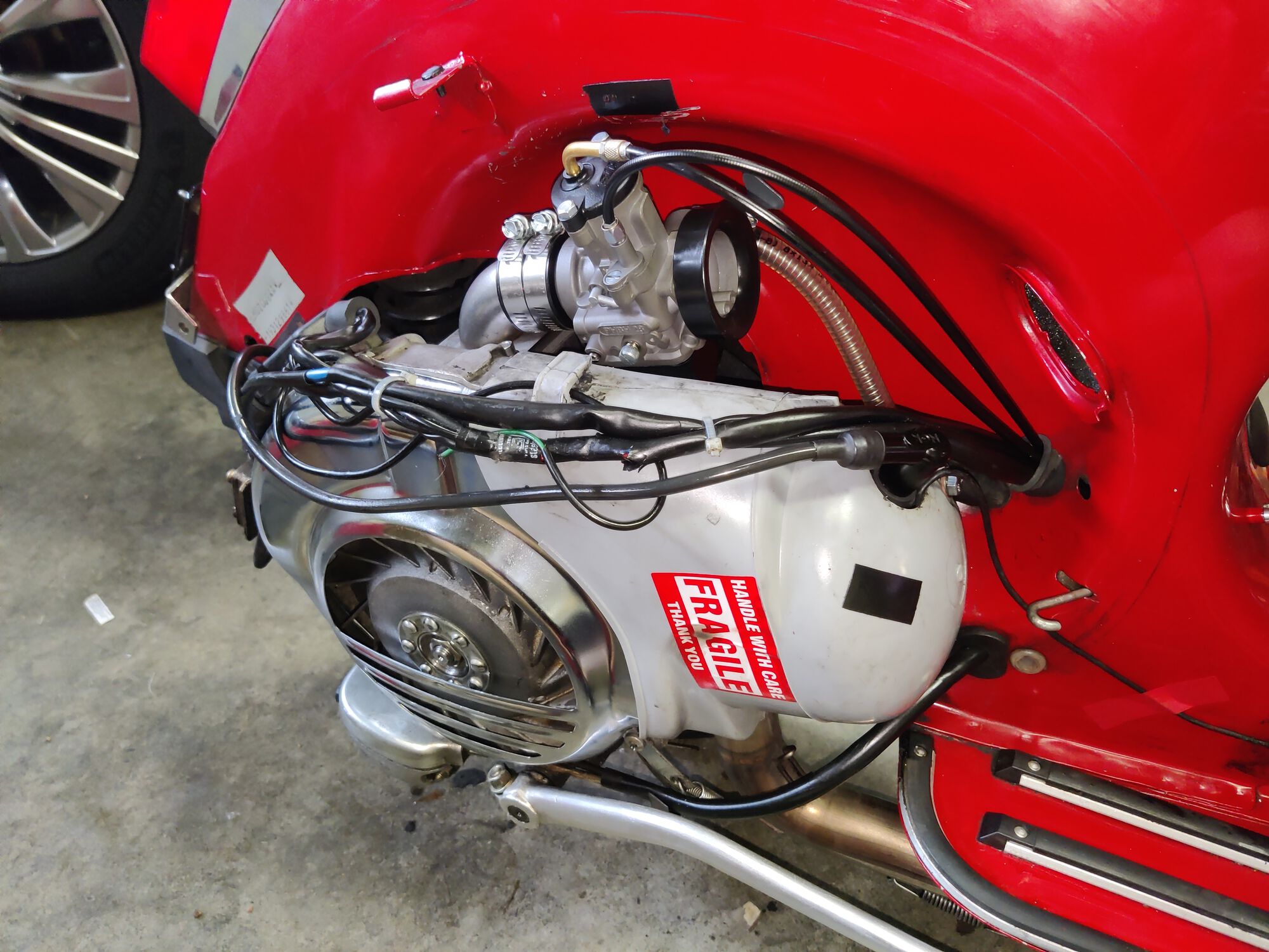

Once all my parts arrived, I took off the stock intake and removed the reed block studs. I tapped the threads all the way down into the holes as the MRP manifold's bolts are a little longer than the LML studs. The intake went on without any issues, apart from me having to file down one edge of the reed block top to clear the fan shroud.
For cables, I used the Malossi cable kit sold on SIP. (www.sip-scootershop.com/en/product/cable-kit-carburettor-phb-malossi-22-5781-for-vespa-125-200-px-lusso-t5-rally_94110000). The throttle cable works great, although I am considering a larger throttle cam to quicken up the action a bit.

It is hard to see but I am using the MRP Rd350 reed block with cheapo reeds and a stuffer. No i have not measured my port timings but I printed and laminated a degree wheel for when I get around to it.

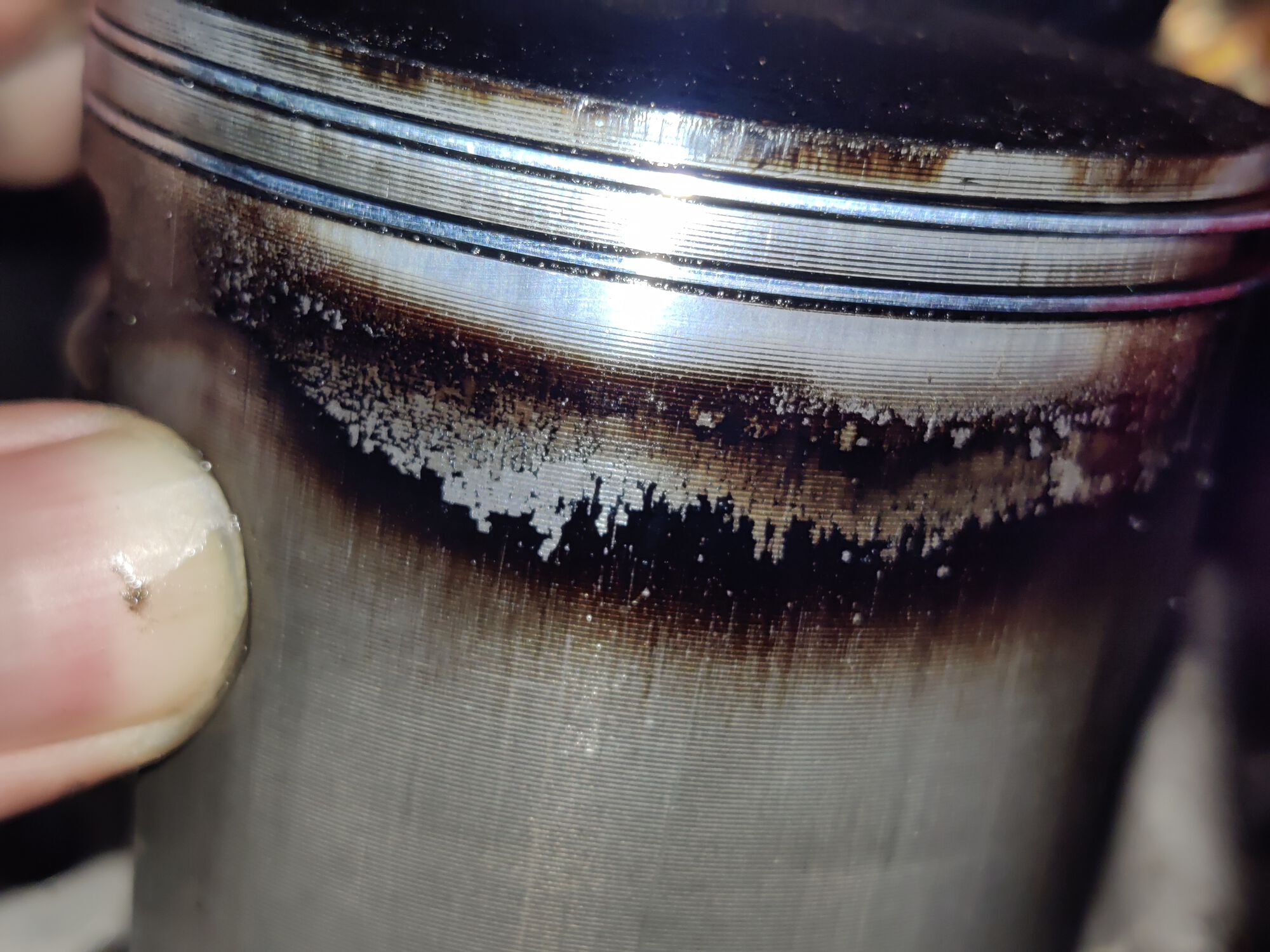

Small update: I have been wrapped up with some other projects so the Stella has been coming along slowly. I pulled the top end off for some more inspection and it seems to have almost seized at some point. The piston material under the bottom ring at the exhaust port is completely smooth, no texture like the rest of the piston sides. I was told this means it expanded enough to rub on the bore but was not enough to seize, and my quick reaction and good quality oil saved me.

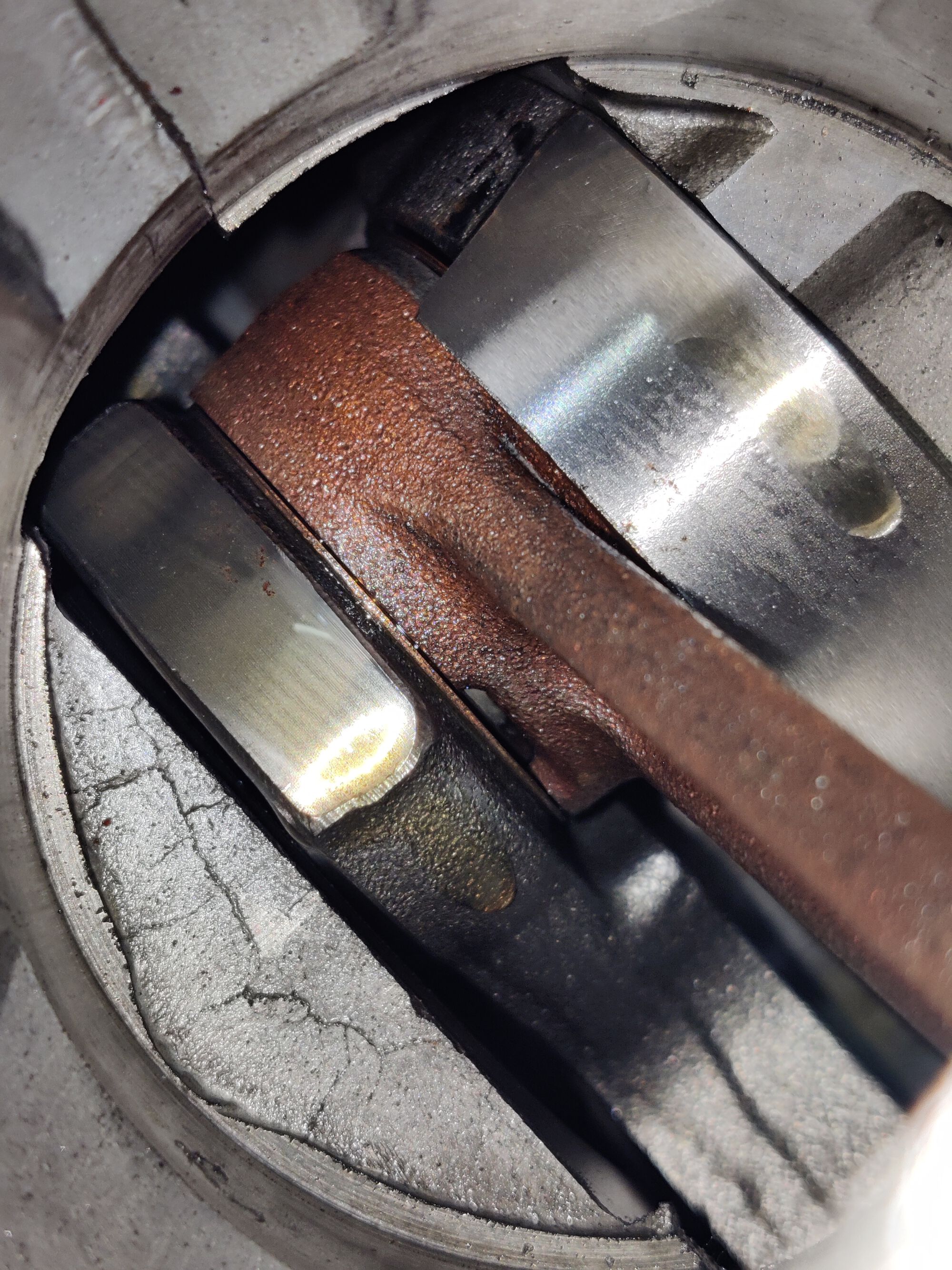

I have almost all the parts for my leakdown tester; everything except the cap and air inlet for the intake manifold. However when I went back out to pull the piston off to soak it in acetone to decarbonize it, when I turned the crank I noticed the parts that were sitting at the bottom of the crankcase were dripping with gear oil... I want to do a leakdown test anyway but I am pretty sure its teardown time. But if this is a standard "gearbox oil sucker" situation why is this the first real evidence of that? Could I have cracked the case at the cush drive spot with a missed shift? (I boogered a 1-2 shift pretty badly on one of the first rips with this setup)
