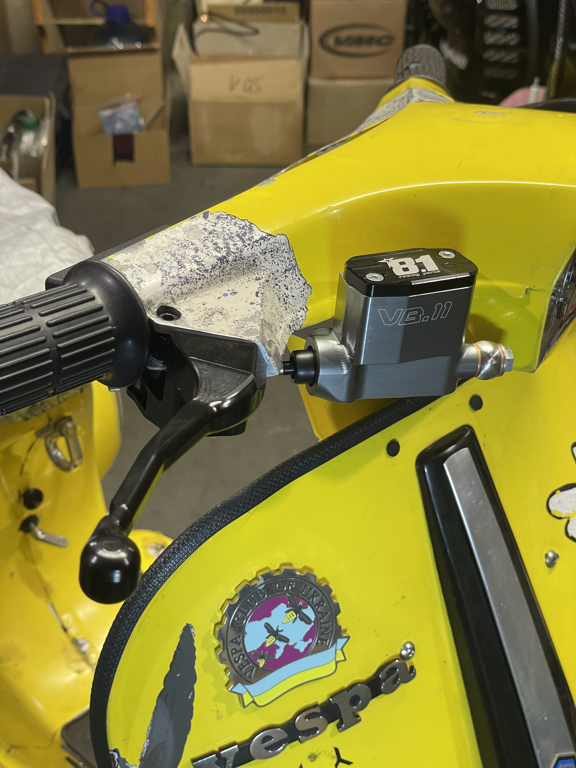

Hub and carrier from a Stella with a remote master cylinder.
Don't forget to get the shock adaptor also... its only a few dollars but makes sure that all things line up

This is what I am describing for the front shocker mount
https://ebay.us/m/XH0rop
I see from your profile that your on a different continent to myself, so I can't recommend a place to buy the components to do the conversion locally. Fitting a disc setup is as simple as removing the existing components and placing the new hub and carrier to the fork.
Someone more local to you on the forum may comment with a decent local supplier.
Had you been in the UK I could have provided you with a disc setup.

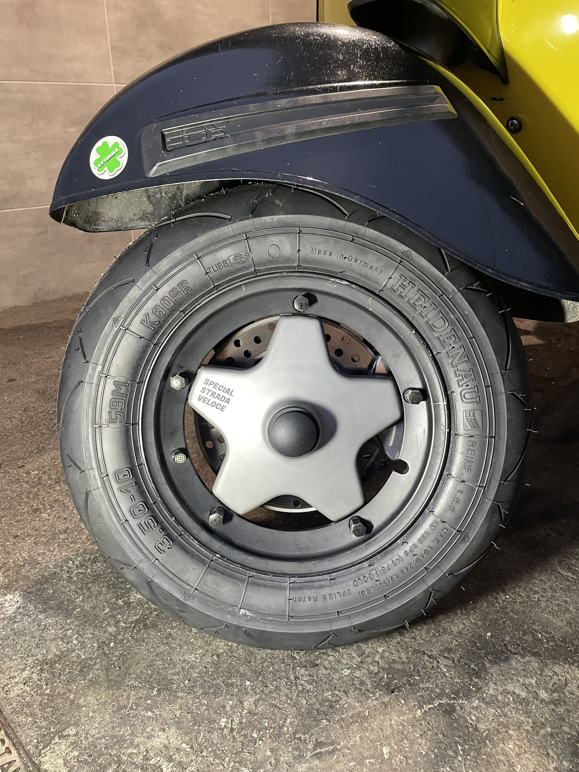

FYI, you can't mix n' match the caliper carriers and the hubs between LML and Grimeca.
PK125 XL disc brake and LED headlight conversion
