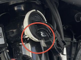

There are two distinct parts, and it's the key switch insert that is loose. I'm not sure by looking at the pics how'd you'd tighen it up, if I can get at it.
If anyone has any experience, I'd love to hear from you.

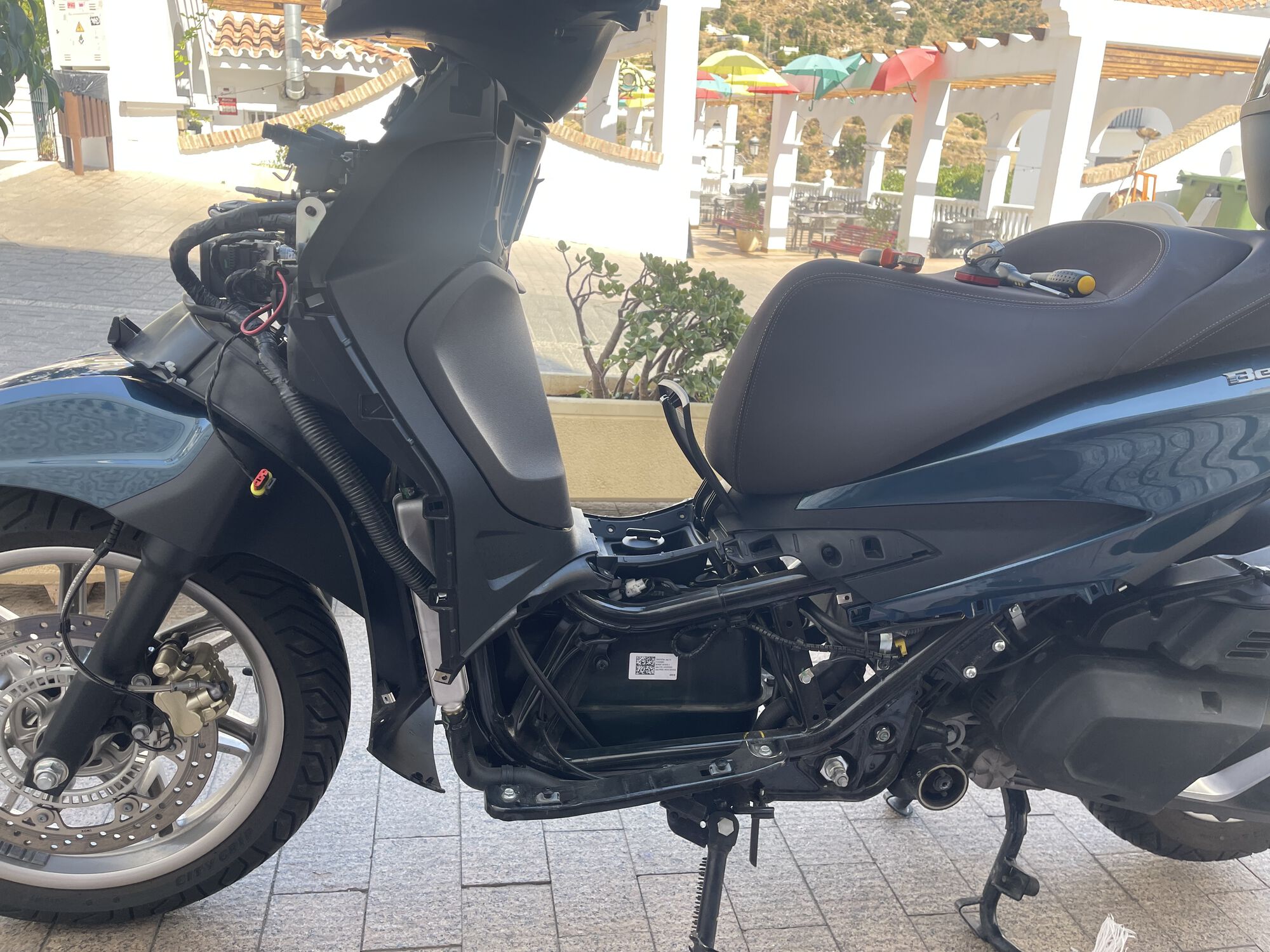

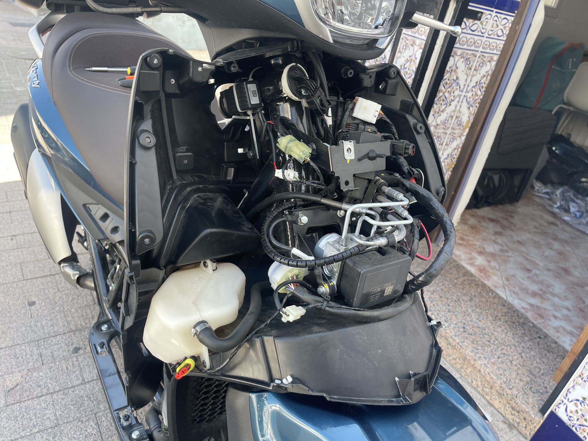

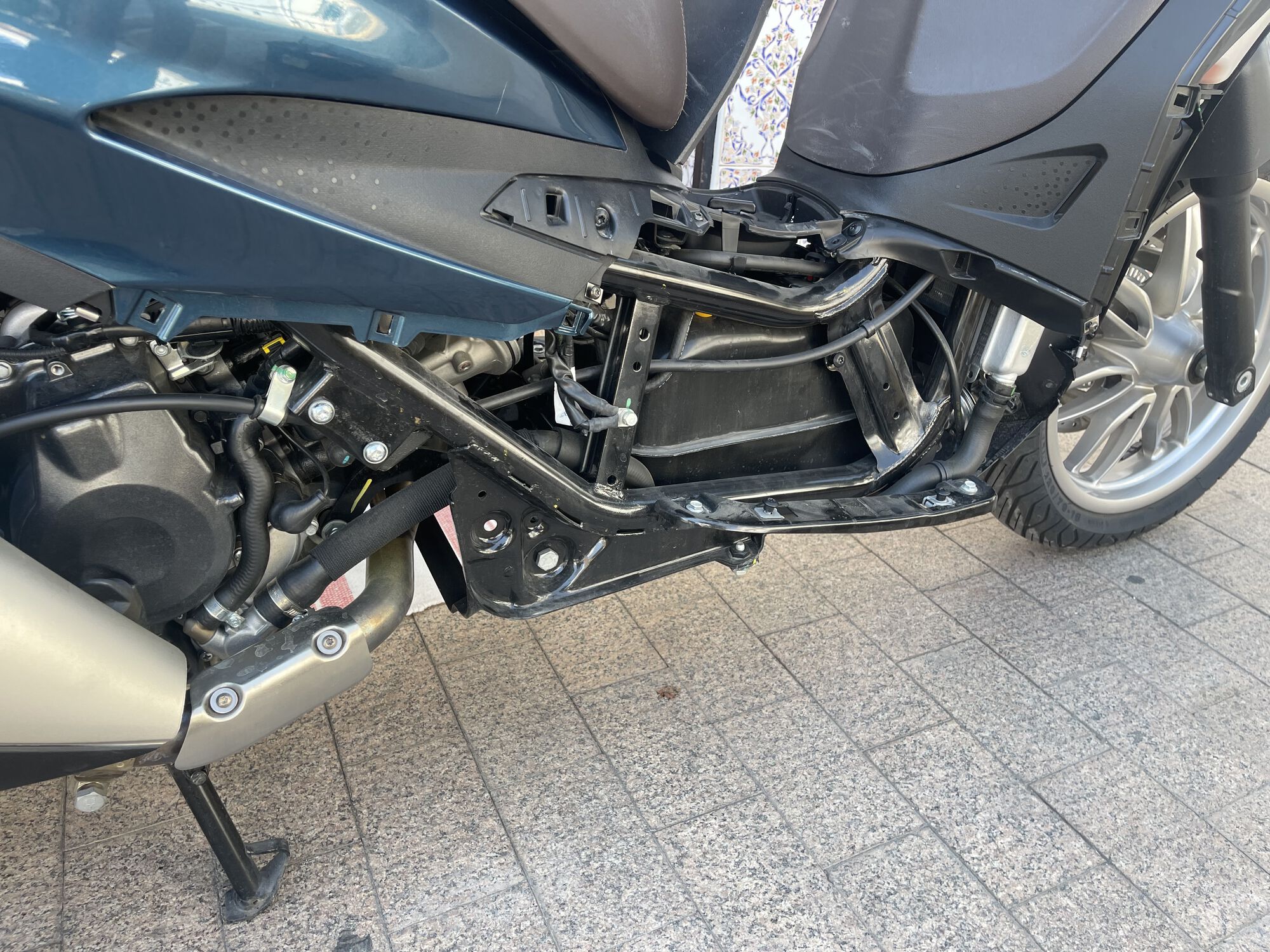

Just thought I'd update this.
After nearly three weeks I've learnt something new about Spain: warranties are not worth a damn!
The garage took the bike in, had it for over a week but did nothing. In the end I took it back as they made it very clear it was very low down their priority list. They maybe might be able to look at it at the end of Sept!
No amount of of pointing out my legal rights made any difference. The threat to return the bike to the dealer and start legal proceedings for a refund were met with that classic Spanish shoulder shrug!
So I'm back to square one and figured I've no choice but to dive in!

Hi, I am presenting the exact same problem, already took all the screws out ( different sizes, different threats, different heads haha).
So, by placing the straps can fix the cutting out problem, but then you will not be able to access the refrigerant reservoir easy ? Is that right pal? . I want to be sure to have the right solution before placing All the things back
Thank you very much

You just need a new ignition switch - 643132 (ex 582951). They do fail, but are cheap enough to keep a spare.
@safis avatar
Posts: 5493
@safis avatar
Posts: 5493
Seeing the pics, it's definitely the switch that has failed. Correct part code is: 1D002851, different plug on newer models…
