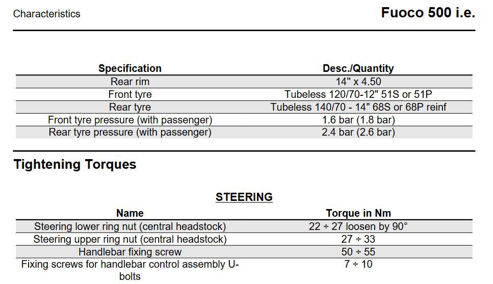

Forget to ask, does anyone know the torque specs for the center headstock?

Maybe this
https://manuals.wotmeworry.org.uk/Piaggio/Piaggio%20MP3/Useful%20Info/Steering%20Bearing%20Adjustment%202010.pdf
From the workshop manual, 50 to 55Nm.
https://manuals.wotmeworry.org.uk/Piaggio/Piaggio%20MP3/MP3%20500/
