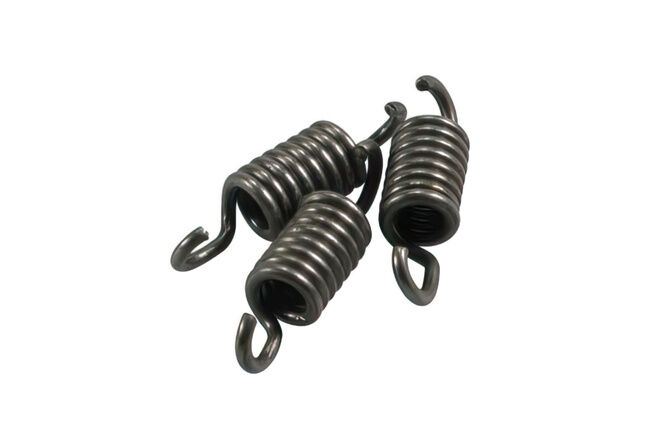

It looks like the clutch does not fully release. Check the springs of the clutch shoes or replace the clutch.

I was talking about the clutch shoes springs not the variator abjuster spring.

So if I change to the torque spring (the big one) to the MALOSSI white one might be that I need to change the 3 shoe springs to the white malossi as well or it's not related?

Leave the big white spring on . The malossi variator works better with it. Τhere is no need to put malossi shoe springs when using the big white spring. Dismandle the clutch and check the shoe springs or replace the clutch.
