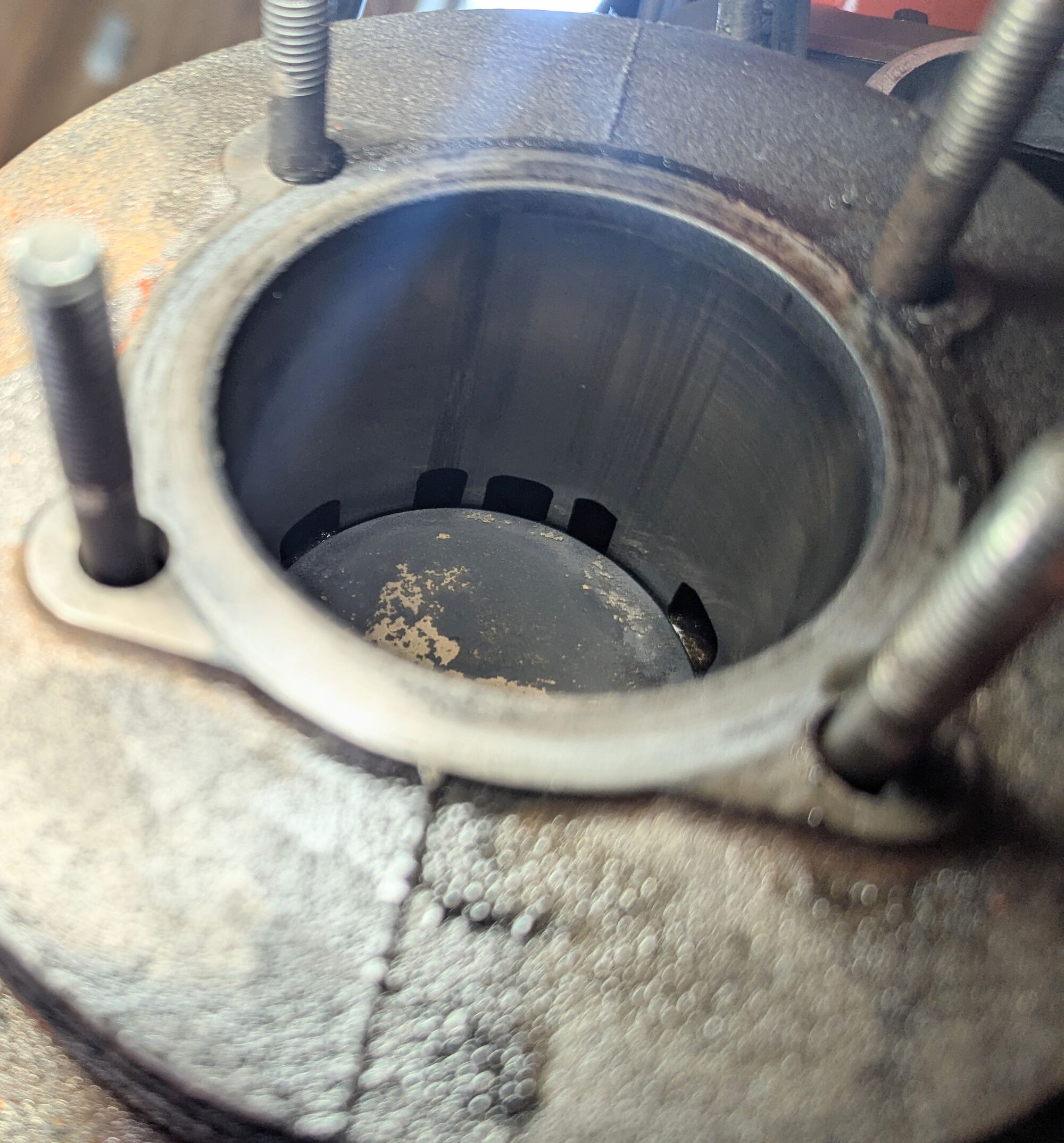

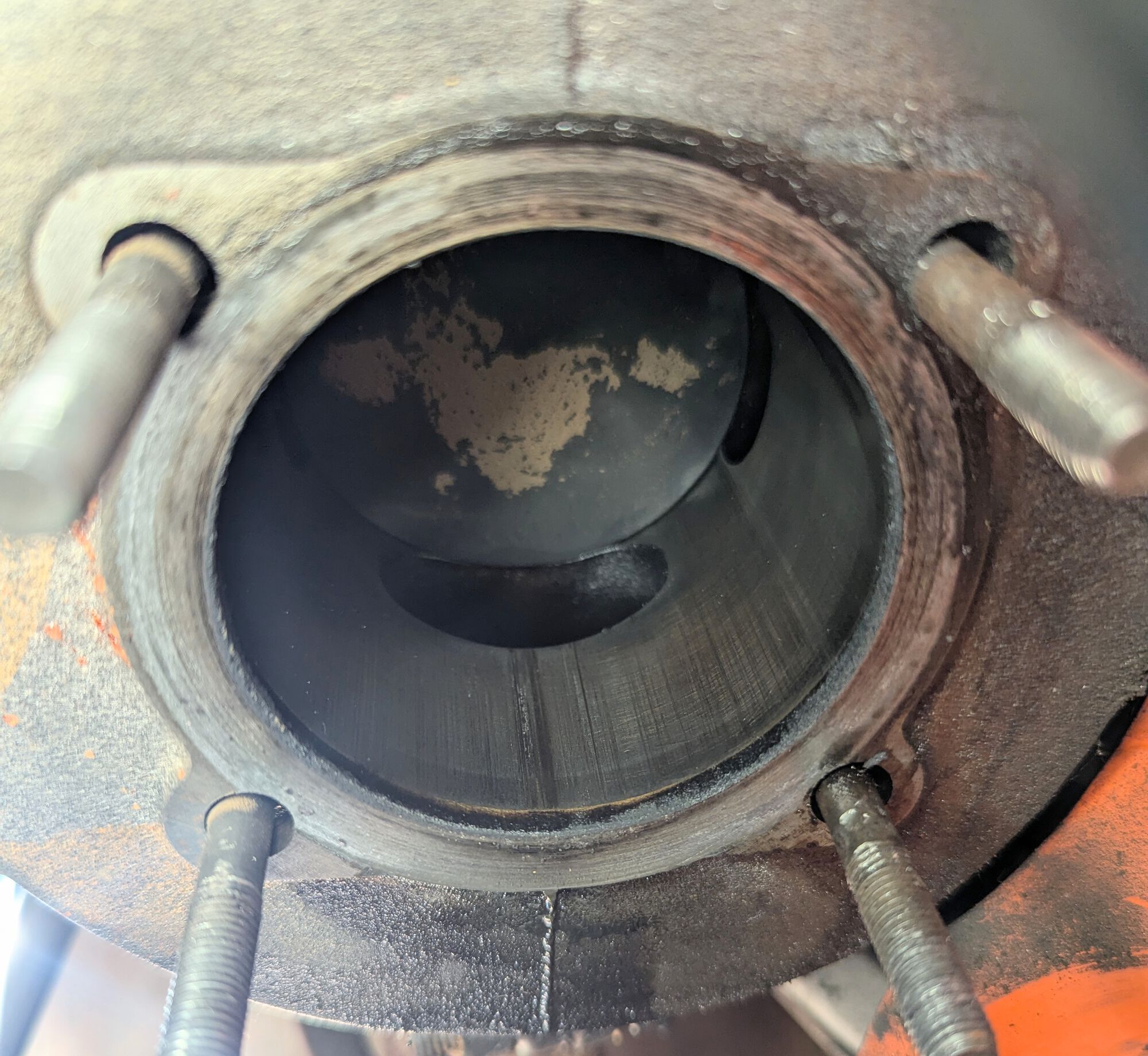

Popped the head off for a look. What do you think? I can't feel the marks on the exhaust side of the cylinder but I can feel one on the intake side. Doesn't seem great to me, but would love to hear what others think.

The jetting is close to where it should be in my experience with the same set-up. The cylinder looks totally fine. I had numerous soft seizes on my polini 177 kit back in the day and it continued to run fine despite more serious scuffing. I'm not sure you actually soft-seized. These engines can take abuse, until they can't.

That cylinder Does not look copacetic. Will it work? Maybe. I'd want to know how the piston and rings are faring.

In other words, pull the cylinder to inspect the piston and rings?

Depends on what you want out of it. Looks like the head was leaking not good. Jetting may need some adjustment generally a 160 air corrector on the main jet stack is no bueno for kitted engines but could be more than that. Once you have grooved the cylinder it will continue to be prone to seizures. The rings might not be working correctly either. You could probably bolt a go but the outcome will not be good.

Hibbert, thanks for that bit of wisdom. I would ideally like for this scoot to be a reliable weekend fun ride. I recently had to move out of my workshop and my VW had to go to storage but the P fits in the shed here at the house.
Regarding the air corrector, are you saying a 140 would be more appropriate? As to the head...is that simply a flatness issue? Or something more?
I live in a very hilly city and would hate to be pushing this thing anywhere unexpectedly. I guess the big question is, does fixing it mean a new 177cc kit or more than that? I don't mind fixing things, but I just don't know that much about these machines.
My buddy's Jeep Cherokee with a 4.0L inline 6 cylinder that 2 cylinders that look worse than that runs great, stays at perfect temp, and gets road tripped somewhat regularly. Having seen that motor, I could see how this could be ok...but I also understand they are different animals.

Heat is the enemy here. Hard to say if it's just the head leak or possibly other factors. The head needs to be flat they can warp potentially if not torqued properly it's common to true them on a precision flat with Emory paper.

There's nothing wrong with that cylinder. I'd hone it and run it. It's got thousands of miles of life left in it.
The piston probably has some scuffs and scoring. Those can be cleaned up too.
Swapping your 160 air corrector for a 140 will reduce the volume of air fed into the mixture,
which will result in your engine running a bit richer and cooler at speed. You'll most likely need a smaller main jet so get a pack of jets that covers a range of different sizes from 115-125. Finding the one that runs best is largely a process of trial and elimination.
The head isn't a big deal. Looks to me like it just wasn't torqued down enough. The mating surface can be sanded flat on a plate of glass or a countertop.
Also make sure you're using the right plug. Polini takes a short reach - NGK B7HS or equivalent.
Some folks will tell you to just buy a new top, buy a new carb, replace everything, blah blah. Don't listen to that. You'll never learn anything about these engines if you just slap parts on.
