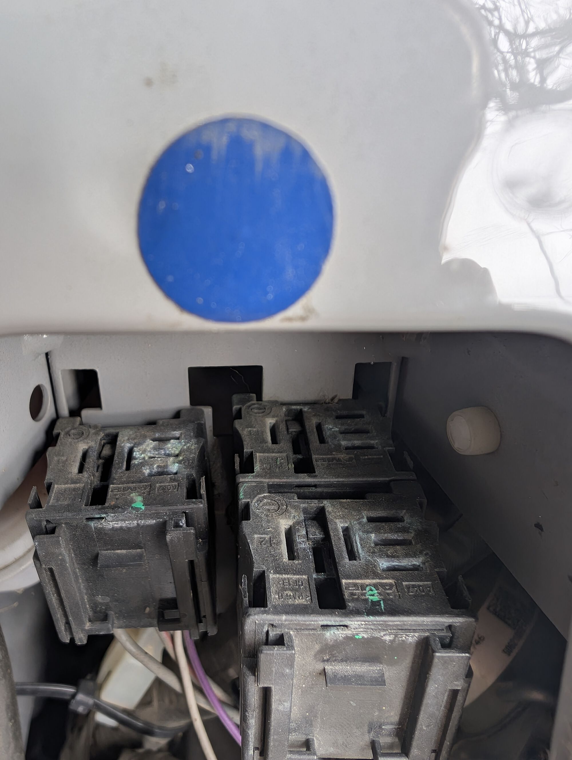

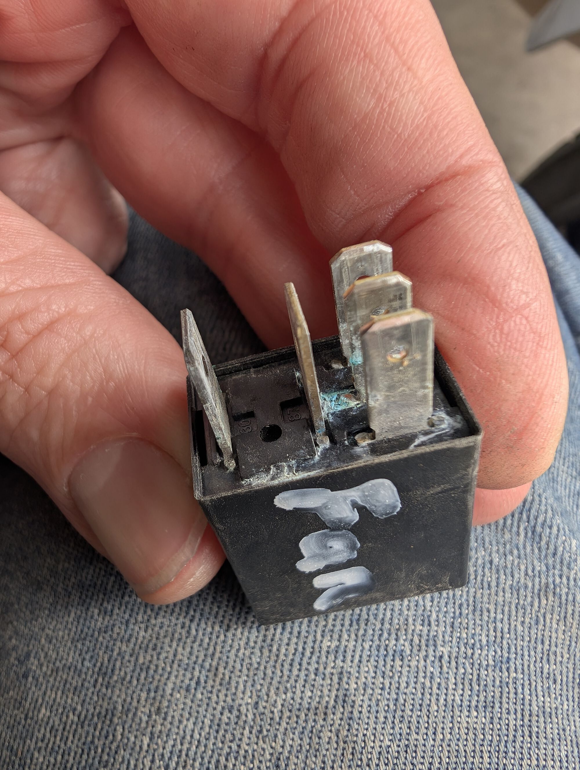

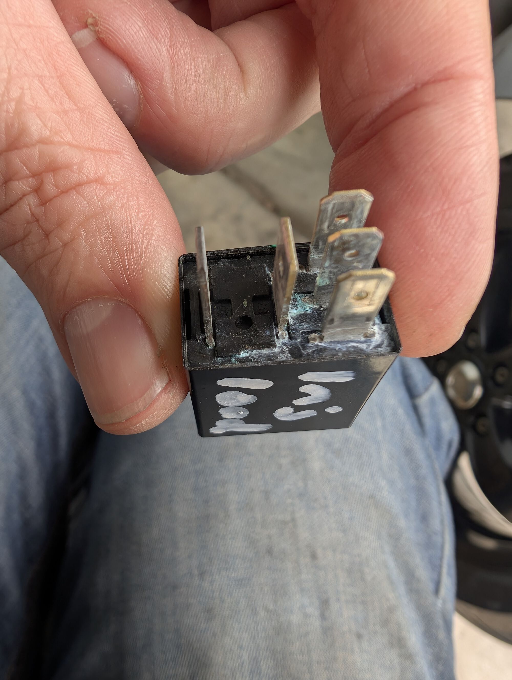

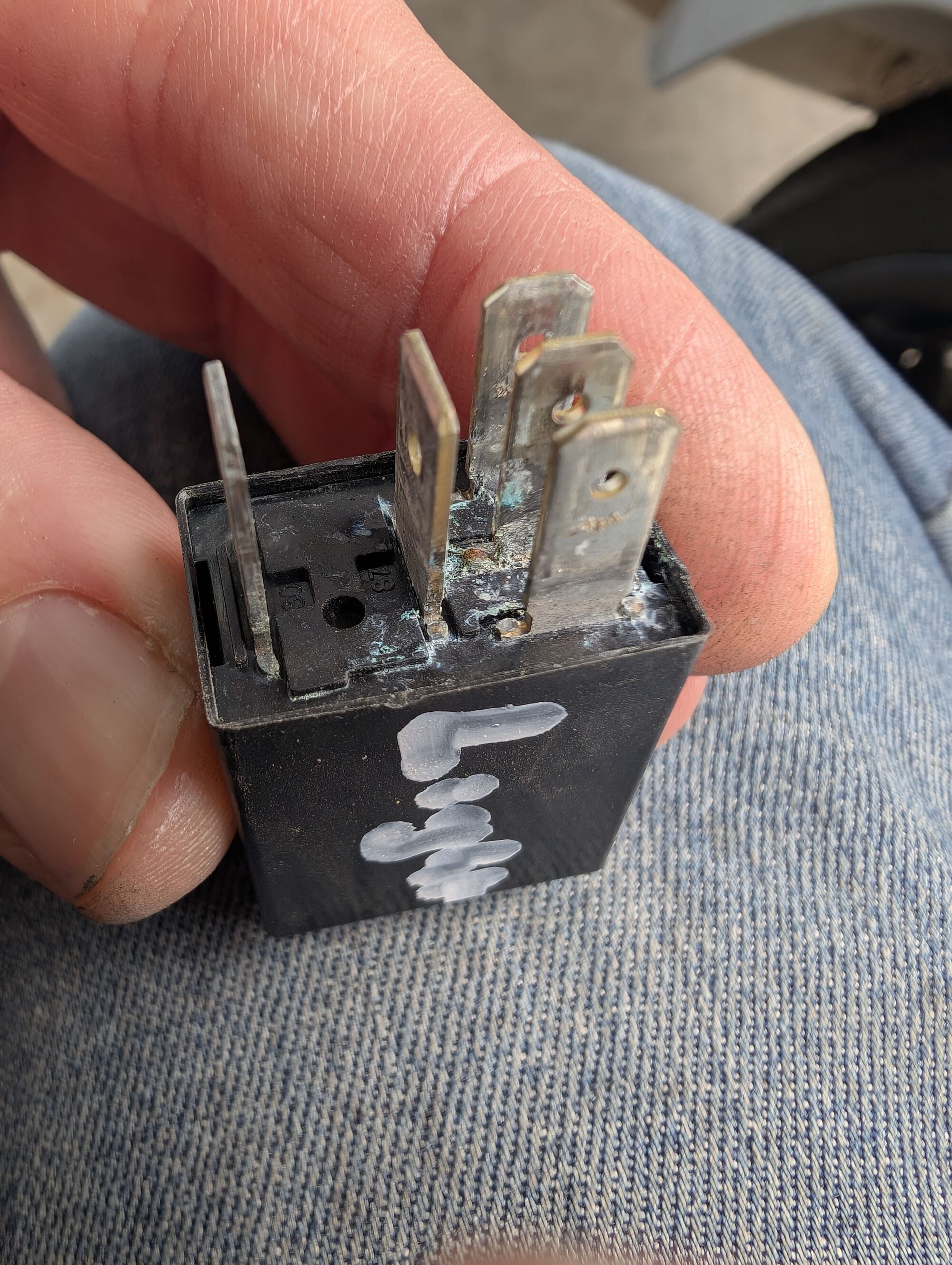

all three were sticking up by about 2-3mms
notes for 2019gts300hpesupertech:
inj loads: Black/Purple (NeVi): left front
fan: Blue/Yellow (BlGi): left rear
headlight: Grey/Red (GiRs): right rear
Gts
