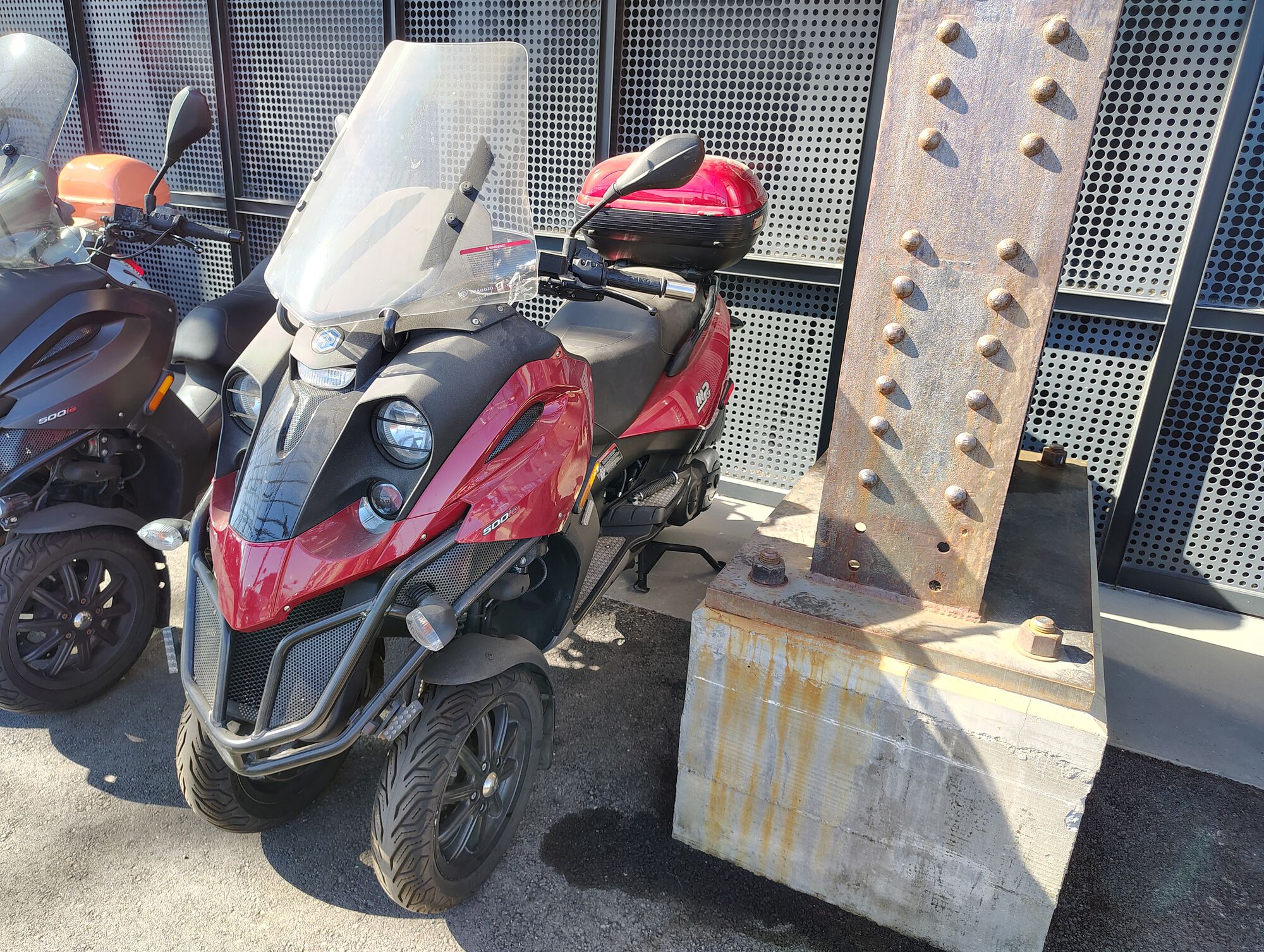

Hello all. I'm new here and just bought a 2008 MP3 500 in non-running condition. Appearance wise, it looks great, but the engine won't run and the front tilt mech. won't lock. But that's an entirely different kettle of fish to fry.
Anyway, the rear shocks are looking pretty well worn out and I wanted to lower the scoot anyway since I'm kinda short. I was looking around this forum for ideas. I ran across the Hagon shock thread, but it turns out Hagon USA no longer exists. Looks like there are other vendors in the US that handle Hagon so I may look into them, but in the meantime, I ran into this on Ebay:
https://www.ebay.com/itm/365805840587?_trkparms=amclksrc%3DITM%26aid%3D1110006%26algo%3DHOMESPLICE.SIM%26ao%3D1%26asc%3D20231107084023%26meid%3D6cbbfdb57d2a4a159d8c4c9e68bee25b%26pid%3D101875%26rk%3D2%26rkt%3D4%26sd%3D255902822938%26itm%3D365805840587%26pmt%3D1%26noa%3D0%26pg%3D2332490%26algv%3DSimVIDwebV3WithCPCExpansionEmbeddingSearchQuerySemanticBroadMatchSingularityRecallReplaceKnnV4WithVectorDbNsOptHotPlRecallCIICentroidCoviewCPCAuto&_trksid=p2332490.c101875.m1851&itmprp=cksum%3A3658058405876cbbfdb57d2a4a159d8c4c9e68bee25b%7Cenc%3AAQAKAAABgG96wQ16jds4VFcrhy1F3d4mbwZUJI9Fs%252BgdXYAHIzlX2e3YaNh7x%252BEnKA3G%252BCqSl1Xn4McfcWFK1GytmS2qxJ87mtE8Gm3iR1Ja4WBwh0hNHJrJx3Ki5mp04ow4CO7lP%252BooCybZDDU%252BbbSwmg7CbTin%252BBzBzbCYVnbjvyQAHu6--HI4MB7SvJl5IJqlyvomgoLMlgT6qAJzX0SANJhty2eBcwCiWaCz7OwzPLgMrDb51XIQL%252FJGKf6ddDde%252FWbo4ZoJghS5qqAvbLyAO0IJr1DfRddzvGW0AuKUOuvf3ippCcMs0u5DmZmfA%252BQBjpZvSKh19YlKh0jwUA9w%252Fifc0bhk%252BkJ%252BZecuFj6k7pPBoZ9N4CUXRZiNH8Sz75xgcC1jJmRFOXwVR6gTlYmQ%252F2Dm%252FkfigsveD5%252FaIrvBaEkNkkuJ%252FboUySgfbqO4lVb5Xs94GEc95cUCQrW7MmDuQYLW7%252FKF0hw2zS4cw8wc9rILNM7NaHmkdr%252FvaQg1FLg0tA0VxA%253D%253D%7Campid%3APL_CLK%7Cclp%3A2332490&epid=14039286165&itmmeta=01K49N96A2DAG93DYJ71PPY0CA
Sorry, I don't know how to shorten the link.
Being a short rider (5'6"), these 360mm shocks look really interesting, particularly their price. Adjustable preload and dampening also. They include 10mm, 12mm, and 14mm bushings to fit different bikes. Not sure how thick their mounting eyes are though. The spring is rated for a big Kawasaki motorcycle so it should work fairly well on the heavy 500. Since the stock shocks are 410mm long, these should lower the scoot about 2", which would make life a lot easier for me.
Does anyone know if the oil/gas canister will clear everything around the upper mount?
Anyone have other suggestions for a shorter rear shock in the 360mm - 370mm range?
