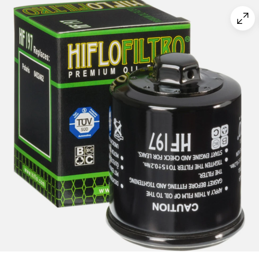

You can remove the old one with a big flat edge screwdriver, chisel or crowbar. Replace it with HF197. It uses a 17mm wrench.

hiflo 197 is the way to go. i burned my hand while trying to get the oem out. my hand is how i make money. My precious hand

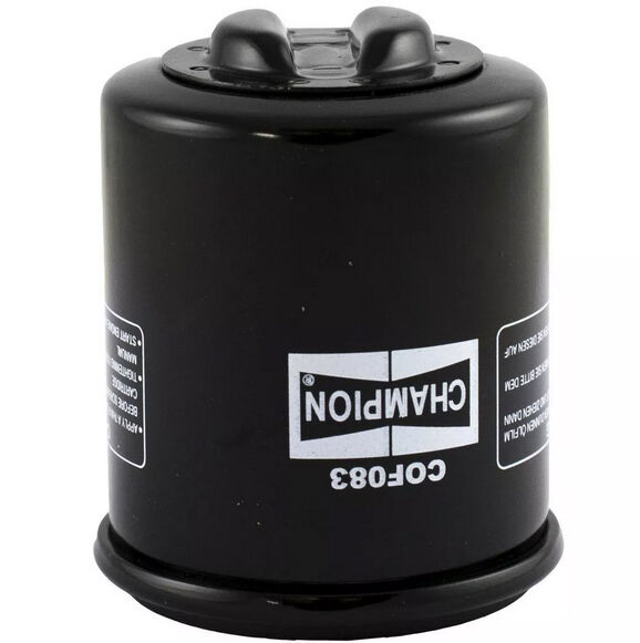

Champion also has that "big screw-driver!" tightening help on bottom.
