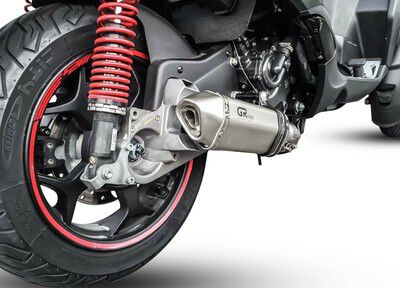

Speaking of performance parts, does anyone have experience with the GRmoto muffler?
https://www.ebay.com/itm/275531658095
It's about 7.5 kg (16.5 lbs) lighter than the factory muffler with a removable baffle. The price is not too bad compared to the likes of Leo Vince and Akrapovic.

Posts: 1670
You're not likely to gain much power if anything from a exhaust. The biggest benefit is lighter weight vs the stock muffler and a slightly better soundtrack.
The current mp3 comes in at around 280kg and costs 15,5K Euro. That is about 50kg more than a similar maxi scoot with similar power output (Yamaha T-Max)

I'm just going by what the representative for GRmoto told me, a 2 kw gain in power.

The 2008 MP3 in the US was actually a Fuoco elsewhere in the world, hence the lower weight factor vs genuine mp3 models
I'd take the power gains&claims with a huge grain of salt.
I got less than 1hp with my Akrapovic, and put the silencer back in to minimize torque loss.

I put a Leo Vince Nero Slip-On Muffler on My 2016 Mp3 500ie Sport. Its pretty similar specs to the other after market exhausts.
As expected, it did not make much difference on power or performance. What it did do was drop weight which combined with other mods to drop weight.

* Leo Vince Nero Slip-On muffler dropped 15 pounds

I hear you pinheadh78. My goal is to reduce the weight of the scoot too. I'm going to get a Dominator muffler (https://www.ebay.com/itm/284178364141) because it sounds great and the price is reasonable.
