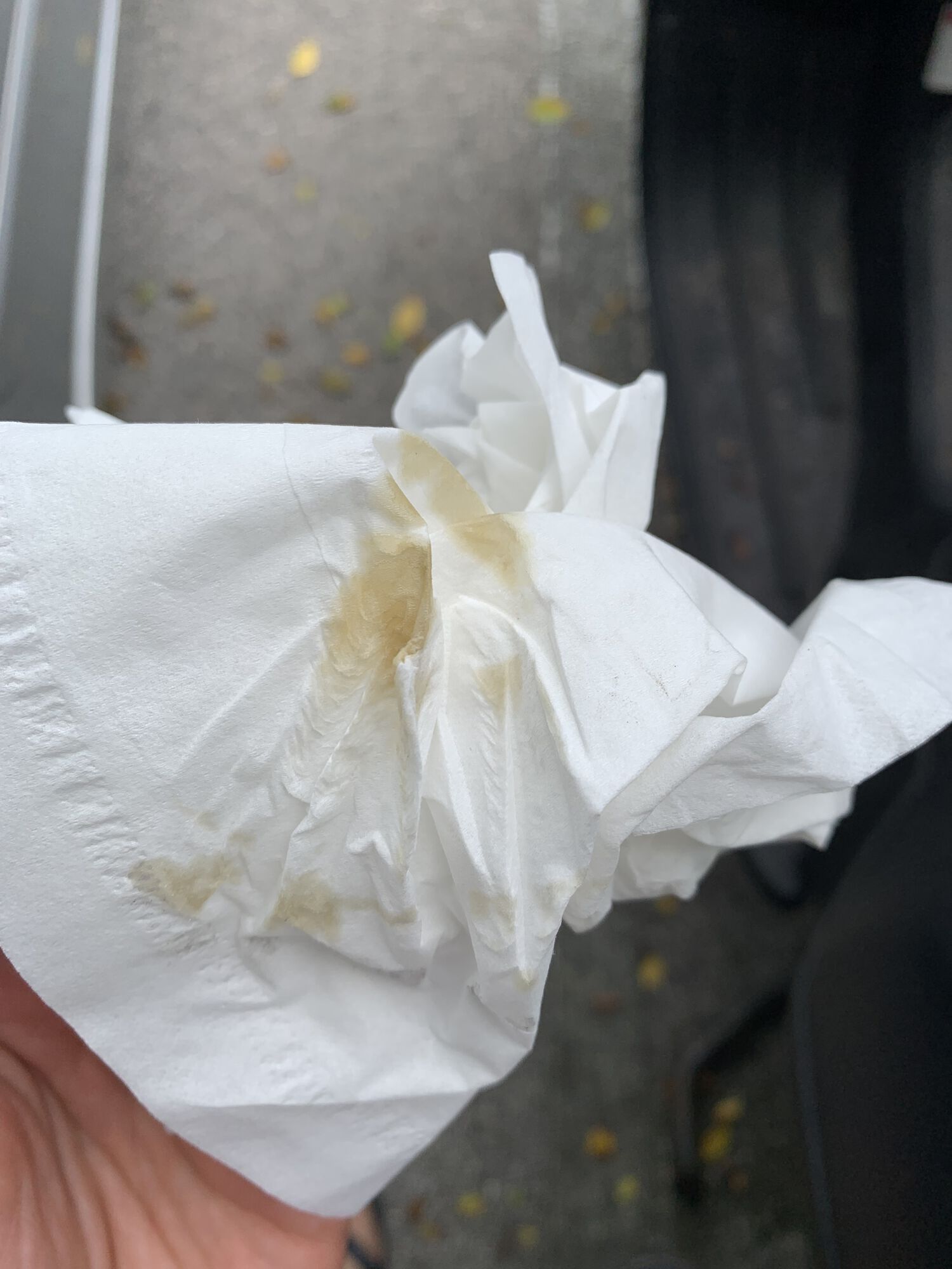

So this is the color of the oil, looks fine to me.

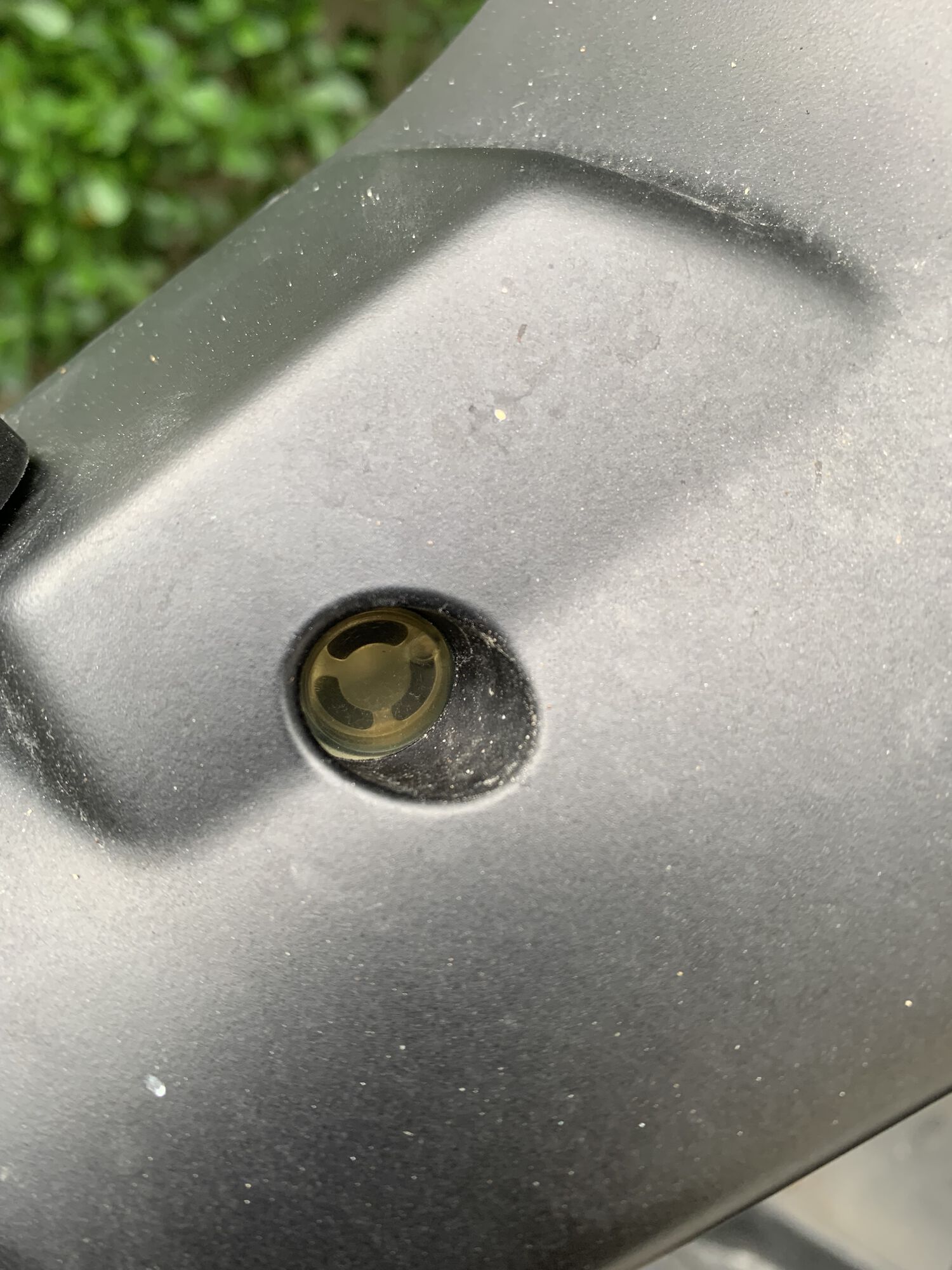

[quote="az_slynch"]
I'd suggest changing brake fluid every 2-3 years. It's hydrophyllic and moisture can get into the system. Check the reservoir sight glasses. Fresh fluid looks like champagne, perished fluid looks like Coca Cola.
Thanks for the info, looks like champagne to me, what do you think?
@az_slynch avatar
Posts: 2095
Location: Tucson, AZ
@az_slynch avatar
Posts: 2095
Still looks good to me as well.
I like the new sightglass window, but I wish they'd kept the access cover.
As for the engine oil, that is remarkably clean.

My last oil change was December 2023 and I only rode exactly 500 miles since then, Lol, I guess I'll wait it out.
different brands are different colours so just looking at the colour is not a great way to determine the health. although it does seem the older the darker and that ain't light to my eye.
