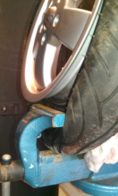

Today I have replaced the 20 year old tires on my recently purchased 2006 GTS250ie
The old tires looked fine, but fresh rubber makes so much sense.
I opted for a 110/90-12 City Grip on the front in an effort to add rideability on our mostly dirt roads. After the fight breaking the bead wihn replacing the rear tire, I told myself "there has to be a better way!"
And there IS!
The Front tire/wheel assembly was removed from the scooter, and the schrader valve core was removed.
a two foot length of 5/16-3/8" fuel line was pulled from the misc. hose bin. One end was pressed onto the valve stem, the OTHER END WAS PUT ONTO THE INLET OF MY VACCUM PUMP! It took less than 3 seconds of pump run time before the gratifying POP! was heard as the bead slipped free of the wheel groove.
What a treat!
Now I know everyone is not going to have an oil sealed rotory vaccum pump available, but I would suspect a shop vac might do the job, though adapting hose sizes would be an issue.
Any way, The new tire is on, I went for an extended ride on area dirt roads, wood land trails , and paved secondary roadways. Speeds up to 70mph indicated. The combination of the Michelin XZX 145/70R12 (car tire) and the 110/90 -12 streetsmart handles like a dream! It steers well off pave, and is very neutral in 45-50 mph paved bends and corners.
There is some tendency to "stand up" at the 10-15 mph range, but nothing to cause concern.
I'm a happy camper, and will NEVER break down a tire with presses, clamps and brute force again!
Well, at least not in my own shop.
ps, I needed a third hand to lever the first bead of the new tire onto the rim and called in my wonderful wife. And I had to use a ratchet strap to aid bead sealing during the initial air fill.
Her comment was that it is a good thing that new tires are going on now, as in a few years into the future, I won't be able to!. Growing old isn't a problem, it's the side effects!
Cheers

My bet is that vacuum will do it without issue.
I use a bench vise for the second bead. (pad the rim, squeeze the tire. Works well, but often needs three hands!

If I have it correctly, The pictures of your set up are posted "somewhere". I did enjoy your creativity!
But..
I have lacerations on both lower legs just from the irons being flipped out during the first go around. I can't imagine the cuts, bruises and scars I could sport if I tried negotiating all those other options

Yes, the vise with a pad against the metal rim for the second bead.
It works for me.
