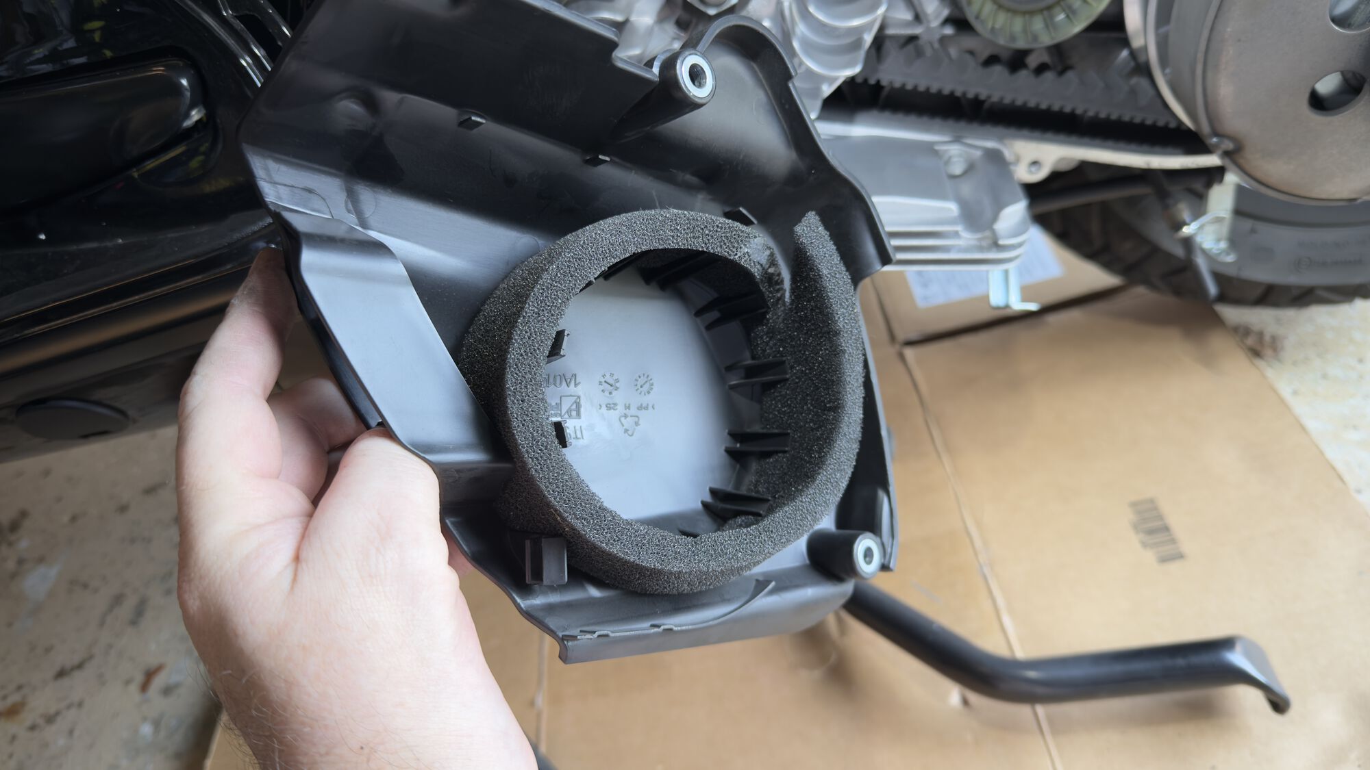

Greetings!
I performed the first service myself on my 2024 GTV and had a couple observations that I wanted to ask. Everything went fairly fine. I was able to change the oil and gear oil close to mess free with a "motorcycle oil filter funnel" I had from an old Harley I had back in the day. If you search on Amazon you'll find it too.
Questions:
1. Taking off part of the plastics on top of the belt housing, there's this foam ring that's a air filter essentially. When the housing came off, this filter was cut and kinda all mashed up on one side. I am assuming that when assembled at the factory it wasn't seated properly and somehow got cut. I plan on replacing it, but I was able to get it securely put in properly, with the cut end on the opposite end of the air intake. Is this bad or is it good for now do you think? (pic attached)

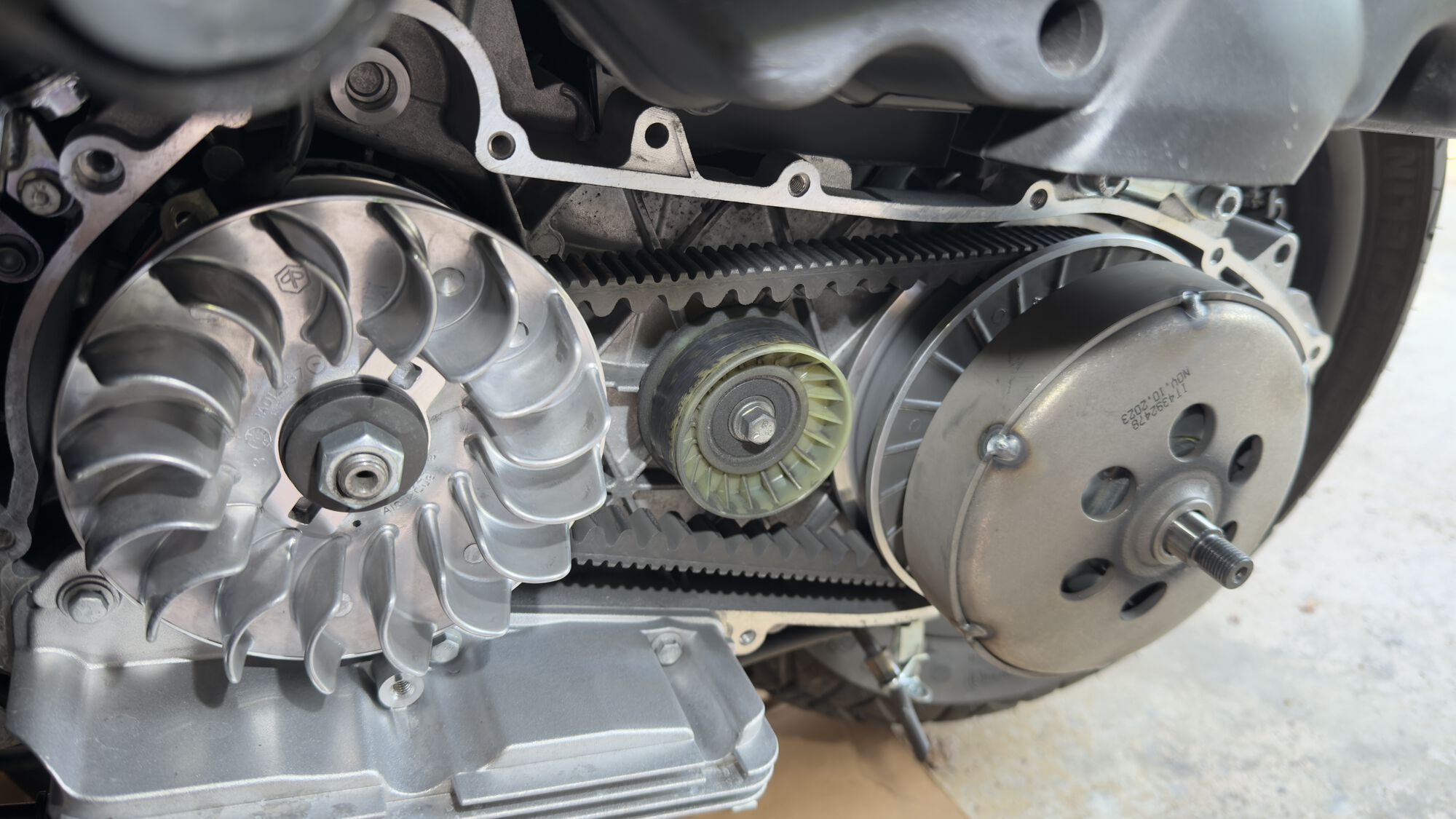

2. Once the cover of the belt and variator was off, the center pulley seemed to be pretty covered with belt rubber. Does this look normal for 625 miles? (pic attached)

Foam air filter ring
Center belt pulley
Center belt pulley

That's the transmission filter and is just a foam ring , You could probably glue the ripped ends together till you get a replacement ?
Centre pulley wheel normal as it stops the belt flapping around ,They used to be black so belt marks would not be visible.
