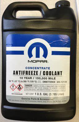

My Fiat came with pink coolant and the pink coolant I bought says for 2006 and up Fiat on the bottle. But, whatever. I'll stay with what the vehicle manufacturer says to use.

AFAIK all US spec FIAT cars came with the purple stuff, BUT they changed specs and coolant part numbers between different model years. See link
https://www.fiat500owners.com/threads/what-coolant-should-we-use.154066/
