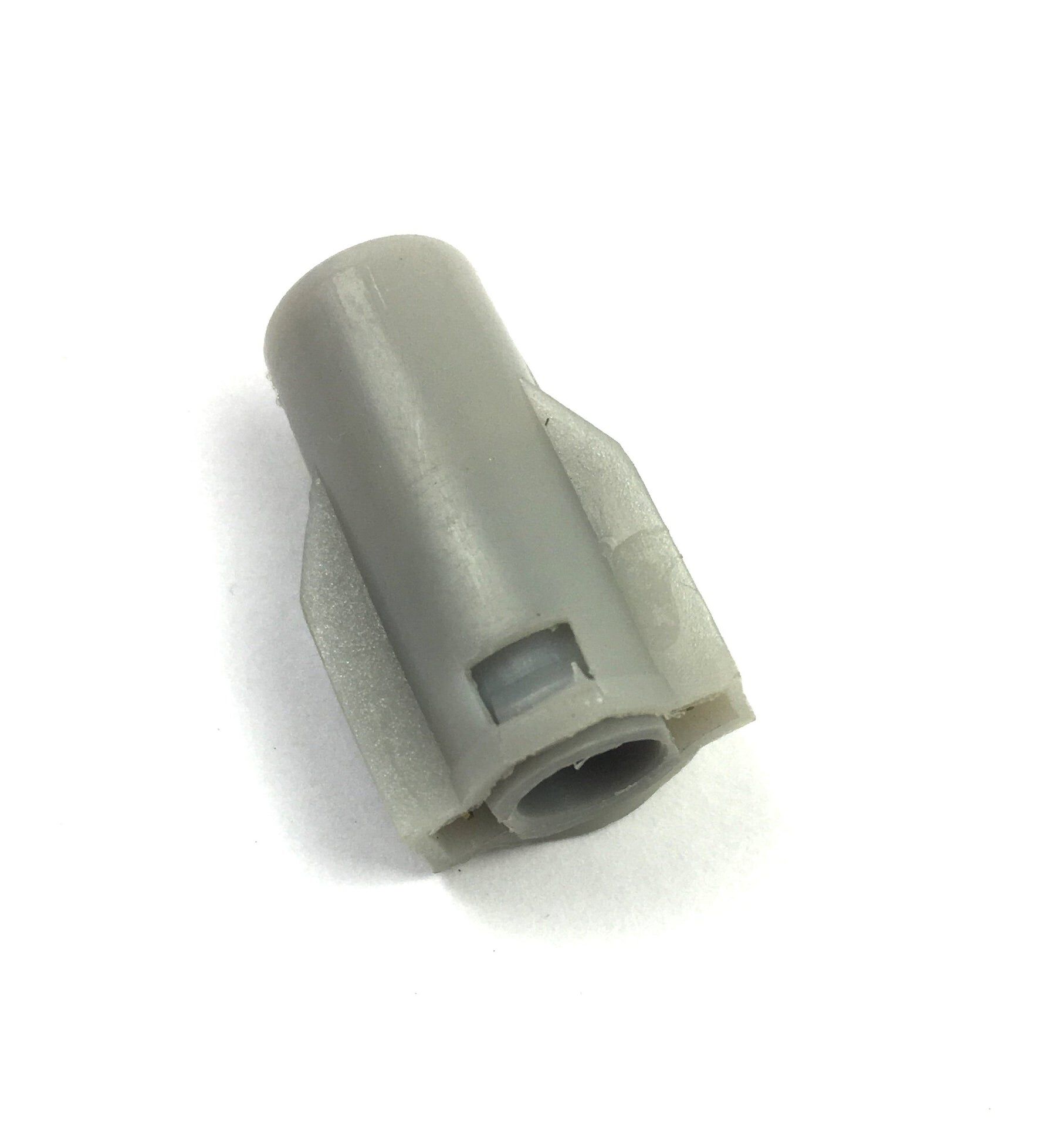

Do either of you have a photo of the front brake switch installed? I also have Grimeca front brake kit installed and I just realized that there is a brake switch just hanging out under my headset cover thanks to this thread.
It looks like a little rocket.

@jonmonts avatar
Vespa P125X
Posts: 34
Location: Greenville, SC
Yep, that is what I saw floating around under there. How does it install/work?
If you have the correct cable, it would be directly under a short outer cable piece right before it attaches to the brake lever. I don't have mine set up to show.
