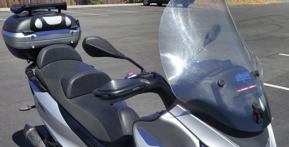

These where installed on my 2016 Mp3 500ie Sport.
https://www.amazon.com/dp/B001KODHFU This specific model "Acerbis 2140450001" may not be available anymore, but there are equivalents out there.
These are only attached at the bar-ends so can drop if subjected to sustained vibrations such as rough roads. To combat this I put a bit of soft rubber between the bar-end and the plastic then some thread locker on the screw just before tightening it. This provided enough friction force that drooping wasn't an issue.
You can see them here.

Those handguards look great, but it appears they're no longer available. I have heated grips on my MP3 so I'm a little worried about using one-sided guards. Like I mentioned, I'll probably get some cheap ones just see how they'll fit or if they'll fit at all with the heated grips.
