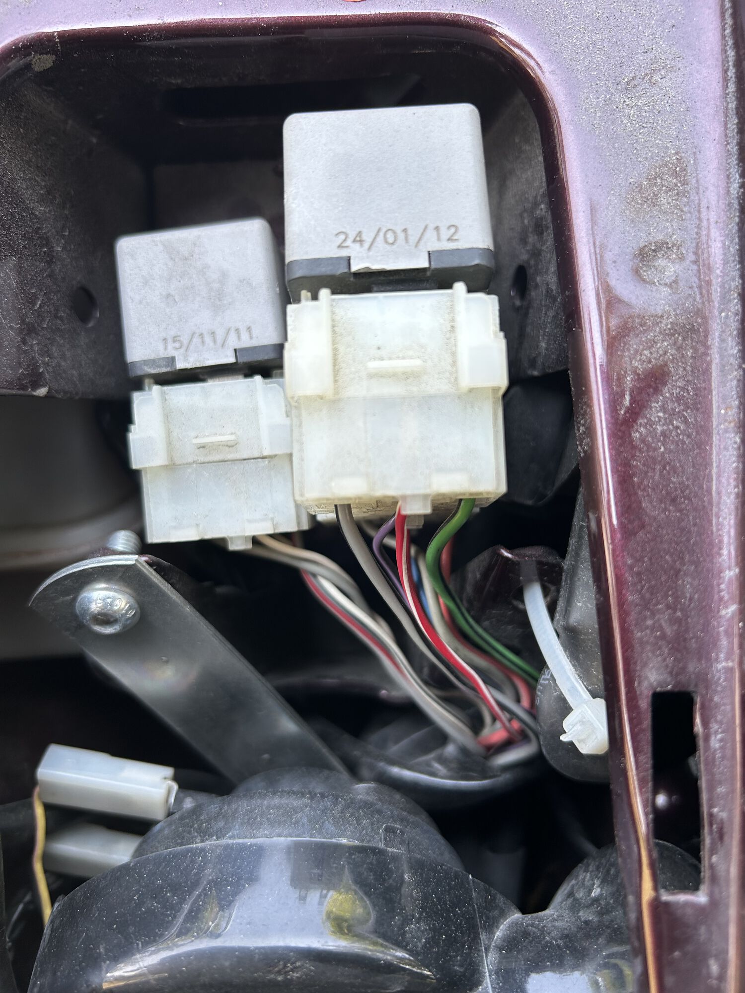

Running fine. Stopped for a couple minutes, no start
Don't hear pump prime
30A fuse good
Front relay chatters, swapped with relay behind it, still chatters
Indicator lights hit or miss, but CEL will come on momentarily then go out
Brake lights work
Battery at 12.66v
I am on vacation at campground so don't have access to my code reader or a wiring diagram
Seems like what ever pulls in relay is intermittent. I am thinking a faulty ignition switch or immobilized antenna
Ideas?
Front relay which chatters.  Shown for wire colors for a wiring diagram
Posts: 46114
Posts: 46114

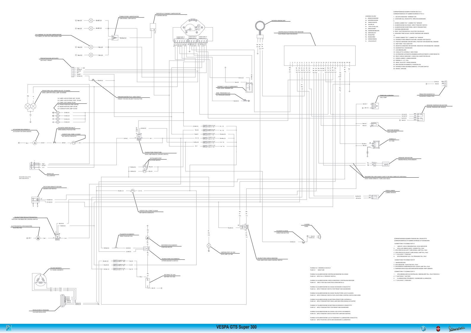

If the brake lights are AOK then the ignition switch is also OK. That relay is the headlight relay - one leg of the coil fed 12V from fuse 5, the other from the ECU. The ECU is fed its 12V via the ignition switch and then fuse 2 under the seat - that could be an intermittent contact, or the ECU connector could be making poor contact.
Good hunting!
Circuit diagram as jpg and as pdf, in the hope one of them is readable:
